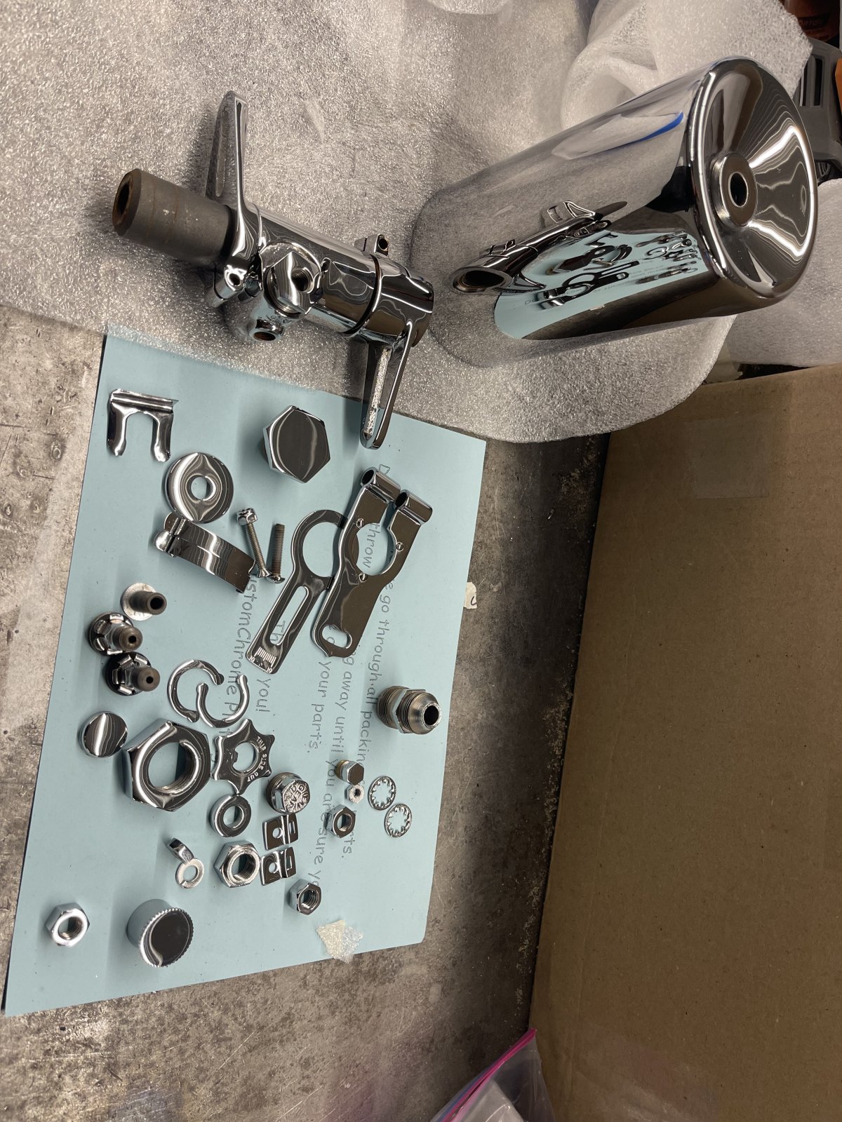

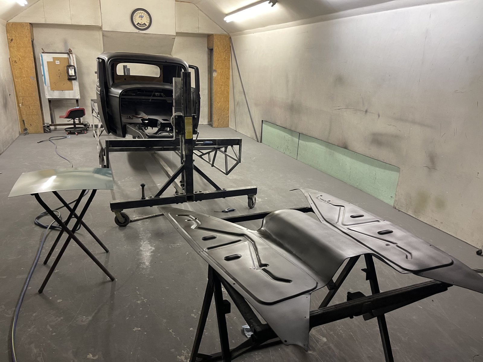

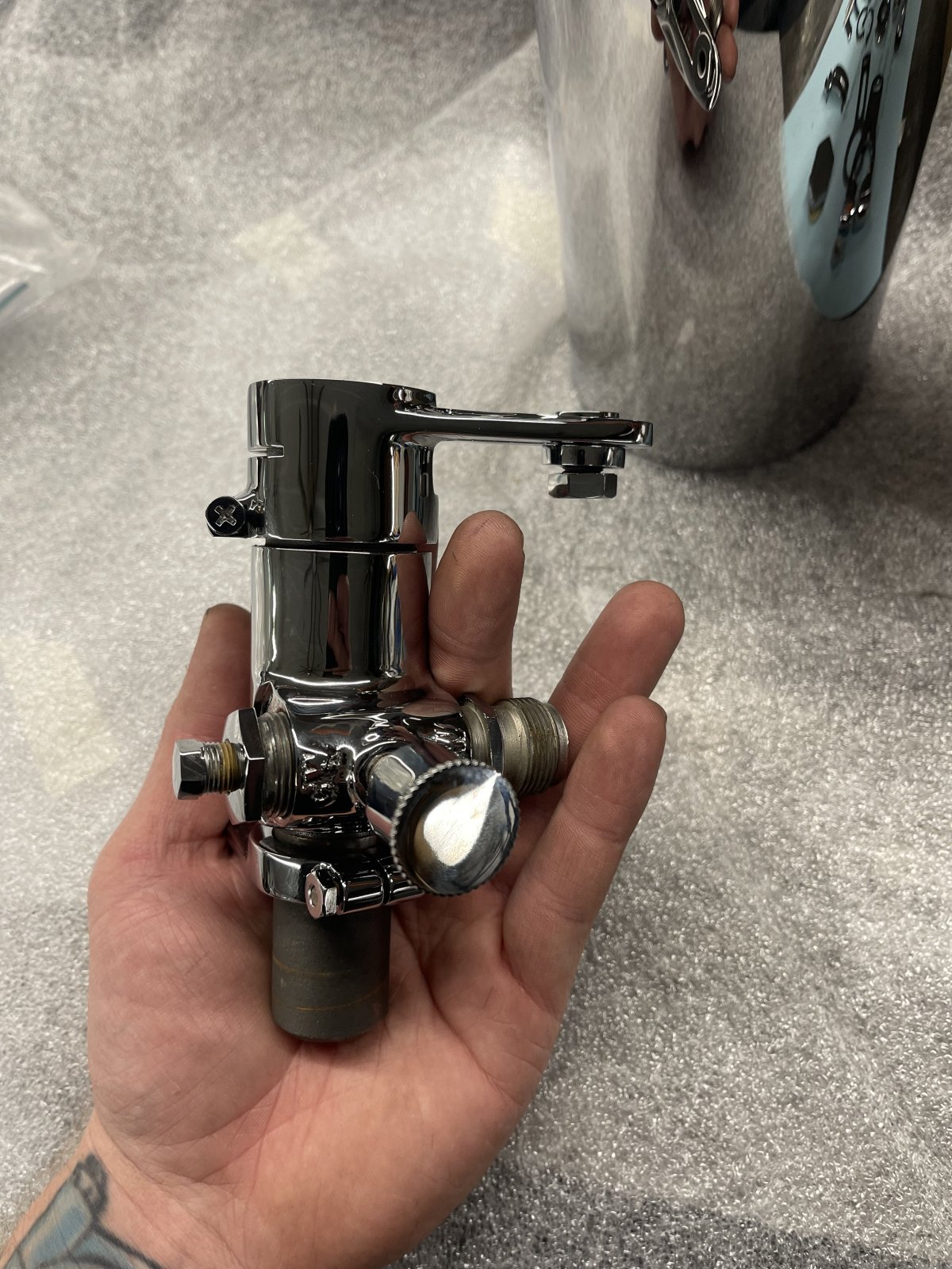

    It’s been a busy weekend. Finishing up the metalwork on the body . Sandblasting a priming . Also a very small portion of chrome parts a piece started showing up from Jon Wright Custom chrome plating . An if your wondering I’ve sent out almost 150 pieces to get chromed including the firewall .

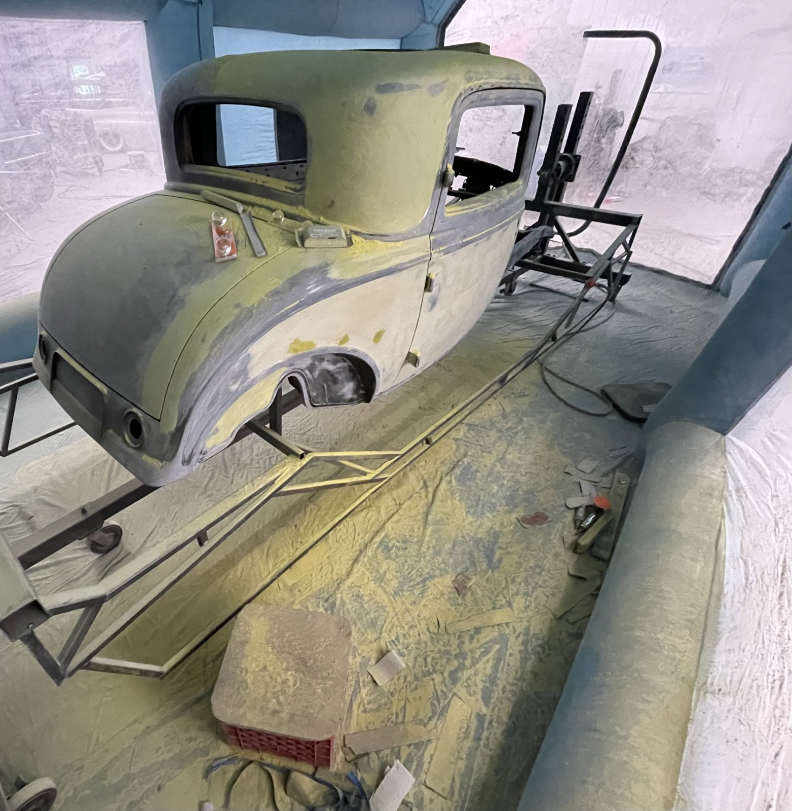

    IMG_8502.jpeg Progress . Yes it has filler in it .

    Cody, how does the inflatable spray booth work out for the bodywork ? Are you wearing a mask while in there sanding ?
  15. Cody Walls
    Joined: Nov 14, 2008
    Posts: 1,574
    Cody Walls
    It works out well . Contains about 95%of the dust inside. . yes I do .

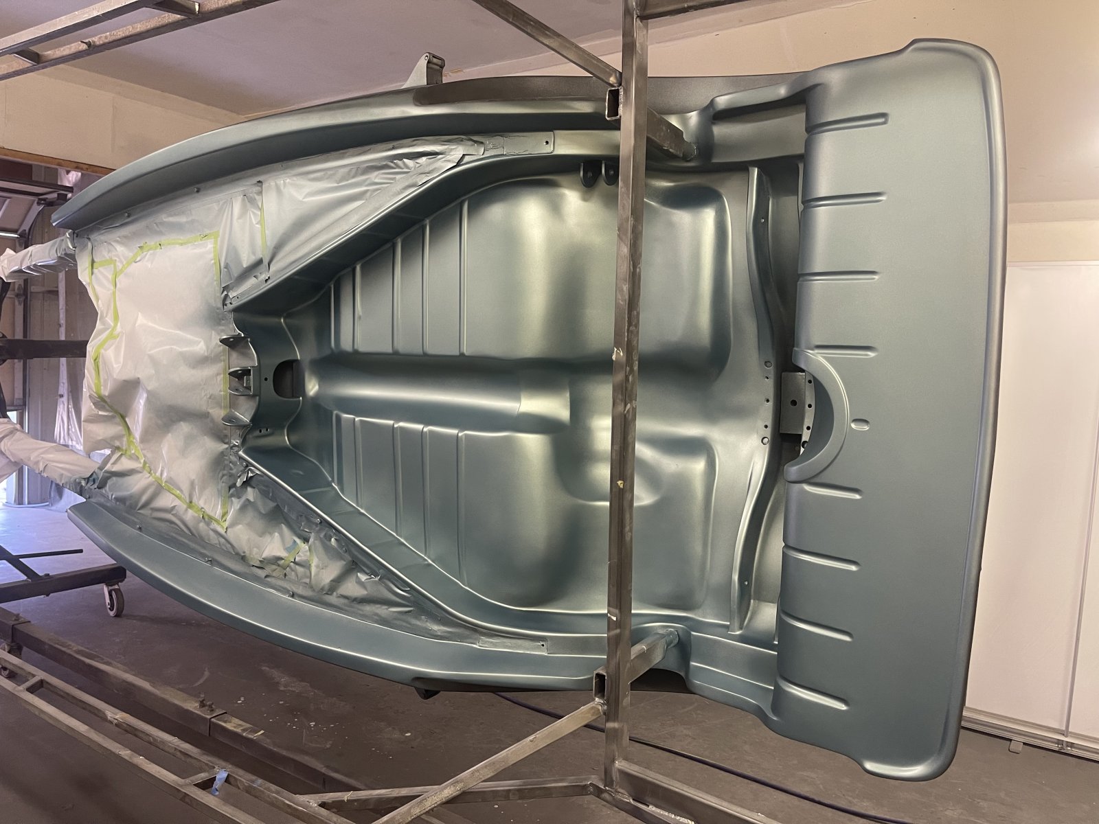

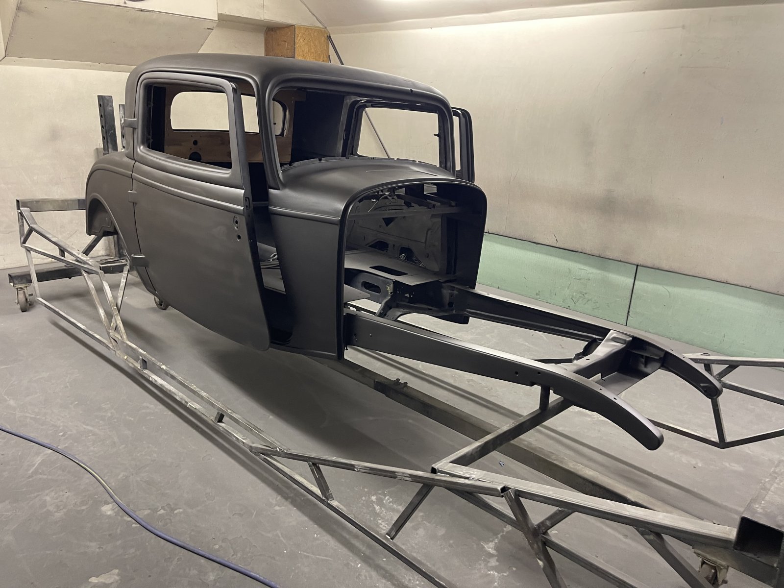

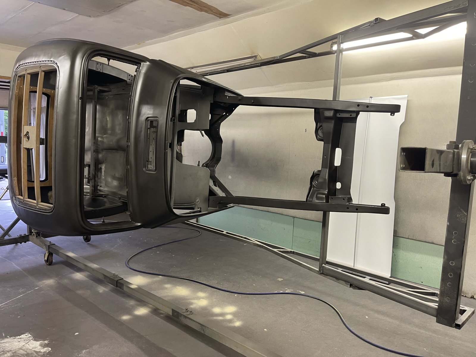

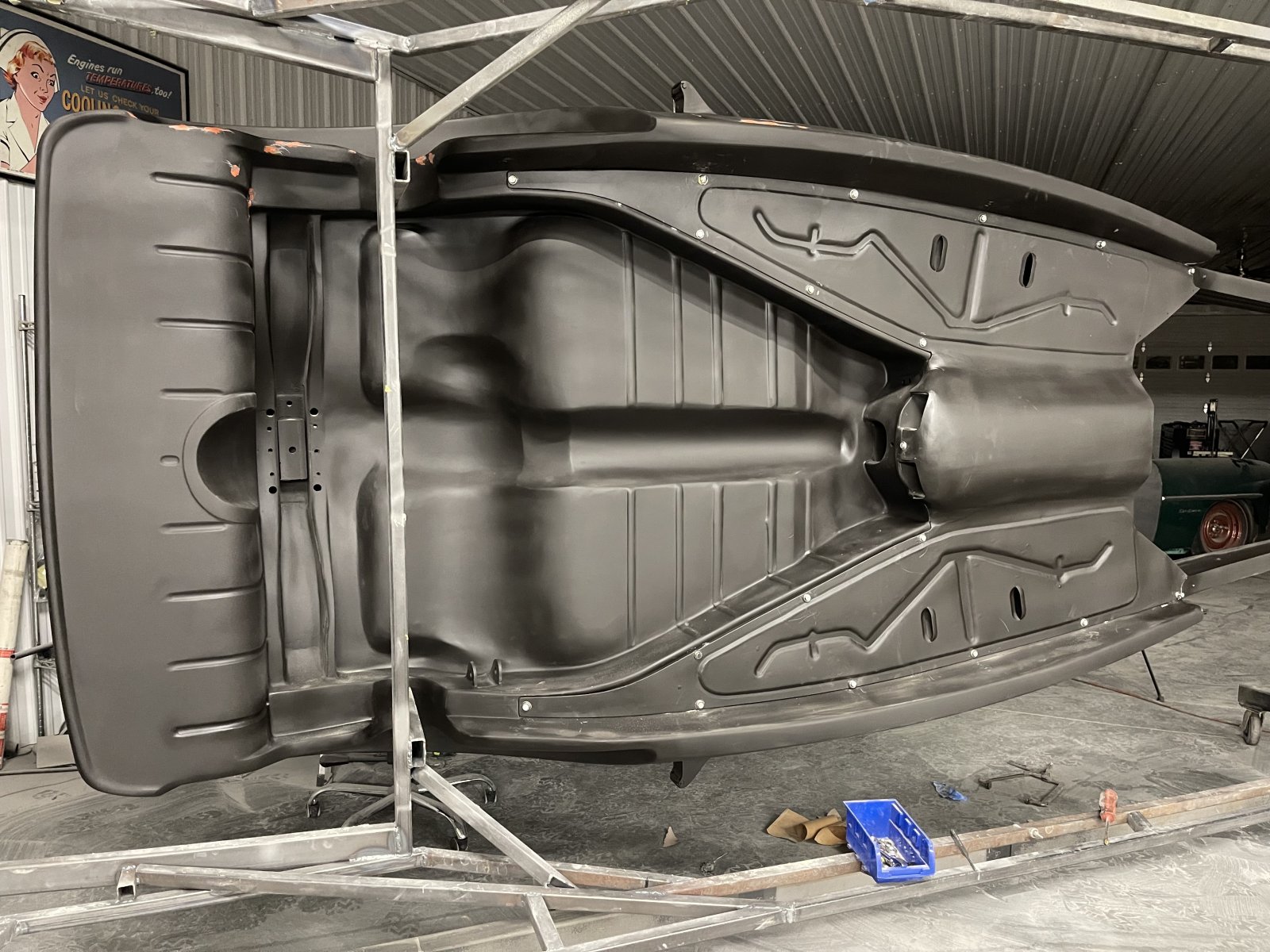

    IMG_0145.jpeg IMG_0115.jpeg IMG_0111.jpeg IMG_0114.jpeg IMG_0021.jpeg IMG_0015.jpeg IMG_0013.jpeg IMG_0010.jpeg

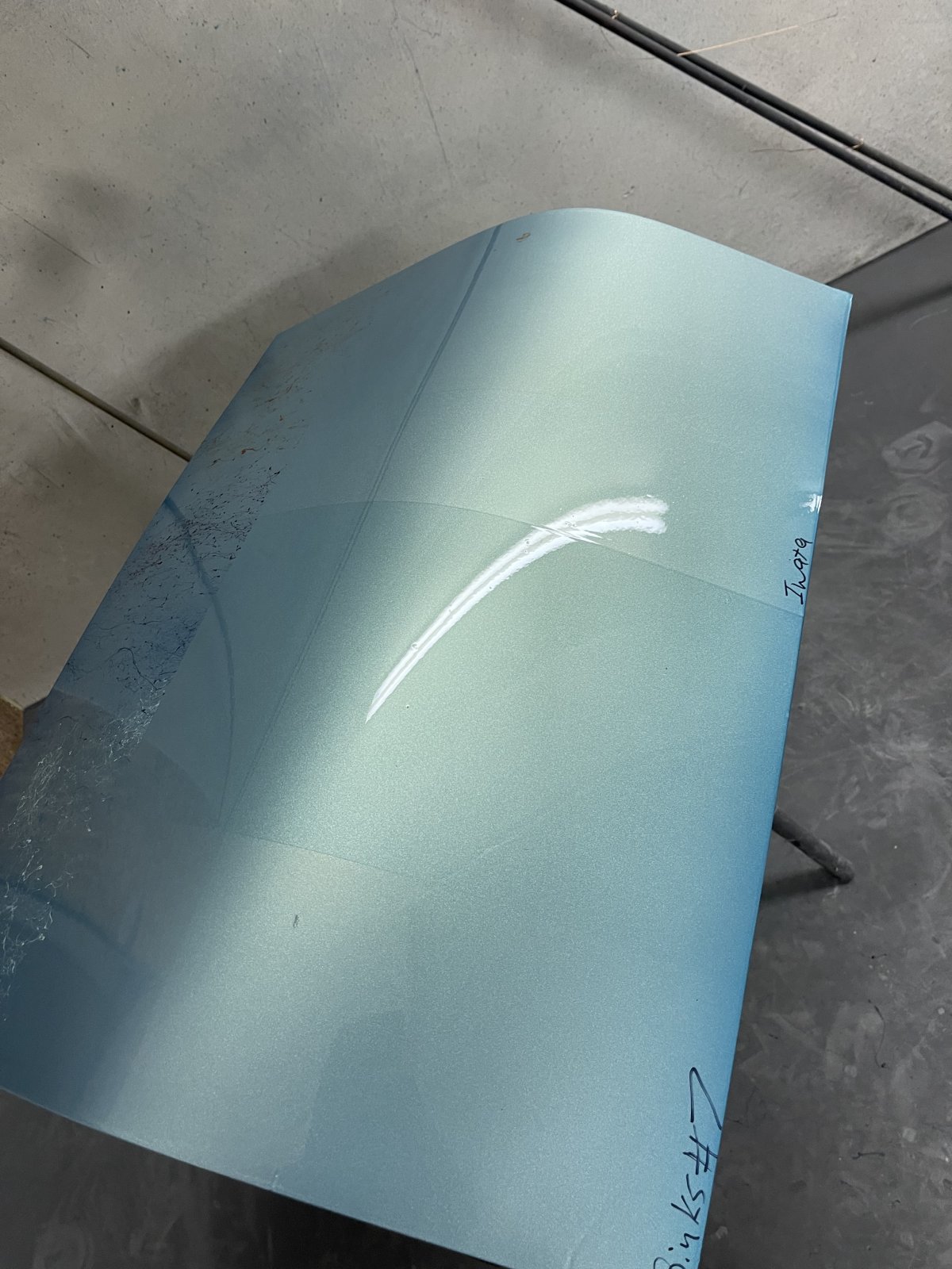

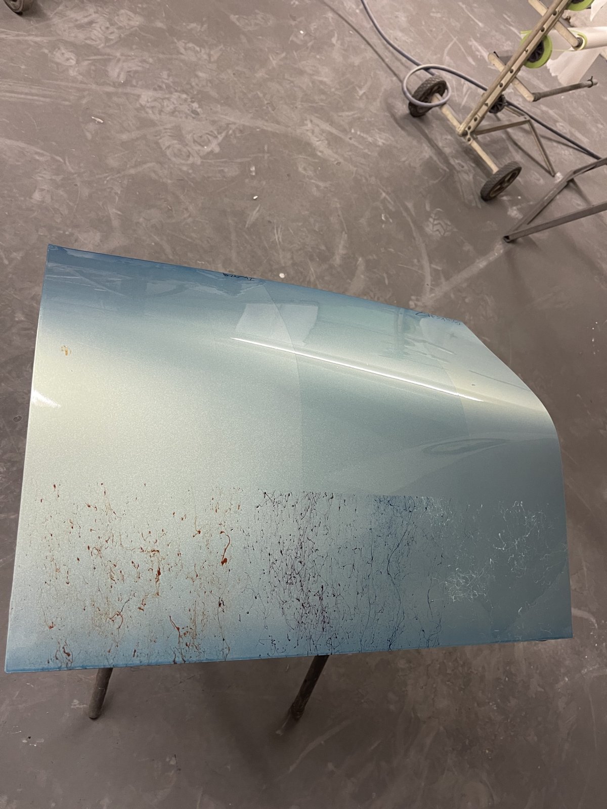

    Oh my; what is that, a light silvery blue with a gold pearl?
    Stogy, chryslerfan55 and Just Gary like this.

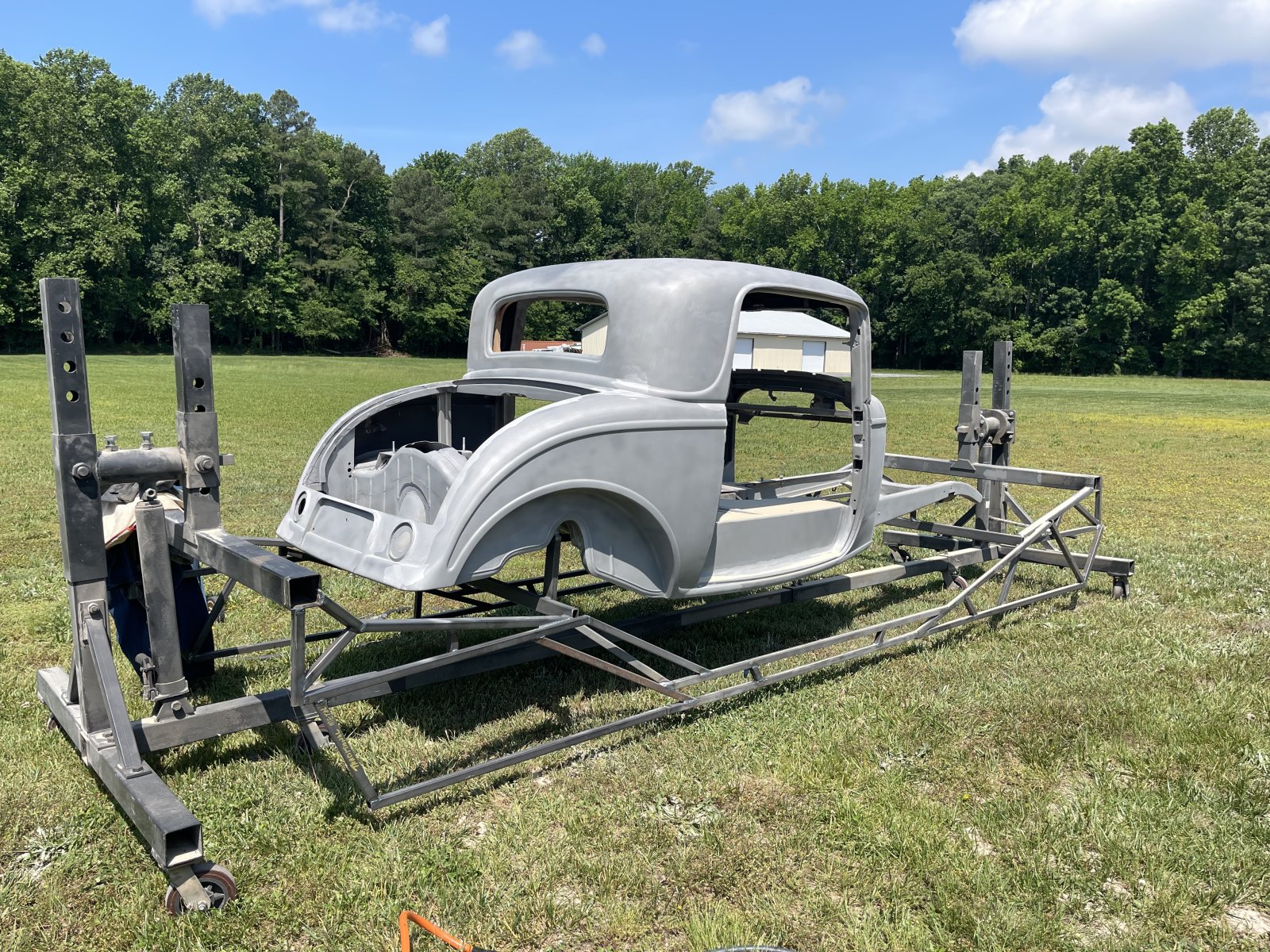

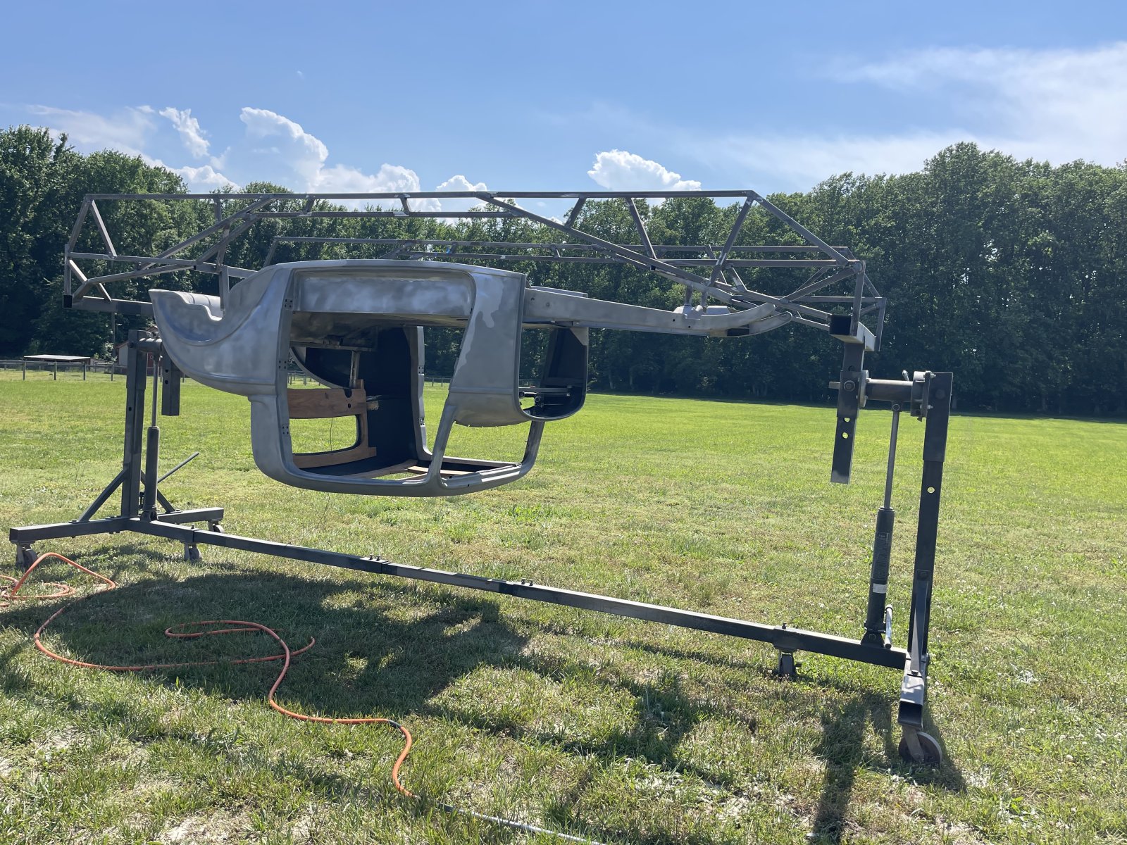

  23. rod1
    Joined: Jan 18, 2009
    Posts: 1,512
    rod1
    Wow. Cubic hours .It's going to look amazing .Already does. Your Rotisserie-frame jig is way cool. Thanks for taking us along .
    Stogy, Just Gary and chryslerfan55 like this.

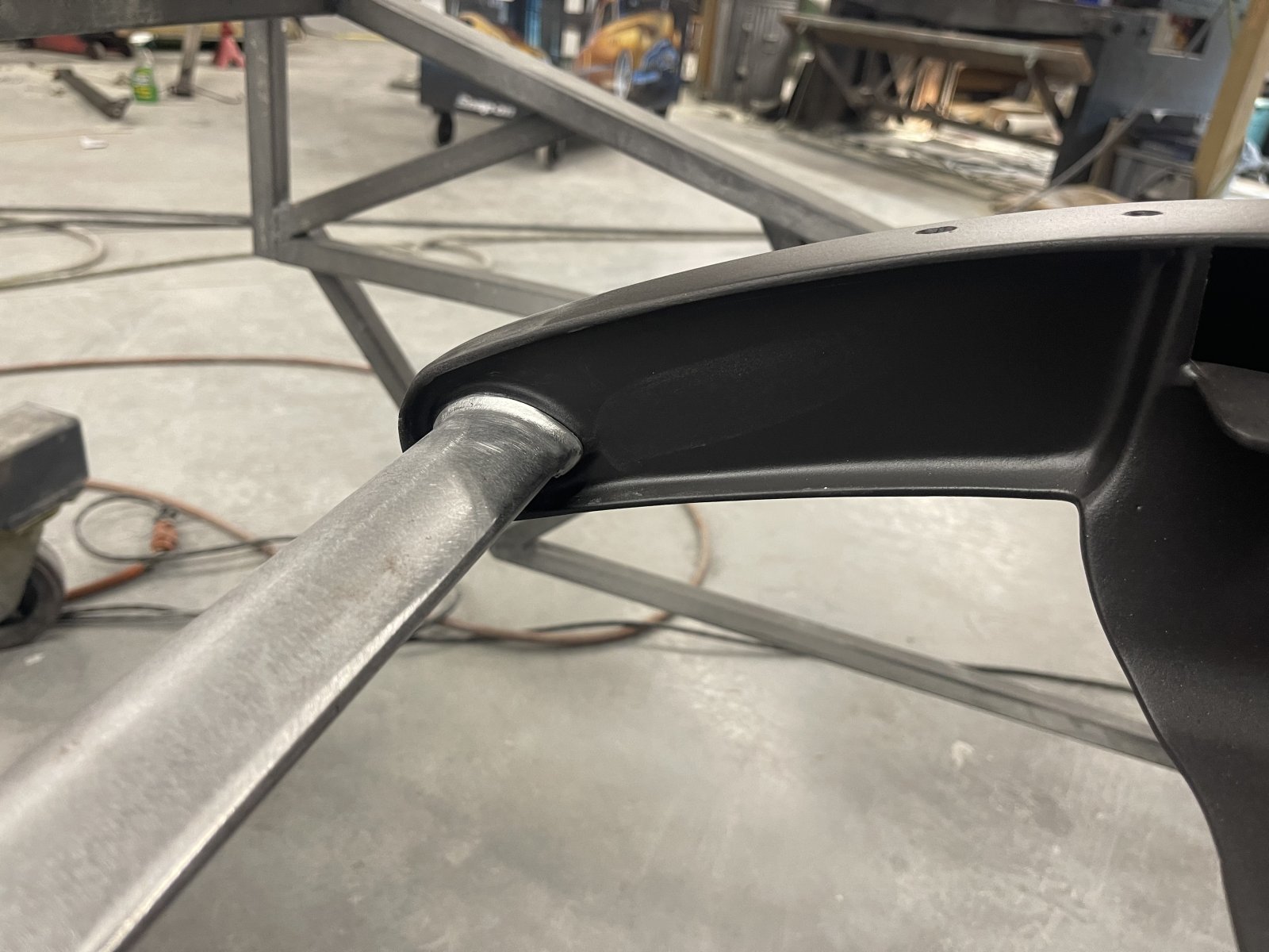

  24. drdave
    Joined: Jan 3, 2006
    Posts: 5,257
    drdave

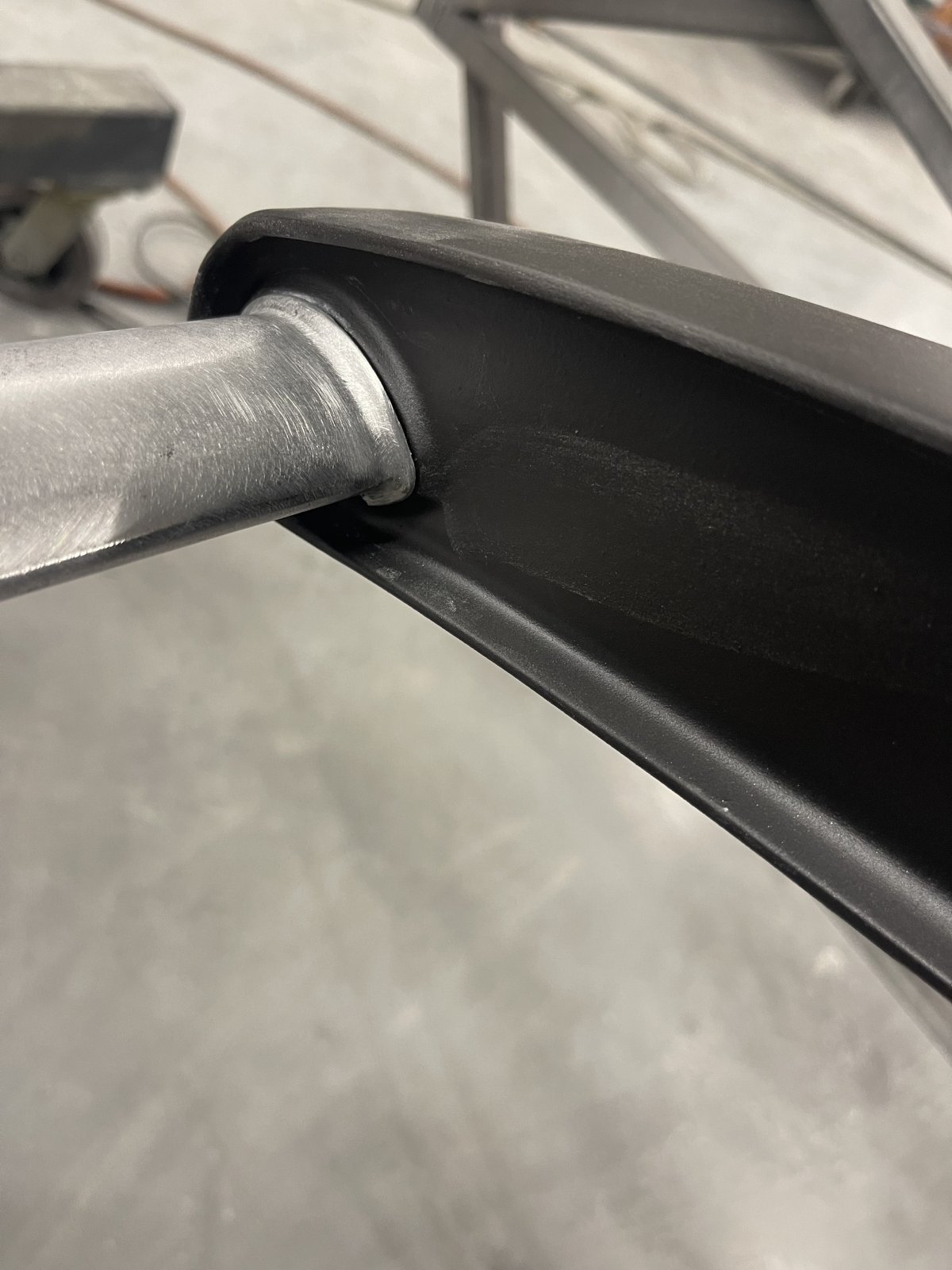

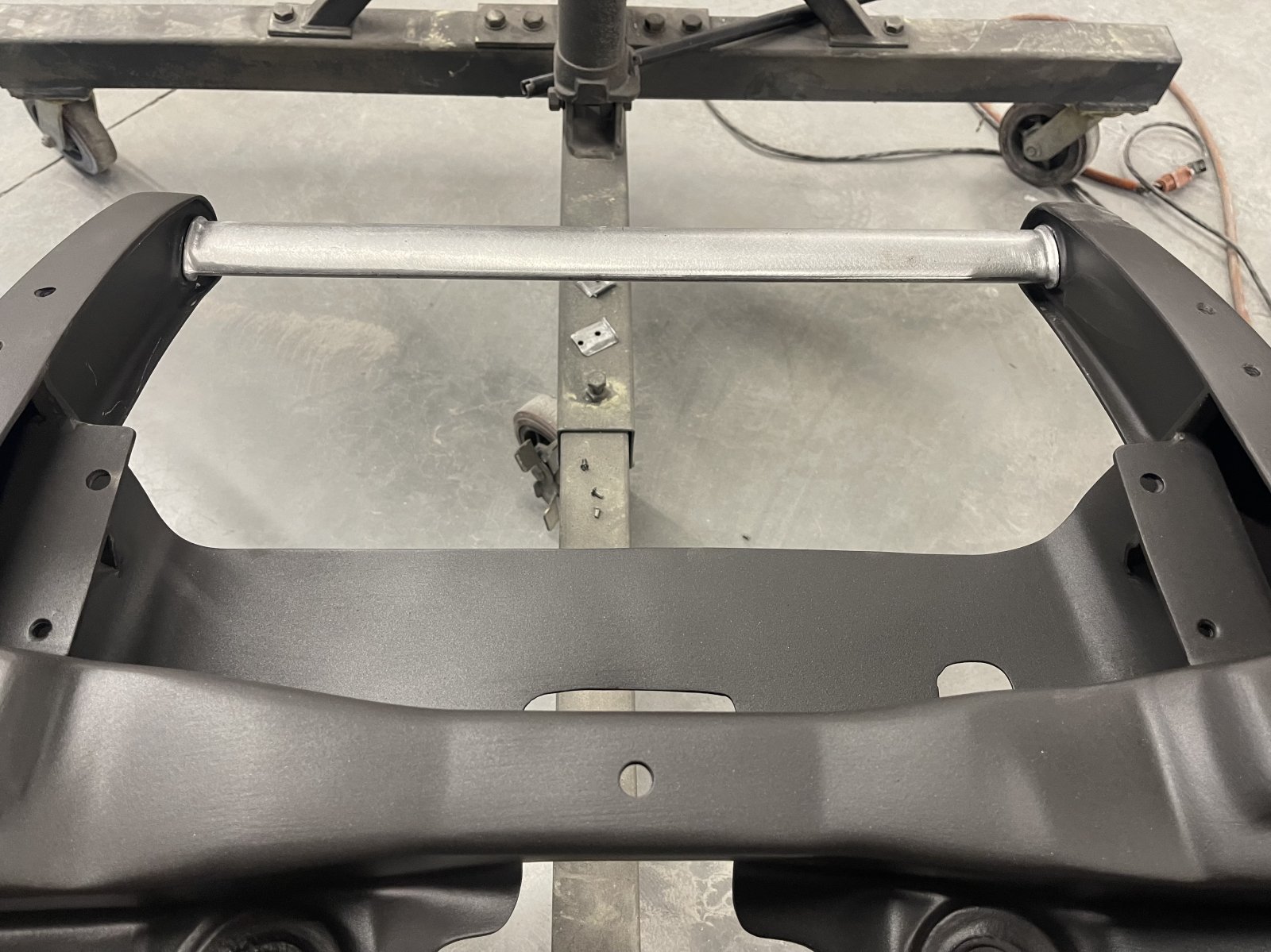

    The details Cody, the DETAILS! The radius on the boxing plates, the radius on the spreader bar mount and let's not even start on the spreader bar itself. Just amazing!!!
    Stogy, Outback, brEad and 10 others like this.

  26. Bcap55
    Joined: Oct 5, 2009
    Posts: 347
    Bcap55
    from PA, USA
    I'm lovin the spreader bar design. Nice job.

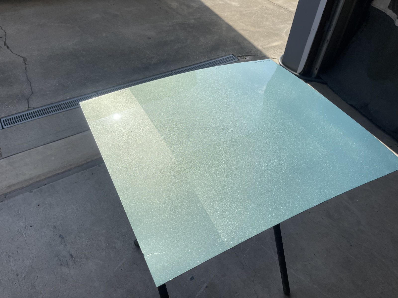

  30. Cody Walls
    Posts: 1,574
    Cody Walls
    With the binks #7. It’s bluer a the metallic stands up way more .
    The iwata makes it more silver looking a the metallics lay down . Which I don’t want.
    binks #7 for the win .
