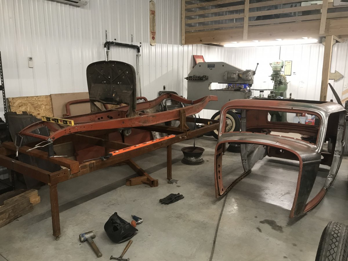

    You make it look too easy!
  2. 57JoeFoMoPar
    Joined: Sep 14, 2004
    Posts: 6,498
    57JoeFoMoPar
    Looking great, Cody. Always excited to see your progress. This will be one of the more out-of-the-box builds that breaks the common mold while sticking true to the traditional theme. Not an easy feat.
    Stogy, Cody Walls and loudbang like this.
  3. jim snow
    Joined: Feb 16, 2007
    Posts: 1,930
    jim snow
    Metal magic right there. Thanks for the photos. Snowman
    Stogy, Cody Walls, loudbang and 2 others like this.
  4. mkebaird
    Joined: Jan 21, 2014
    Posts: 340
    mkebaird

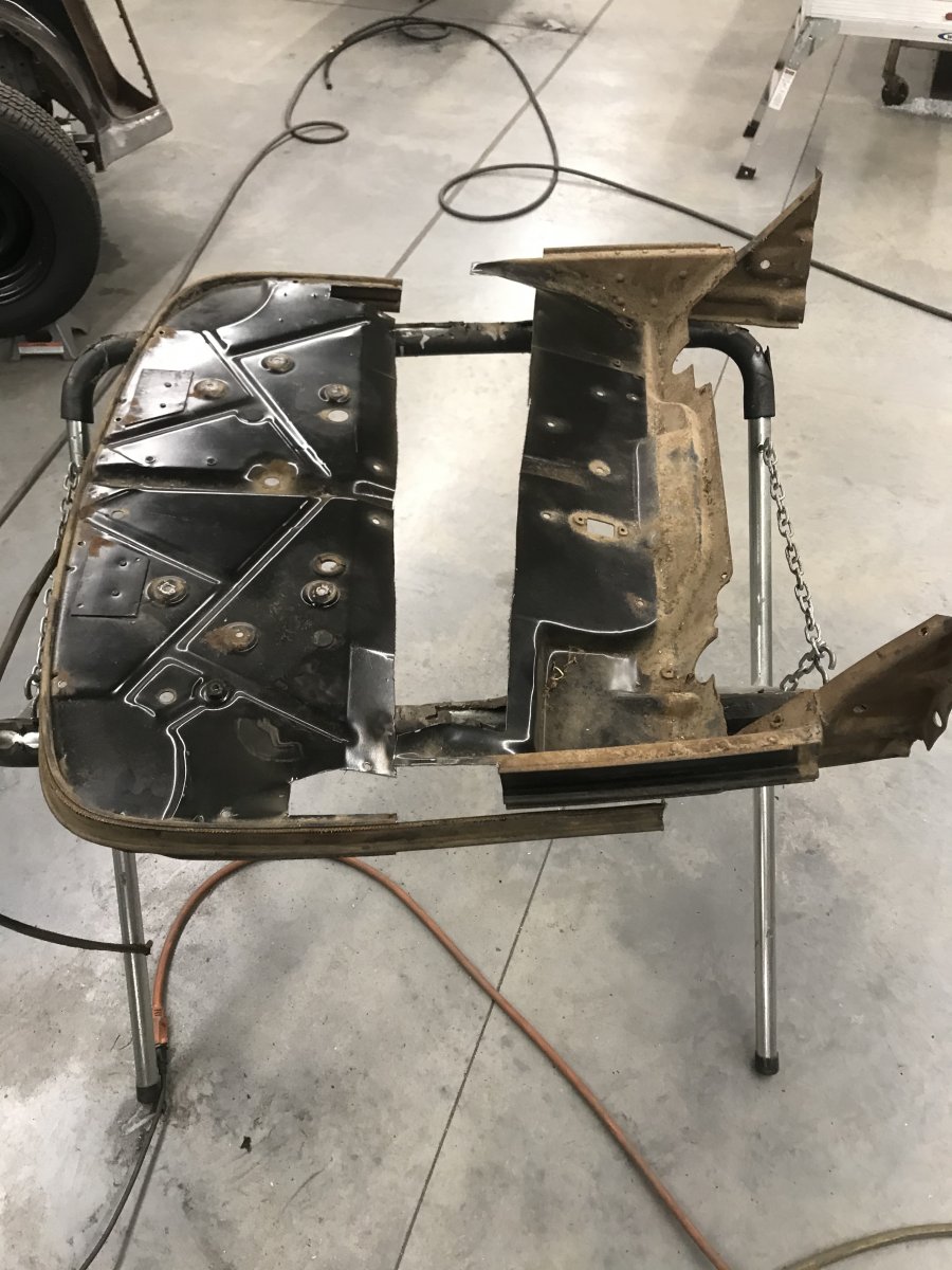

    And I thought the 6" channel on my 40 truck was wild. Thanks for the primer on the B pillars. I'm starting to replace all the wood in my 35 IHC - the doors were all wood with the skin tacked on.

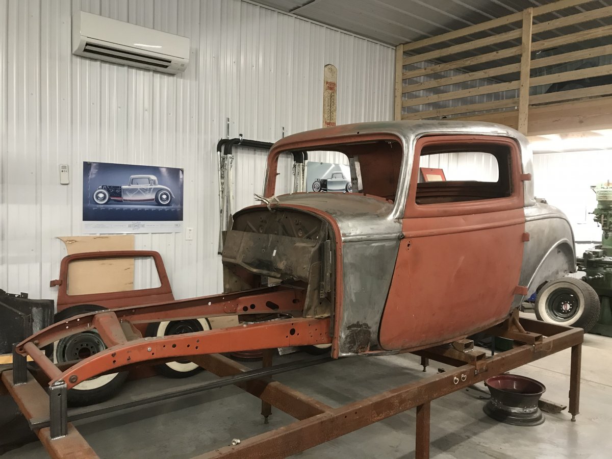

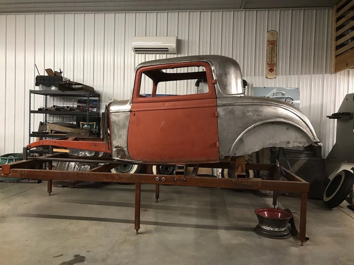

    So not much progress on the 32 lately , because I’ve been busy on my wife’s Buick and customers cars but Marshall at Thunfeild Rod and custom is in the progress of building my motor so there is still headway being made .

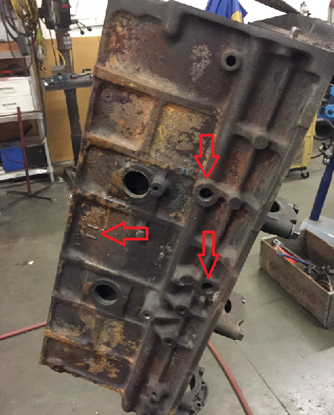

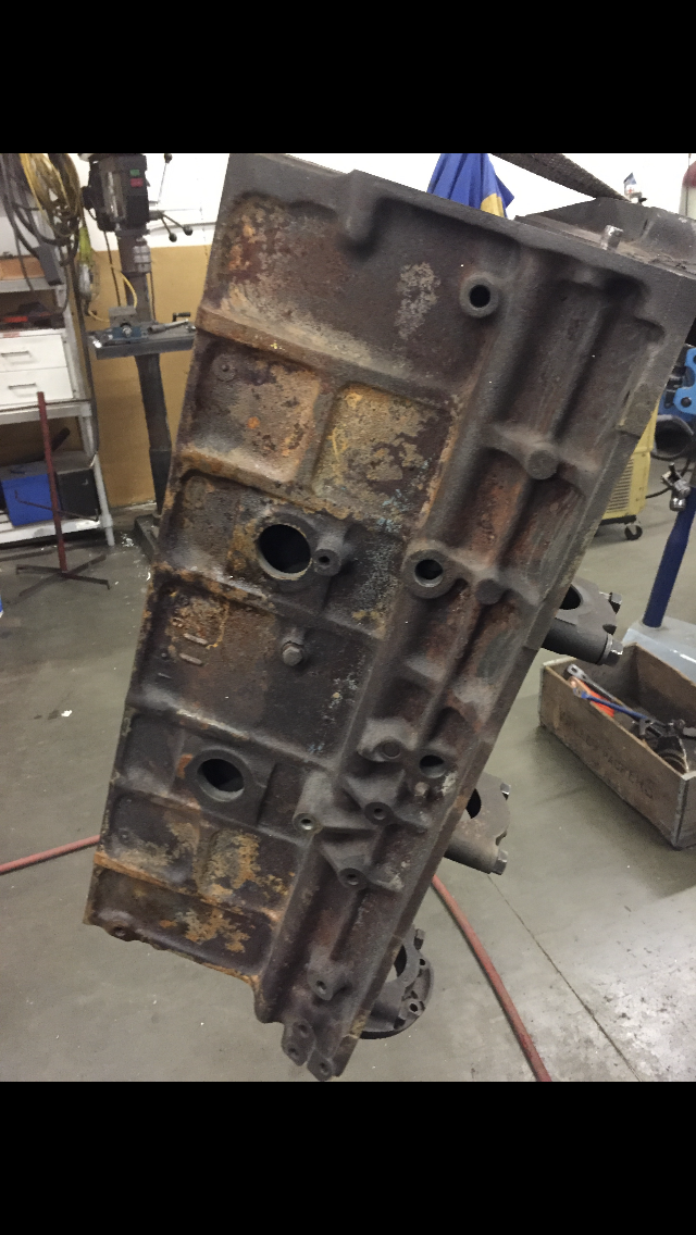

  10. Captins bars, 1/2 pipe oil inlet/outlets that looks like a 1958-1962 261.
    Did you find the Holy Grail of Wayne heads?

    I did ...... and I sold my old 11 series 15 bolt Wayne Head for the new 18 bolt Wayne head . your correct the new plan of attack is this 261 . It’s now punched out 80 over . Gmc rods . Ross racing pistons
    10:1 compression and going triple side drafts Weber carbs to feed this beast . Still looking for a cyclone bellhousing and the custom spalding Distributor that came on the Wayne motors originally .

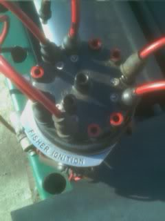

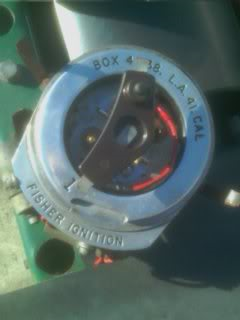

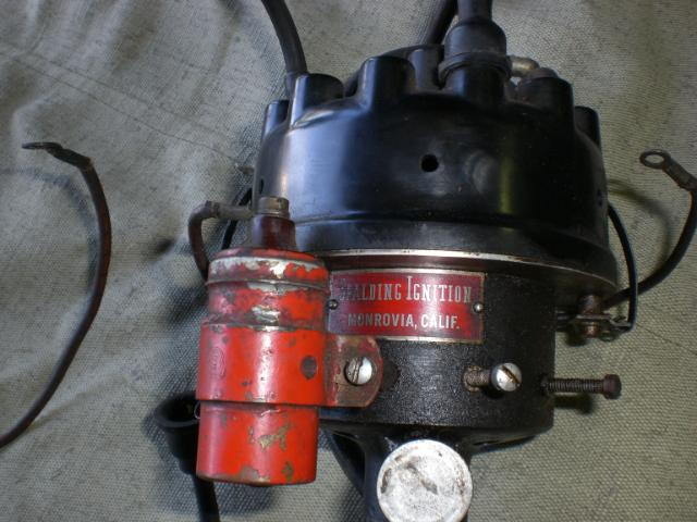

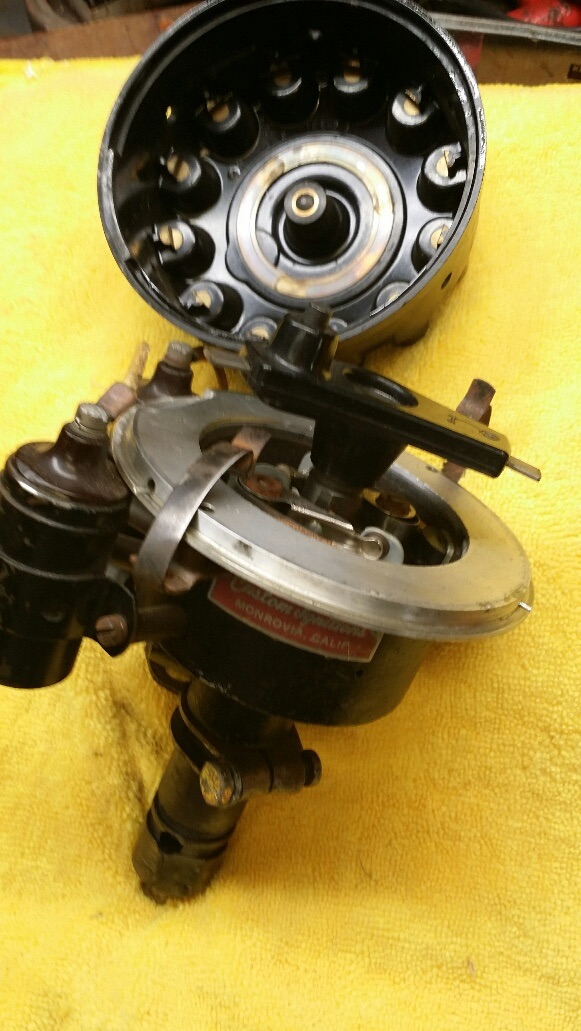

    I'm not willing to part with my Cyclone either. But as for a distributor look for a Nash Twin six distributor and adapt that. Spalding was an OE Delco with twin point conversion and Nash cap and rotor. You'd need the cam out of the Nash distributor as well I think.

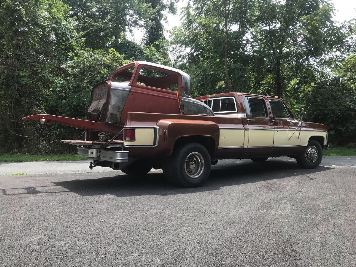

    Coupe coming along nice,Let’s see more of that Econoline!

    Who needs a backup it’s aluminum it can be welded back together if need be .lol
    Thank for looking out
