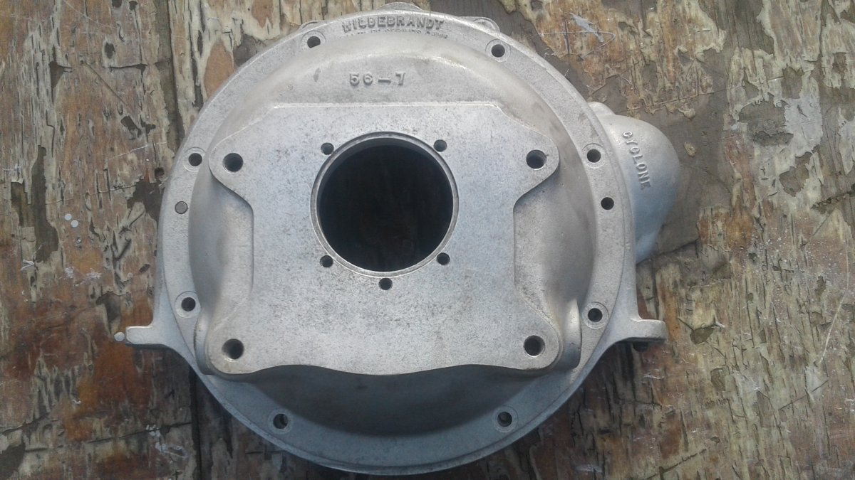

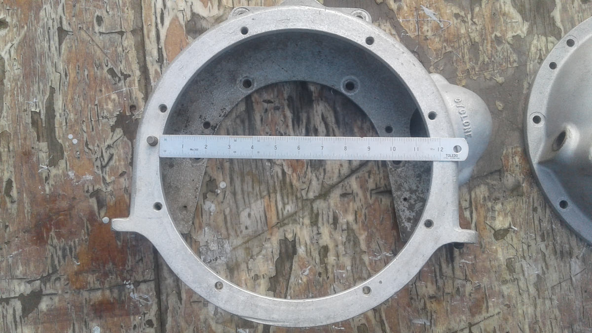

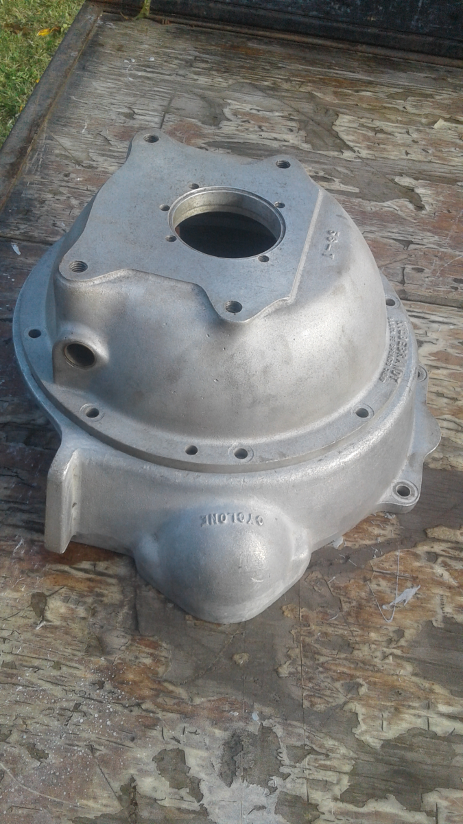

    If you can find a Cyclone and want to run a Packard trans, you'll need the equally hard to find Hildebrandt or Offy Packard adaptor. @Stovebolt has the same setup, and he's in Australia and I'm in NZ, so they are around. However, you are limited to clutch size. A Chevy 9 1/8" just slides in, but these were designed for a flathead clutch so I have yet to find out what the largest of those will fit. A more practical and cheaper option would be to buy the adaptor from Buffalo to adapt a SBC ****tershield and redrill for the Packard. Then you could go to 11" clutch, and swap to a 5 speed easily if you need to.

  10. Cody Walls
    Joined: Nov 14, 2008
    Posts: 1,574
    Cody Walls
    Thank you for the information as well as the photos, I have heard that the clutch selection on the cyclone was limited to size but I didn’t know exactly . From what I was told with my motor setup I’ll need a nice slice clutch . This is the first time I’ve seen the Packard adaptor . I’ve been talking with stovebolt about his .
    The Packard face on That adaptor looks a lot like a Chevy trans mounting surface .

  11. Gofannon
    Joined: Feb 8, 2007
    Posts: 993
    Gofannon

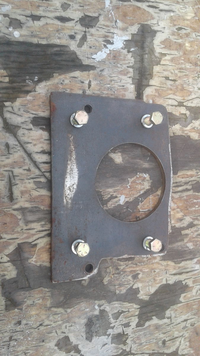

    Mounting holes are different. Here's the cheap and nasty conversion I was going with until the Cyclone fell in my lap. 10mm (3/8") plate to bolt the Packard to OE Chevy 6 cylinder bell housing. The holes with bolts in them are the Packard ones, left side of pic is the bottom of the adaptor. Packard clutch shaft is identical to Chevy. There seems to be 2 different bearing retainers for Packard. One can be machined down to Chevy size to take a Chevy thrust bearing. Mine is larger diameter and can't. With the Cyclone the Packard bearing retainer is discarded and the trans bolts to the adaptor. Then a Ford bearing retainer is bolted inside the adaptor for Ford thrust. If you find a Hildebrandt or Offy Packard adaptor, you could use it with a Buffalo adaptor and a SBC to Flathead trans adaptor, and still run a bigger clutch.

  16. Cody Walls
    Posts: 1,574
    Cody Walls
    Wow they are extremely close , I see why guys ran them back in the day . Thank you for the photos and info

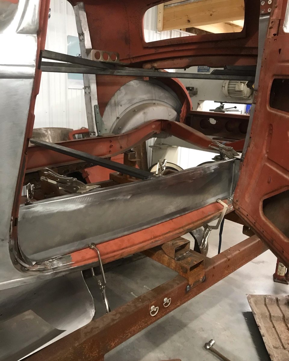

    How much is the channel? Pics almost show it heavier in the front.

    9”up front 8”in the back , it’s the most I could go and still be able to fit . I would have went more but I’m 6ft

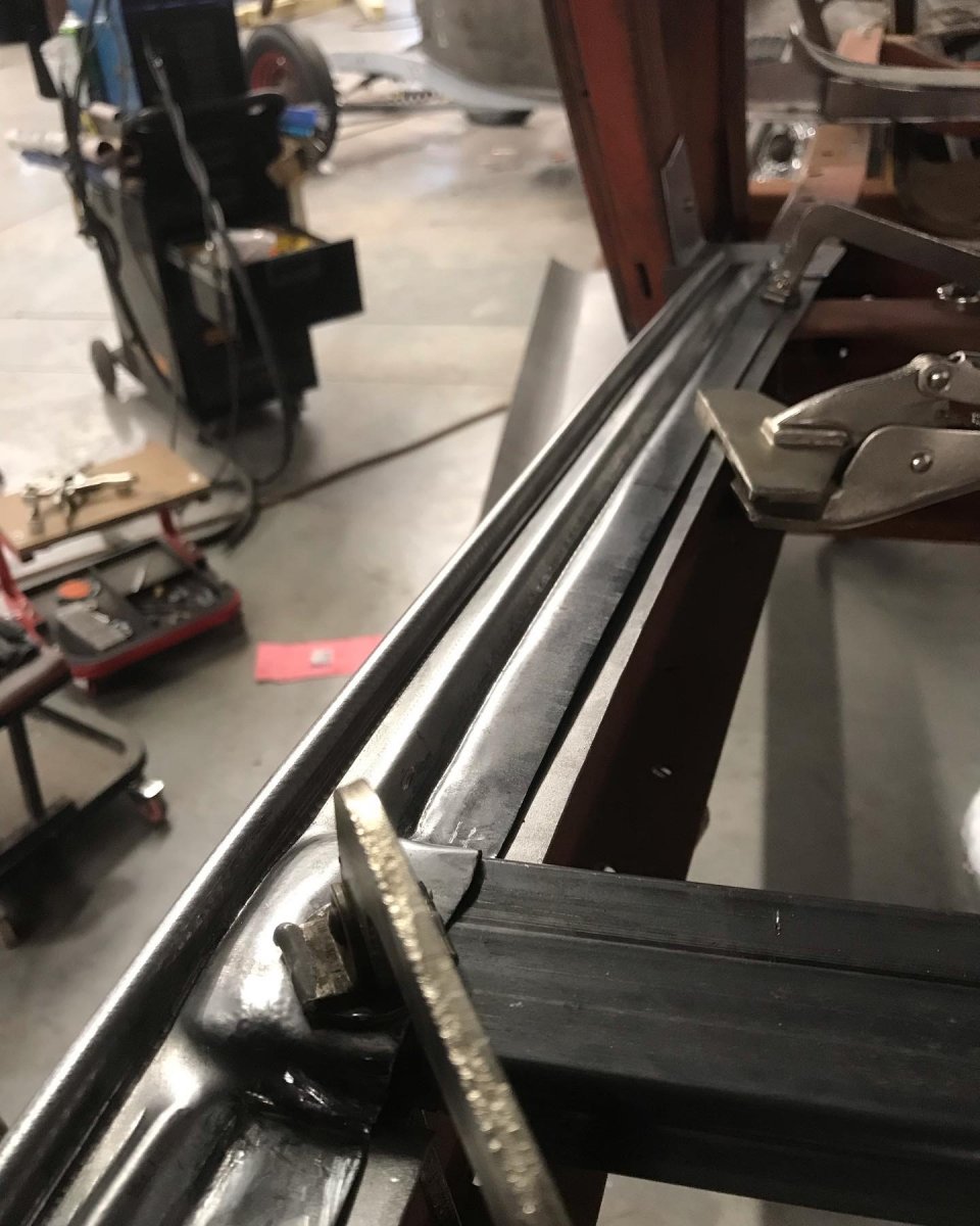

    Clever. I like how you mimicked the '32 frame with the sheet metal on your channel. Well done!

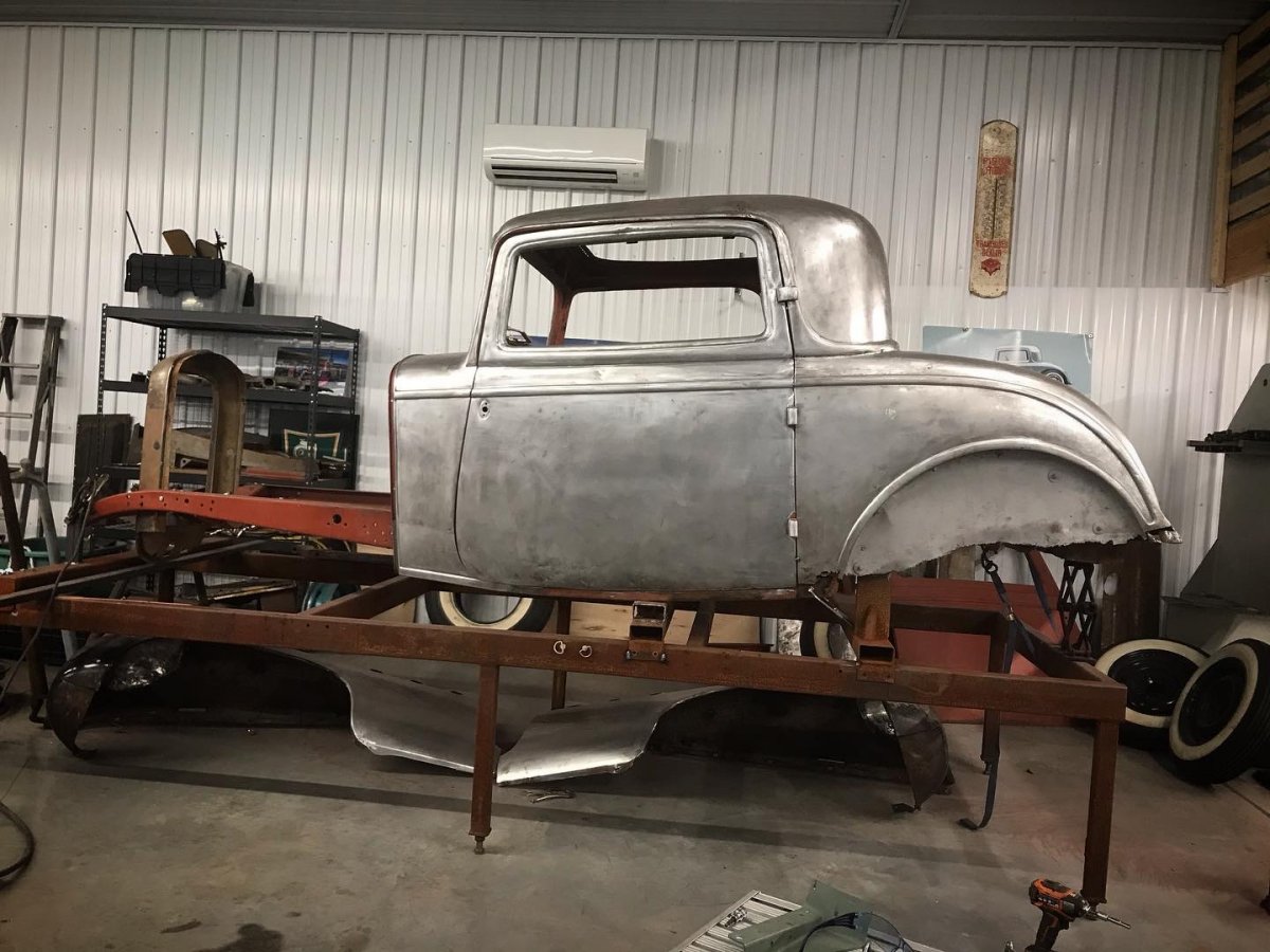

    It would take a lot to move the body back up on the frame..

    Yes it would . But then it would be like every other 32 out there
