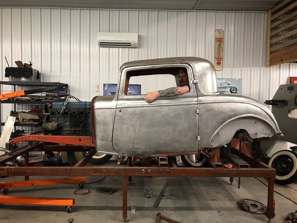

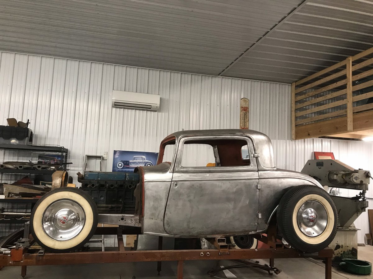

    Needless to say I’m a happy camper . Started to install the mock up motor and seeing how things fit .

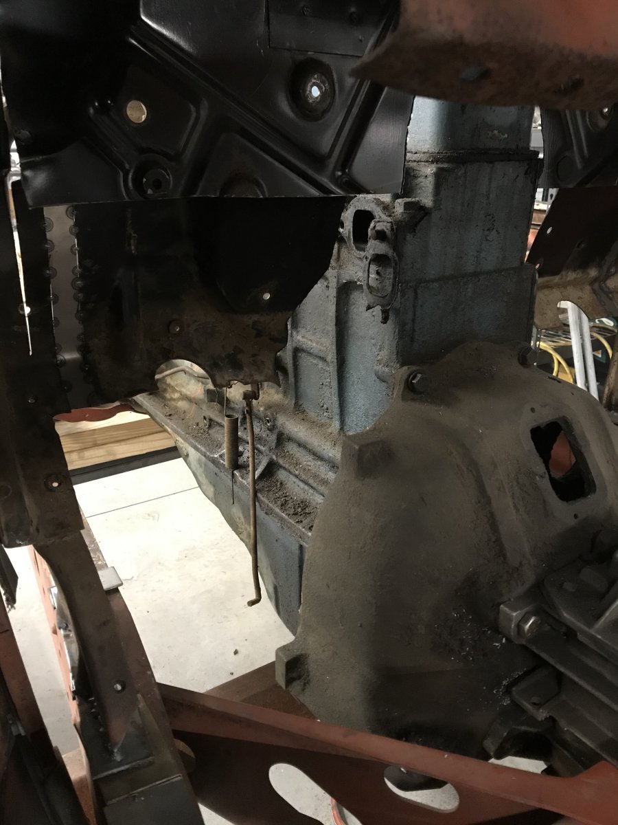

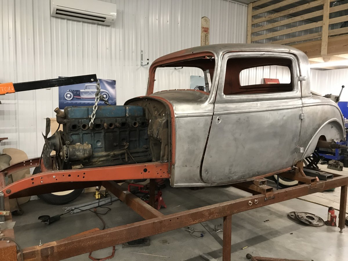

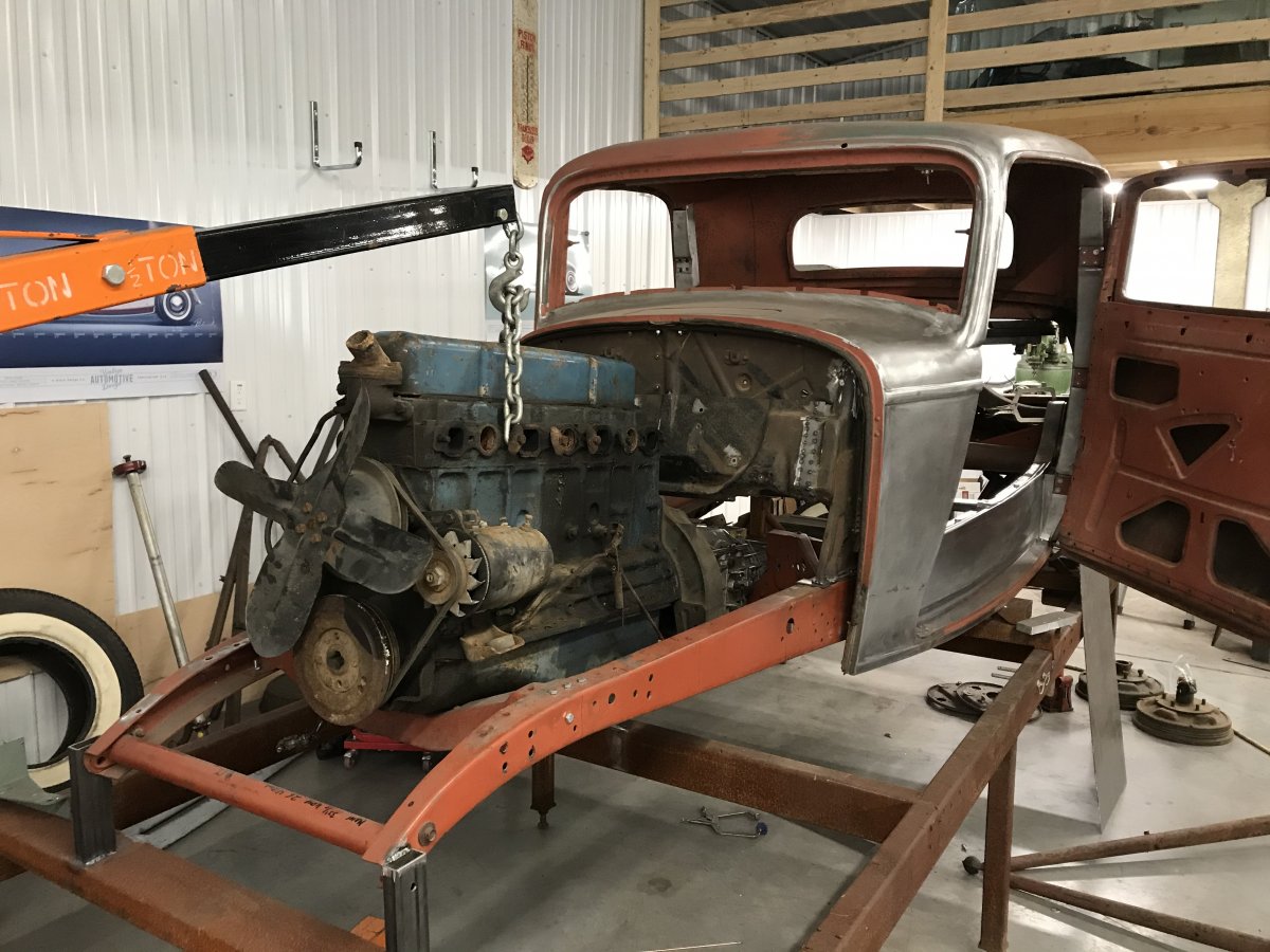

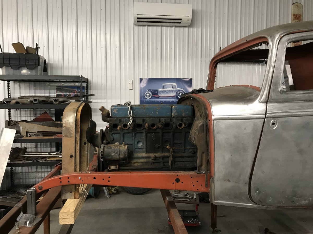

    Looking at your engine decked in the frame I'd say a little set back of the engine into the firewall would give the car better proportions, a compe***ion vibe, better weight distribution and more oil pan / crossmember clarance. I did that on my Willys coupe.

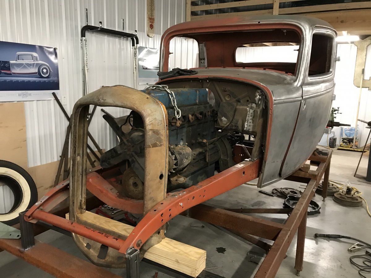

    Well that’s where the engine is going to stay .

    Its looking better to me with the engine set back. You'll want to be able to remove the valve cover so allow enough clarance above it in the notched firewall which may entail putting a reinforcing hoop inside the cowl to maintain rigidity. Or maybe lower the engine some? How about moving the firewall back flush with the A-pillar/windshield plane?
    You've probably thought through all of these suggestions on your own and I don't want to come off sounding like a wise ***. I'm just doing the stream-of-consciousness thing in your early build stages.

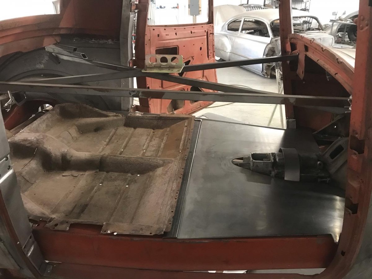

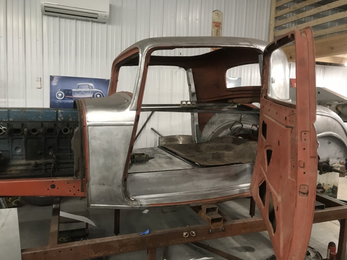

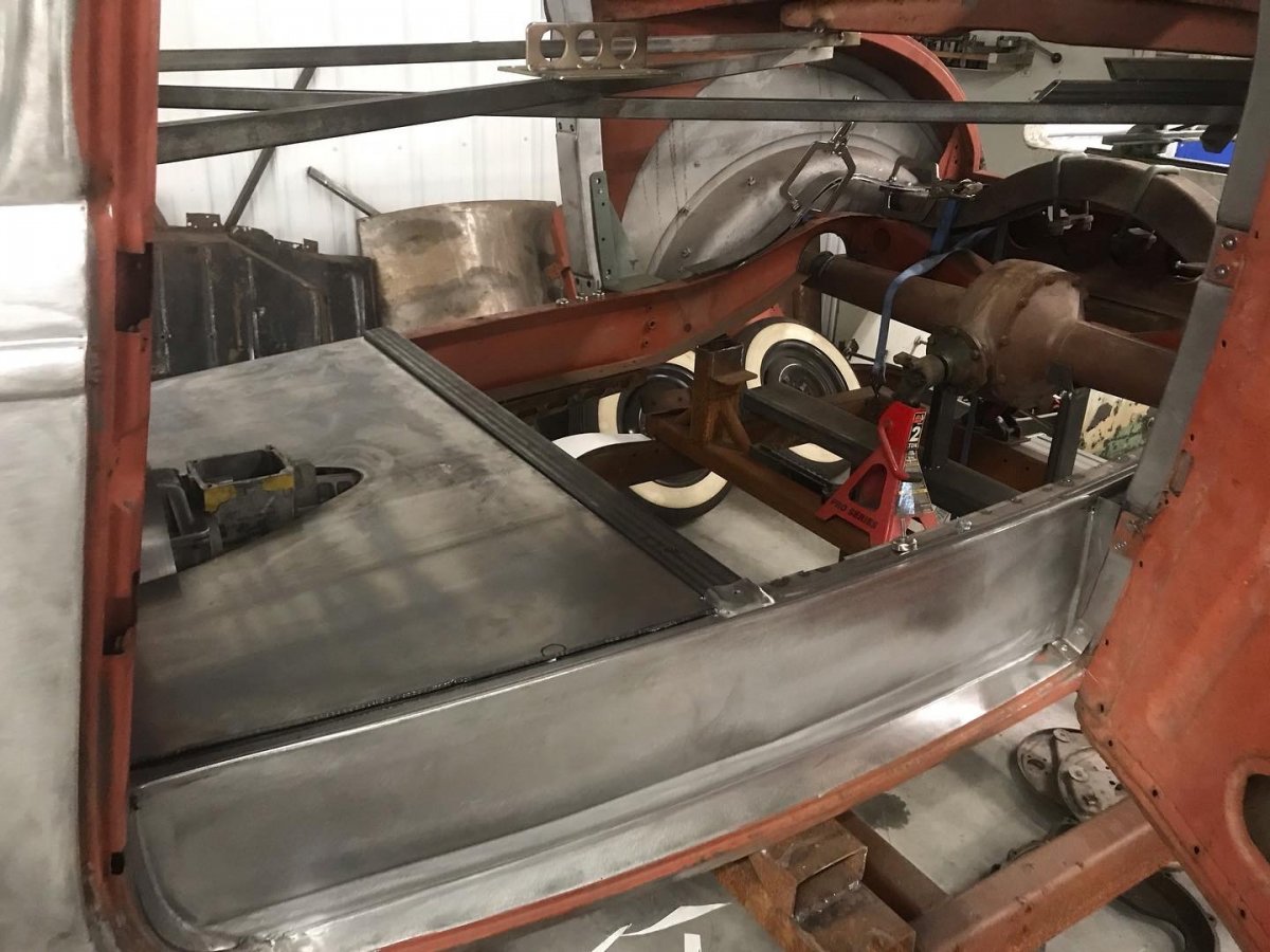

    The start of boxing the frame rails and floor sections. The boxing rail plate I made out of 1/8(11gauge) and stepped both sides on the Pullmax . It was a bit of a workout trying to hold onto the piece while running it threw there but I’m happy with the results so far . As far as the floor the front section is just a piece of 11 gauge and the back is the original 32 3 window floor , which I moved forward which will now allow my seat bottom to sit 2” lower than the rail . I will stretch the pan in the near future but so far things are working out to where I’m going to be comfortable driving this thing .

    I know everyone has there own idea , but this is my car and I do want to drive and enjoy this car . I’m tall . With the motor set back any further I will have no feet room .

    I set my firewall flush with the A-pillar and the seat back against the roof. It worked for me.
    I'm 6' 6" tall.
    But for a chopped three-window it may be more cramped; by all means make yourself comfortable so its fun to be in.
