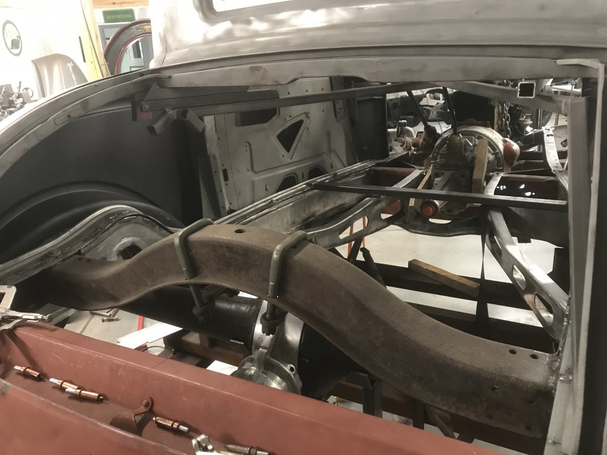

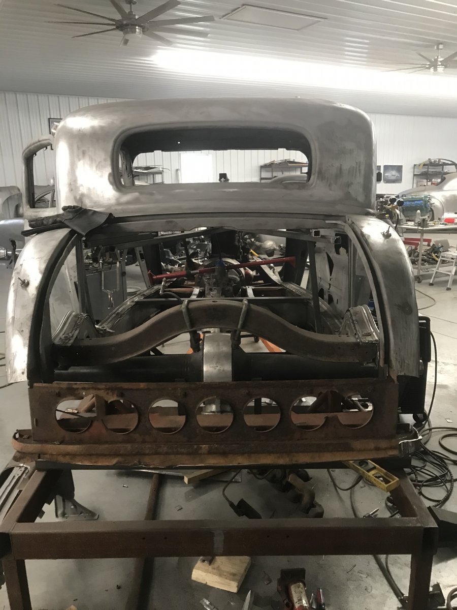

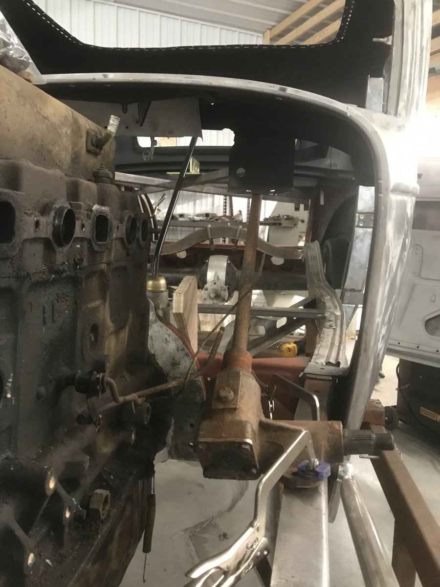

  1. Can we get a better look at your wishbone to rear end mount set up?

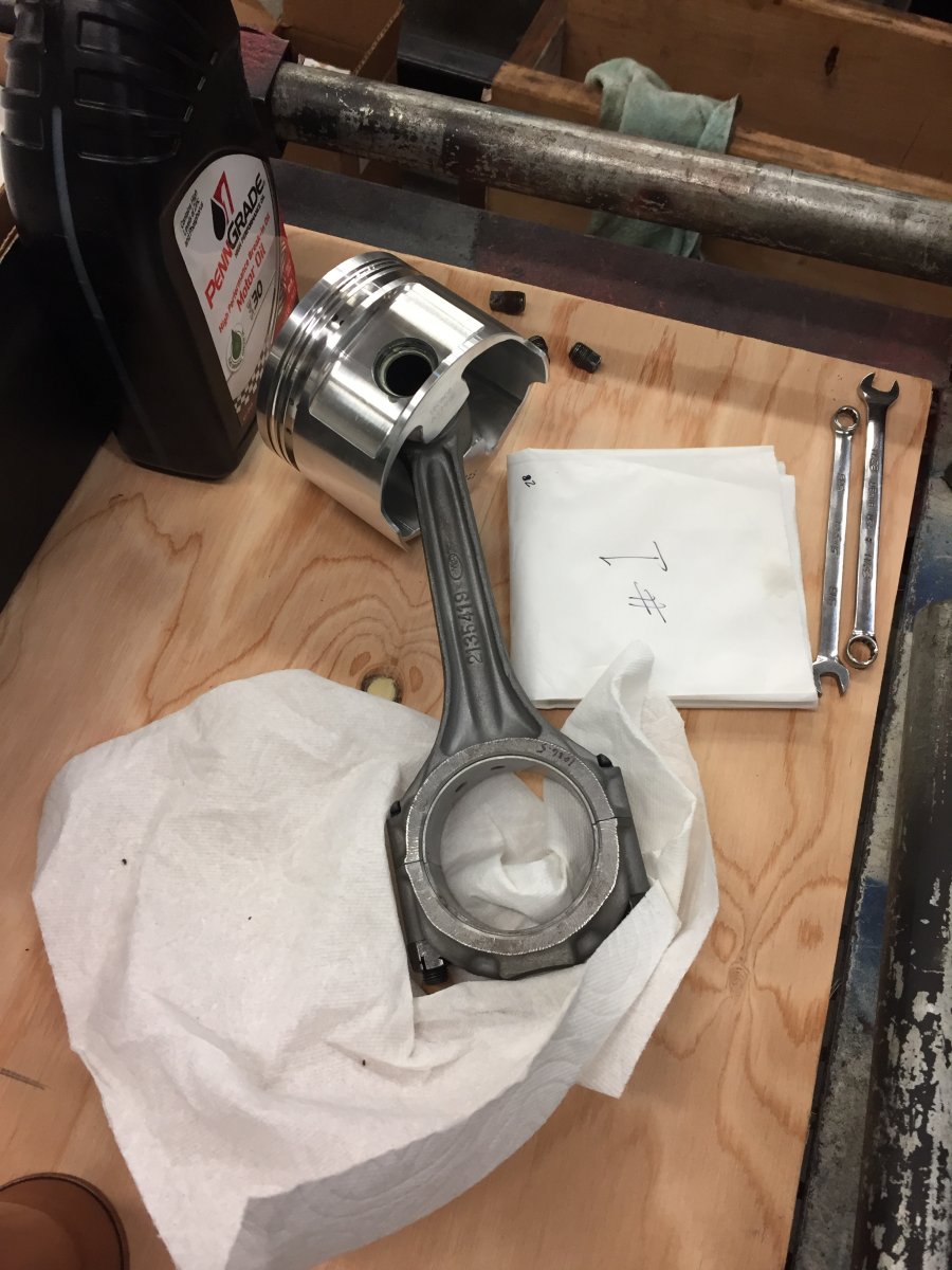

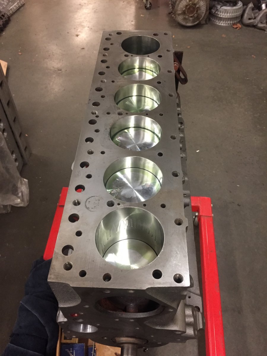

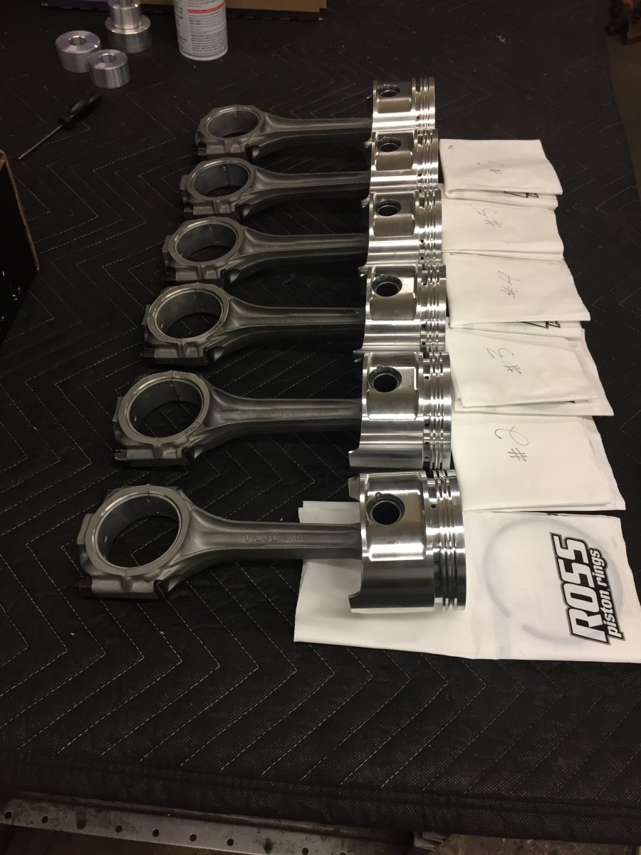

  3. What GMC rods ARE those???

    Nos Gmc 302 rods

    Color me confused.... How did u get pic of valves/head at end of cylinders?.. Great build love it

  10. Thanks, Cody! I'm guessing that they're longer- any modifications to make them fit the 261 crank?

    Marshall had to machine them down to fit the 261 crank ,, Ross pistons already makes a piston shorter to run these in a Chevy ,
    lucky ink, chriseakin and loudbang like this.
  12. Gotcha- have heard of using 261 rods in an early ('28 and earlier) Chevy 4, but nice to know that 302 rods might work as well and give even more squish :D

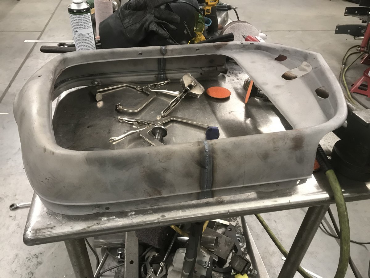

  13. It looks like you found a Cyclone adapter too.
    Is the bottom ring cut off like mine?

    It’s loaned to me for mock-up until I can find one . This one actually has the ring broken off of it .

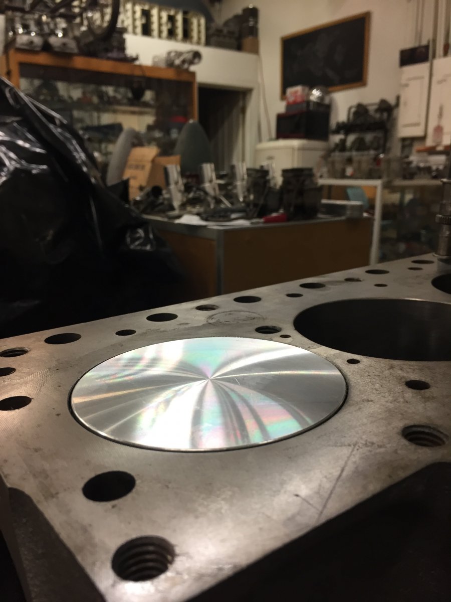

  15. Speedy Canuck
    Joined: Jun 3, 2010
    Posts: 3,896
    Speedy Canuck
    Block is upside down looking down through the cylinders from the crankcase.
  16. AmishMike
    Joined: Mar 27, 2014
    Posts: 1,418
    AmishMike
    Not familiar with that engine now notice bearing - of which there are only 4 instead of 7 I am used to. Tks for answering stupid question

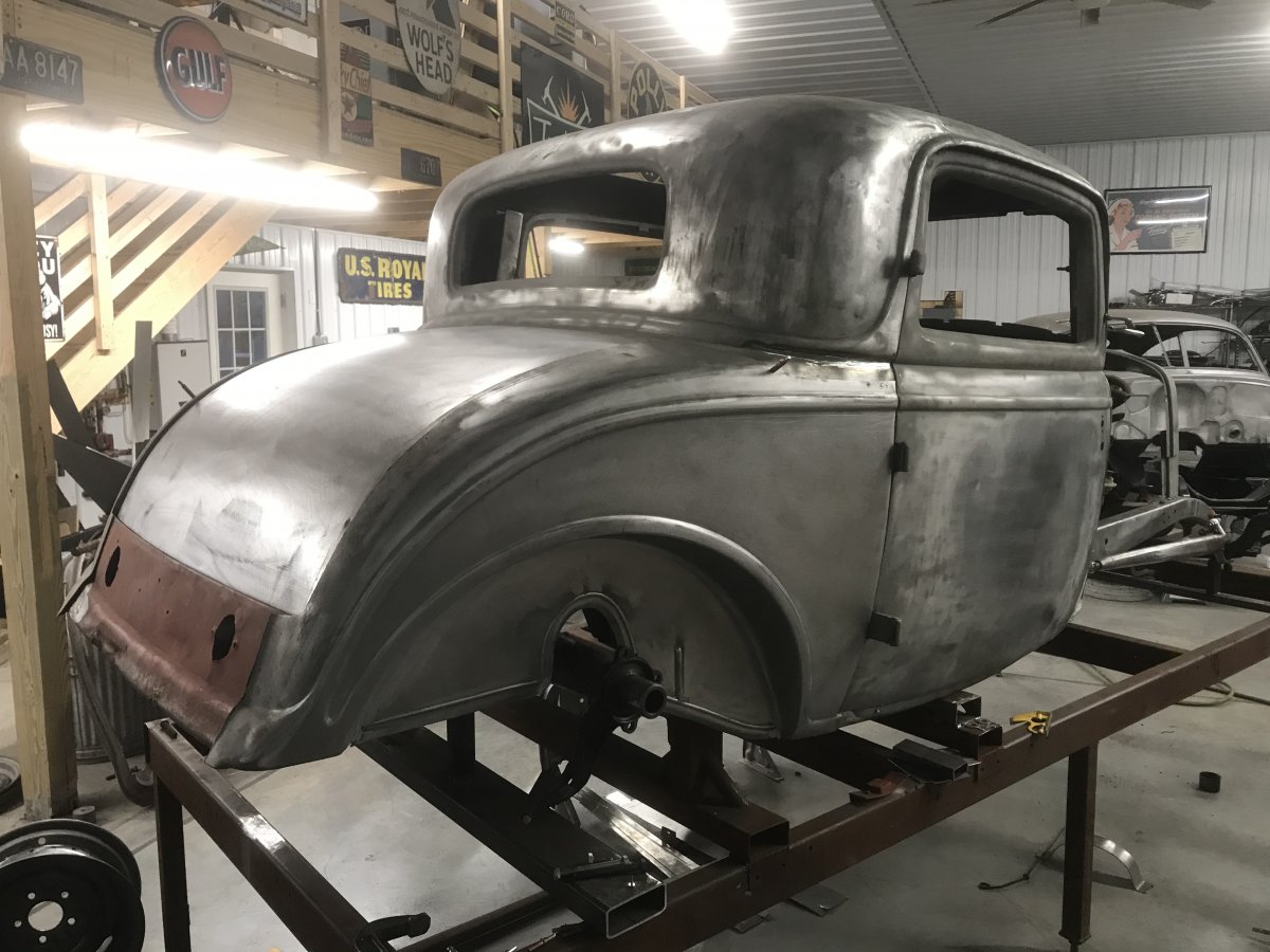

    I like it - especially the coach work you are doing.
    Very trad.

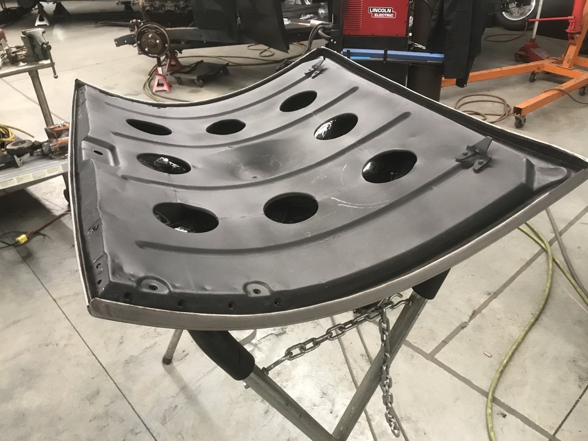

  23. Cody Walls
    Joined: Nov 14, 2008
    Posts: 1,574
    Cody Walls

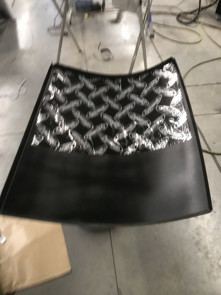

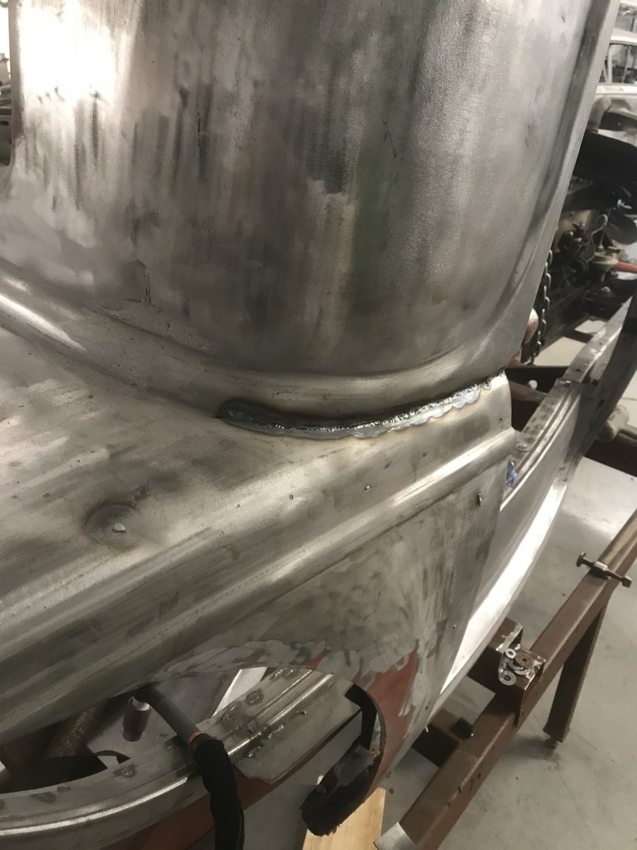

    This was what the inside of the trunk lid looked like , and the main reason I got a new skin. It was pretty thin at the bottom . With the new skin I epoxied and painted the underside the put DynaMat between the layer before I put the two pieces back together
    4” out

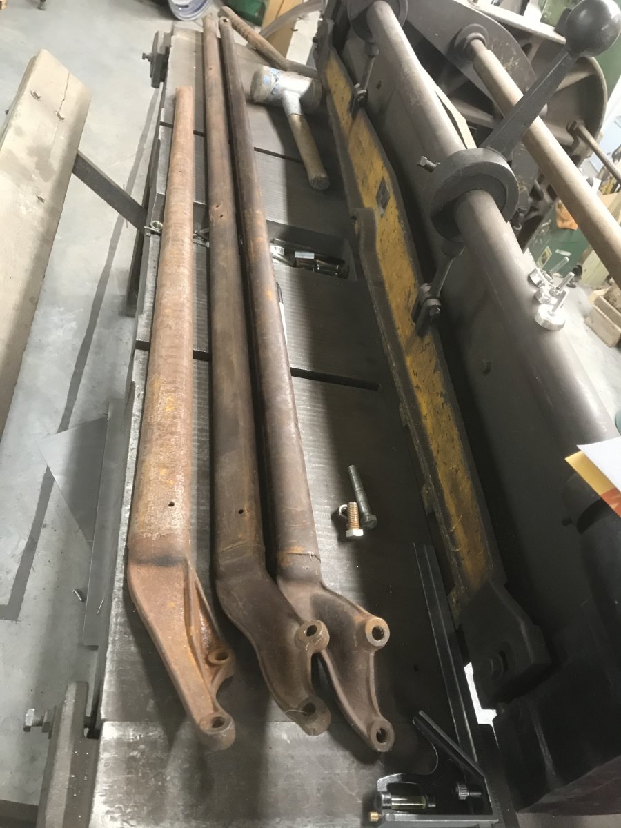

    Posts: 1,574
    Cody Walls

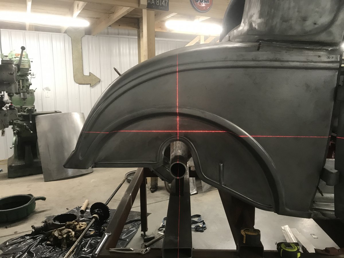

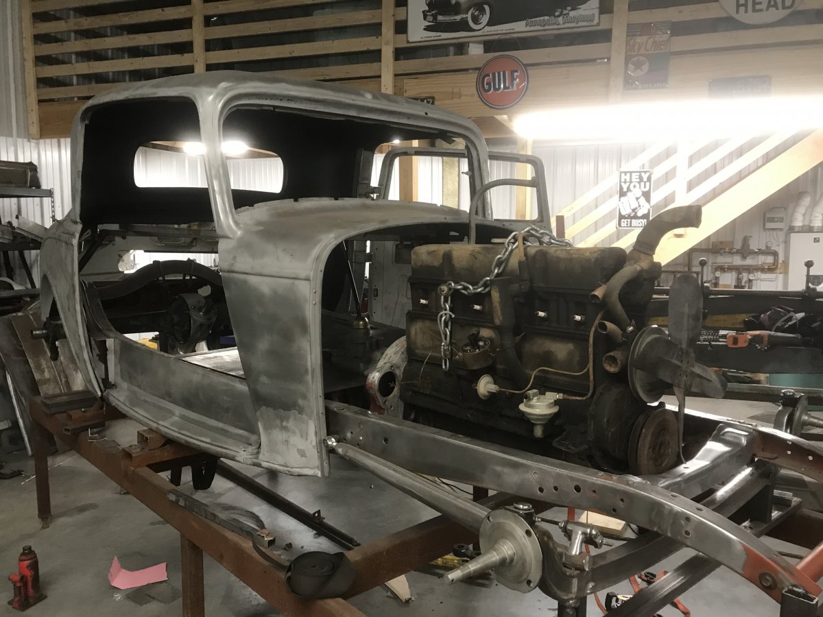

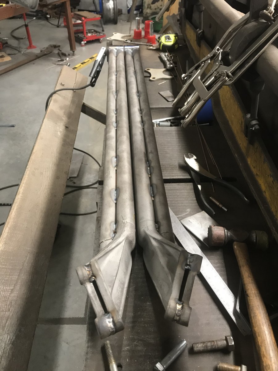

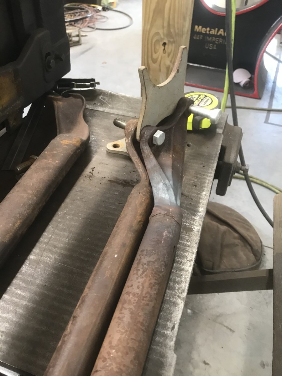

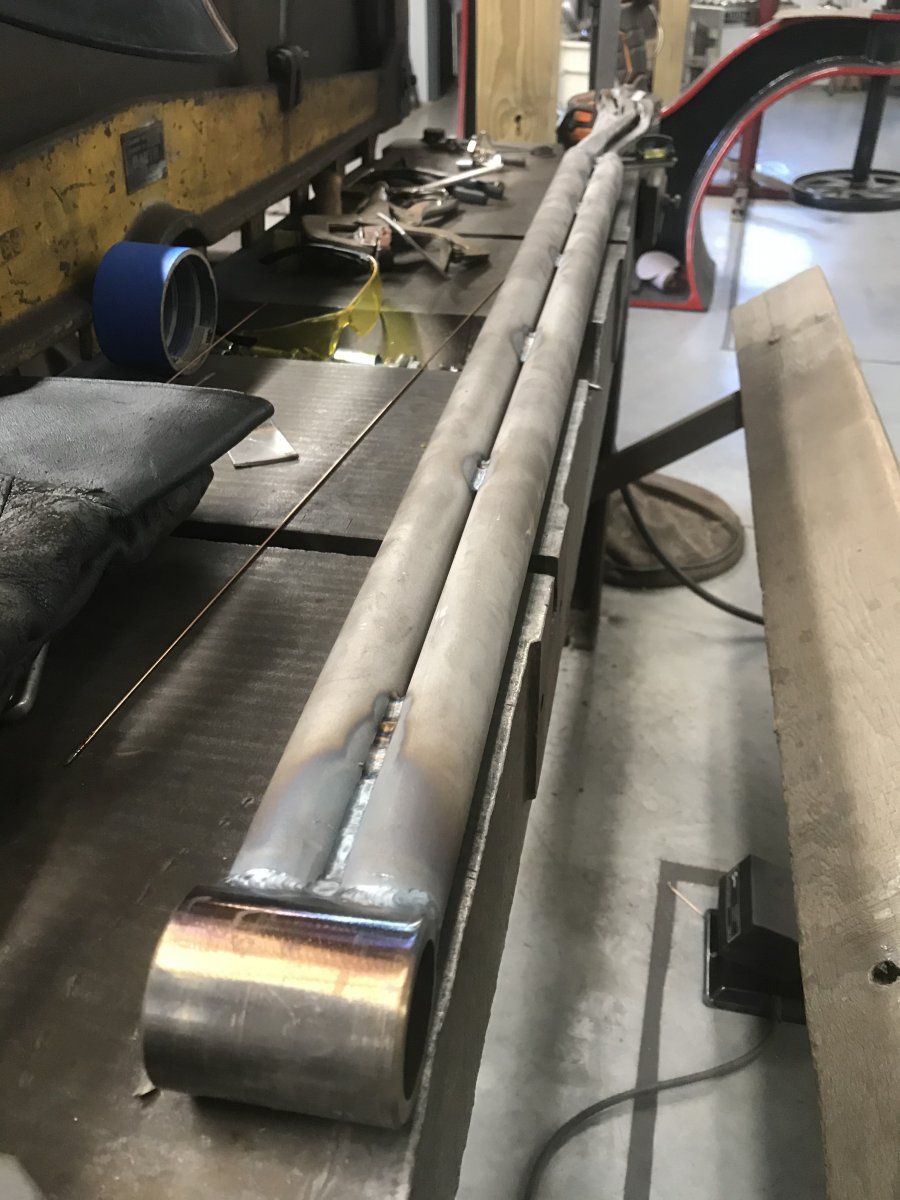

    The start of building my trailing arm rear suspension, I didn’t have room for hairpin out back . But I wanted to build a trailing arm out of Ford parts . And this is what I came up with . I know individually these rear arms are not strong , but welded together is another story . There not done yet as these are just progress pictures
    The 40 bells were to short short for my application so I had to go with truck bells , there going to get Torino ends and 9”Axel , HotRod Works is going to be doing the conversion , and Walden kingmount brakes

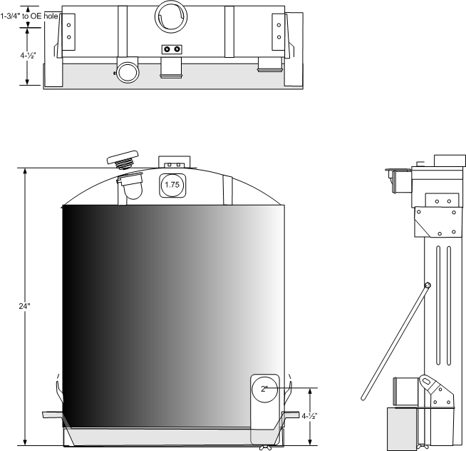

    Br***works is building the Radiator for me , since the rad and grillshell are down below the front crossmember this will fix my issue with the lower rad hose
