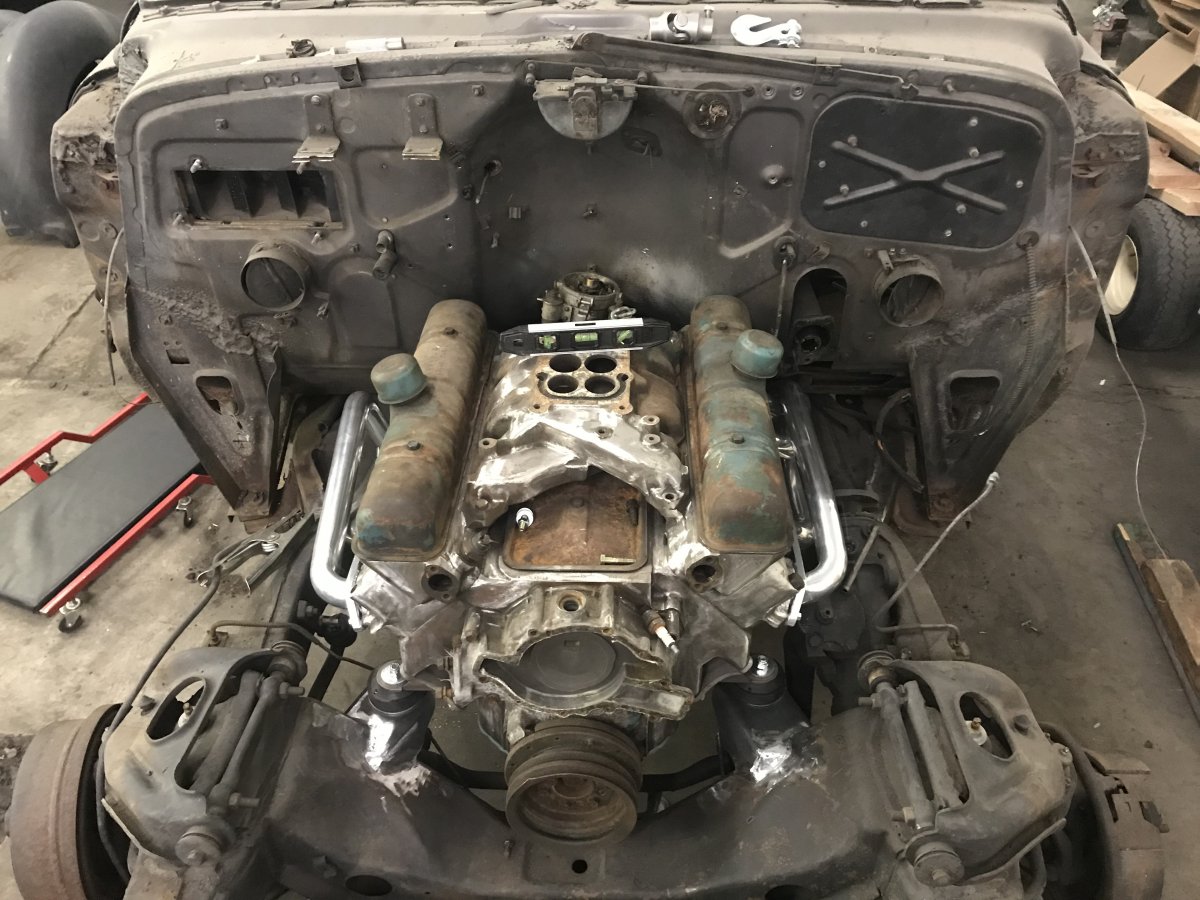

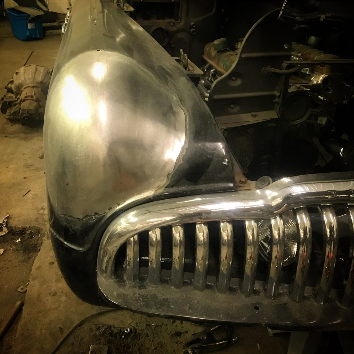

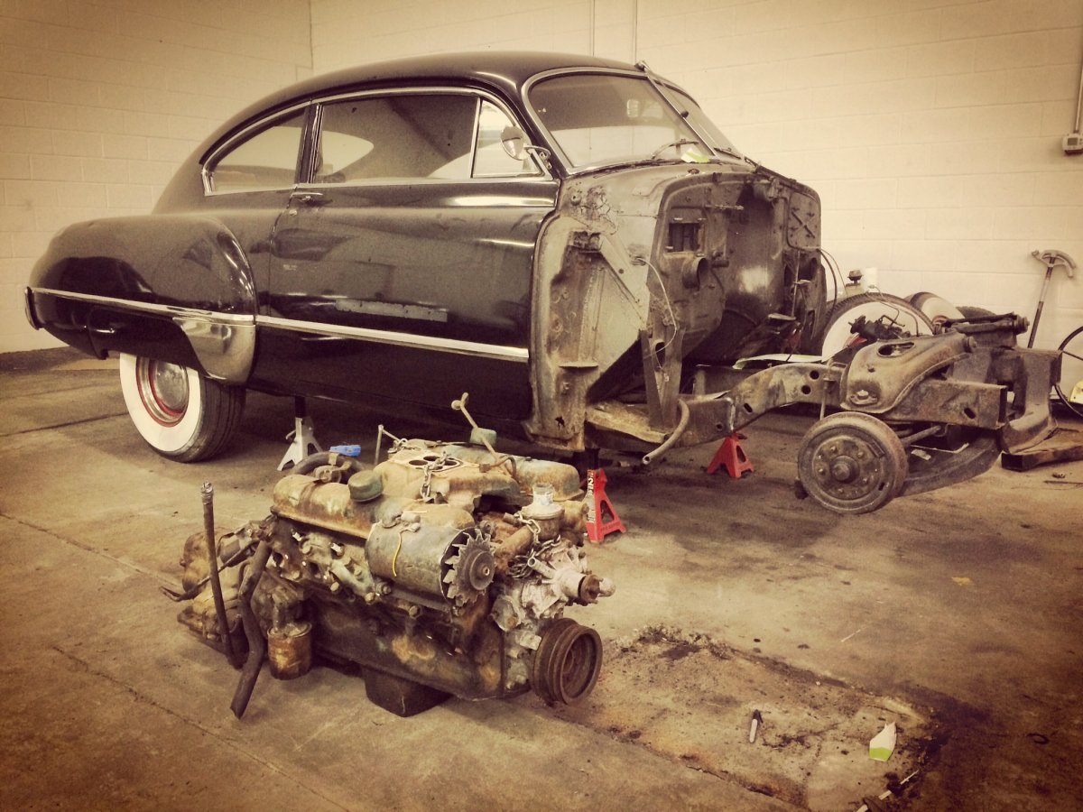

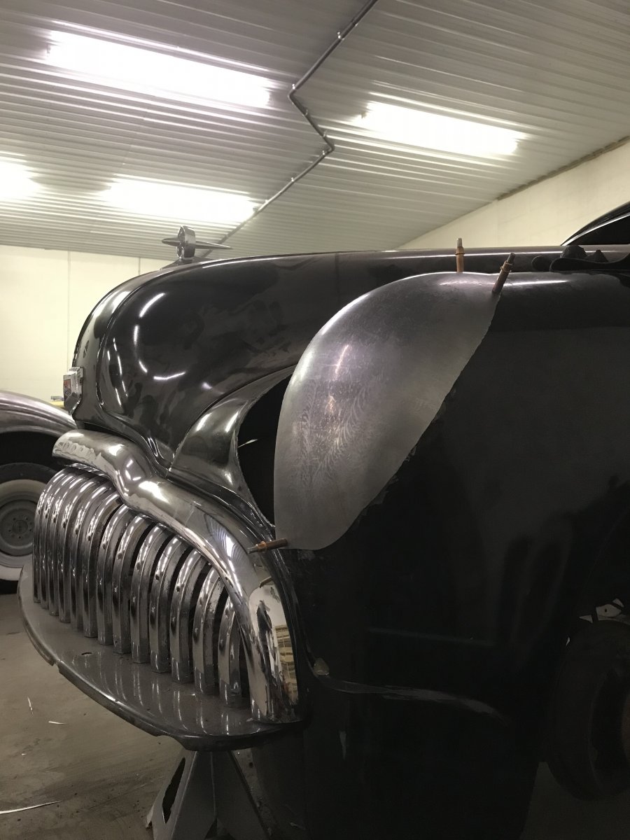

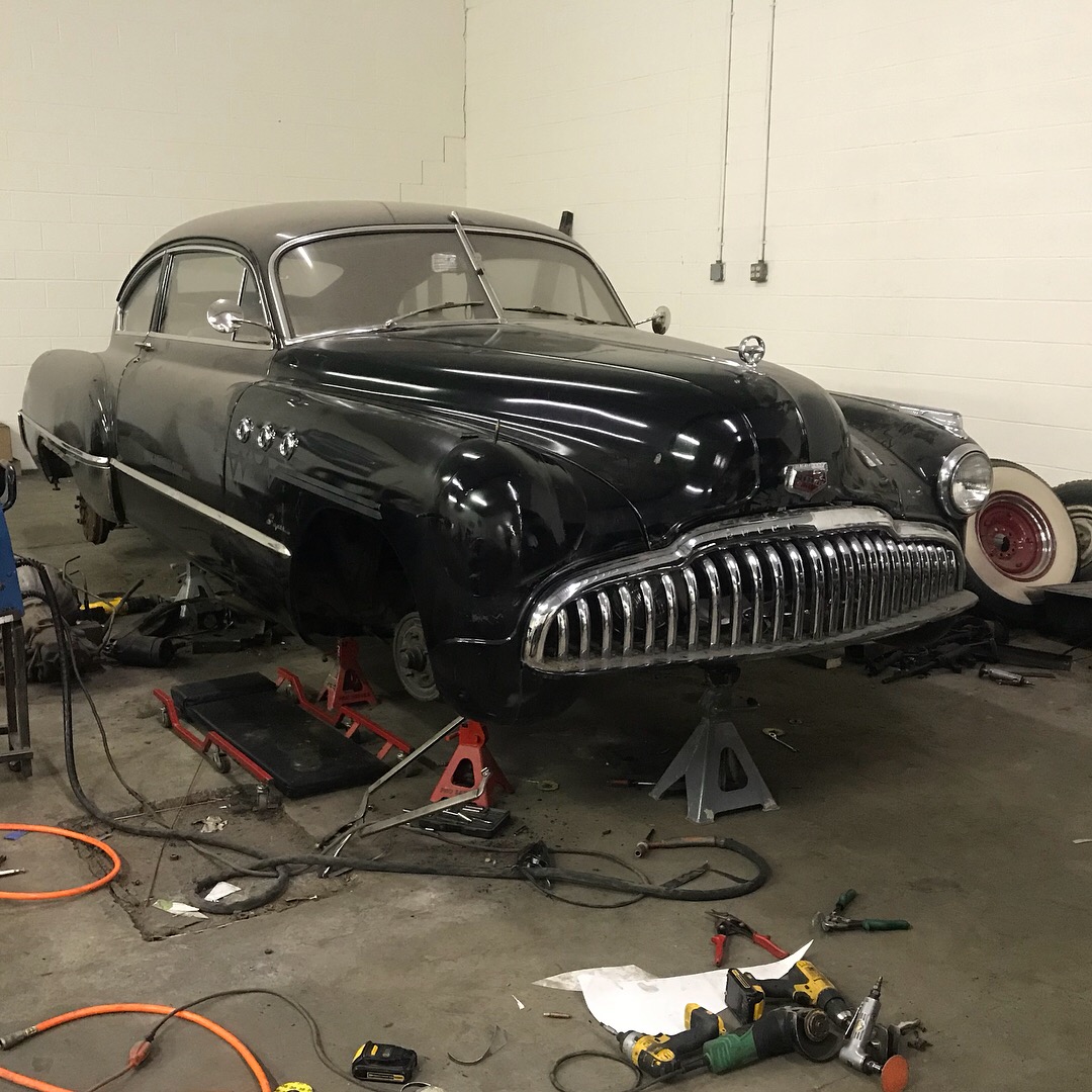

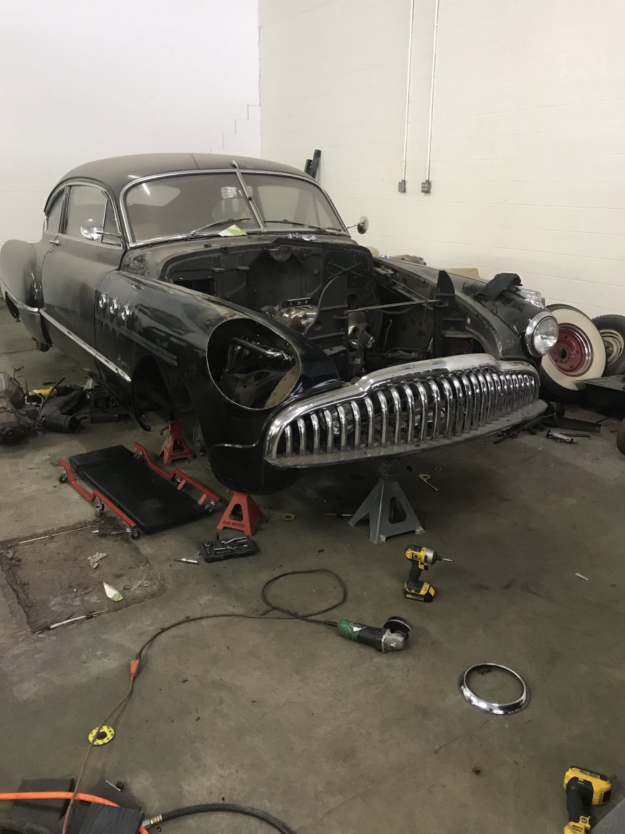

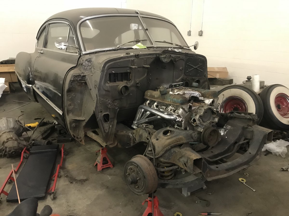

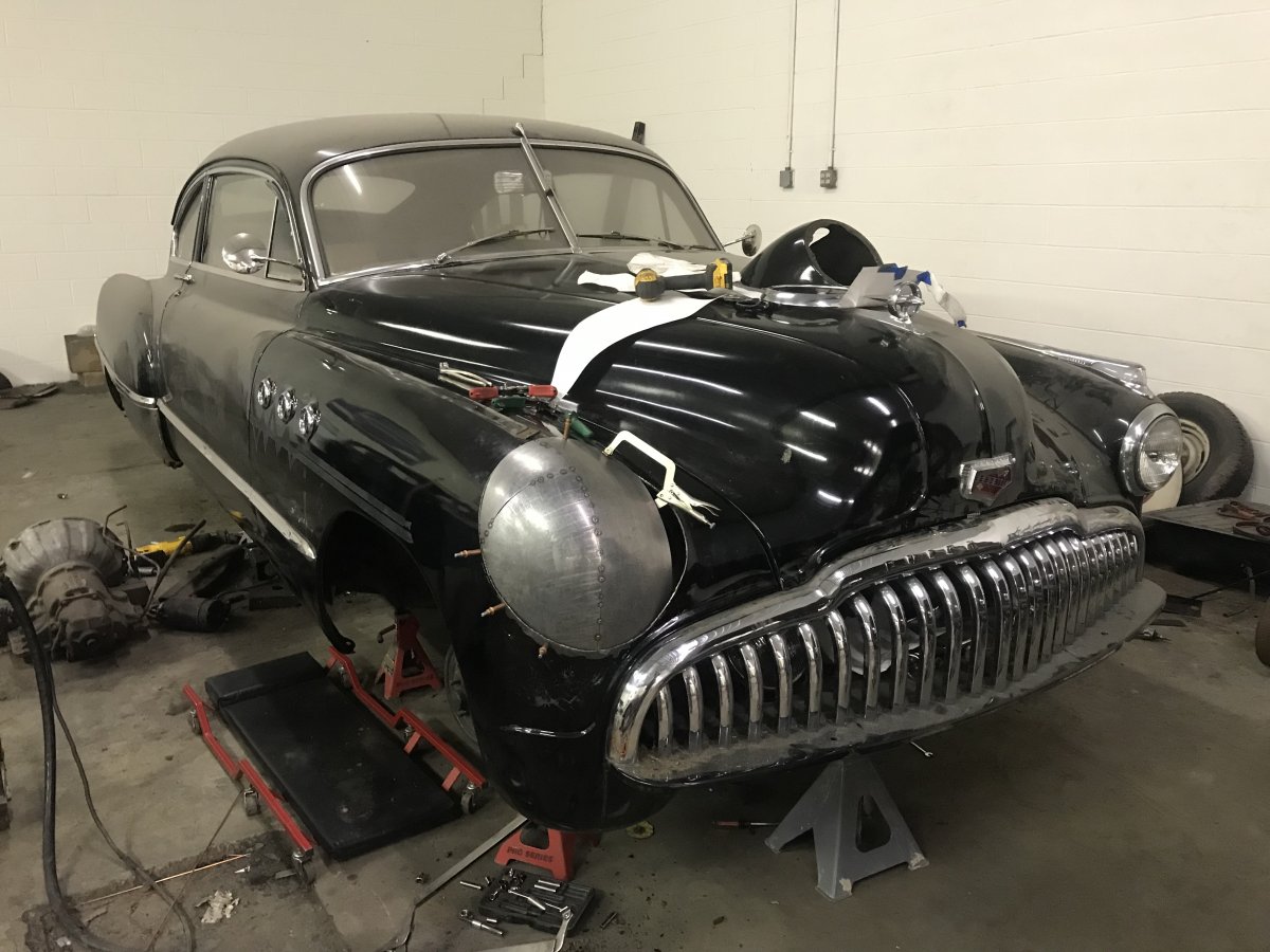

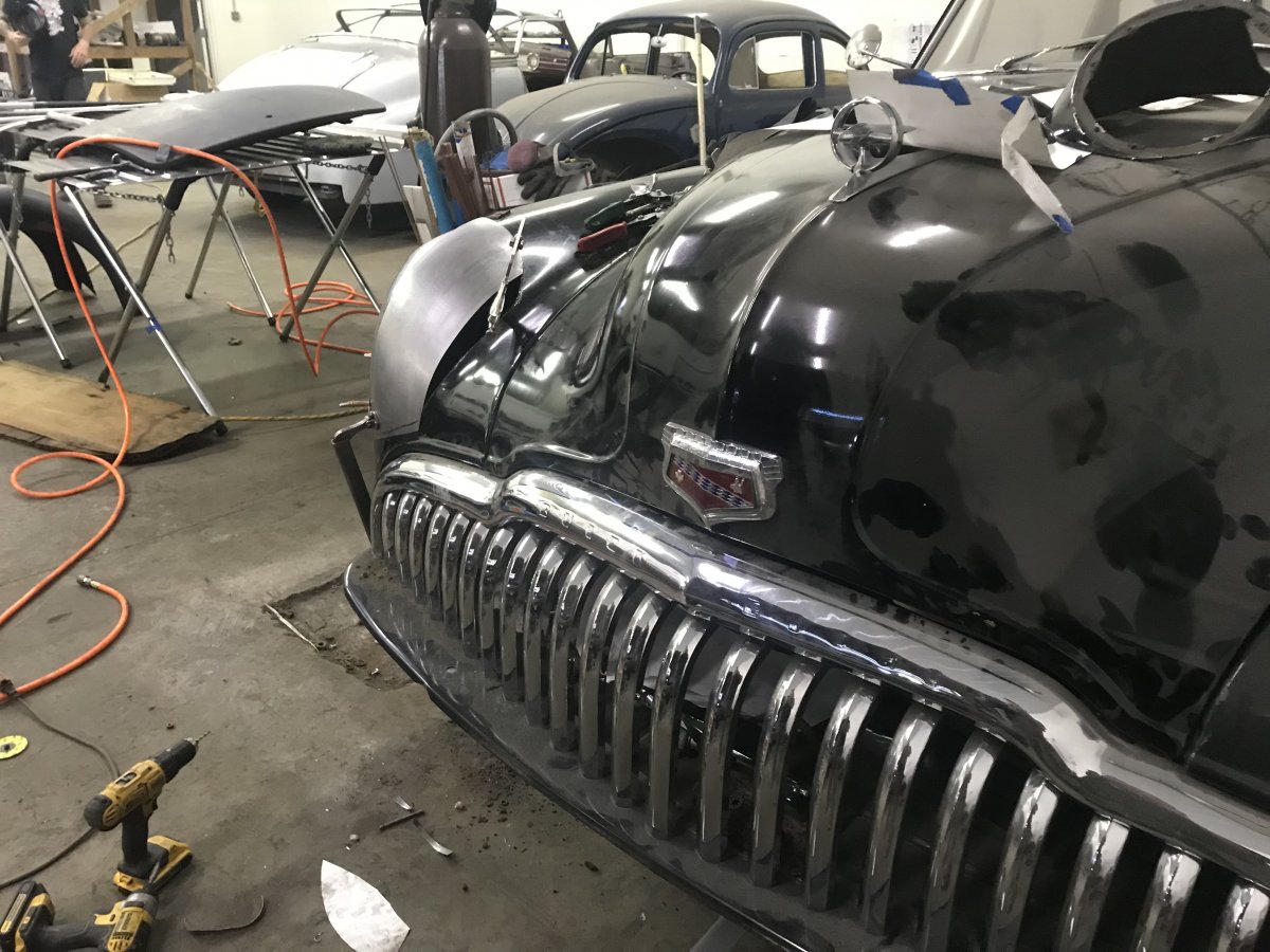

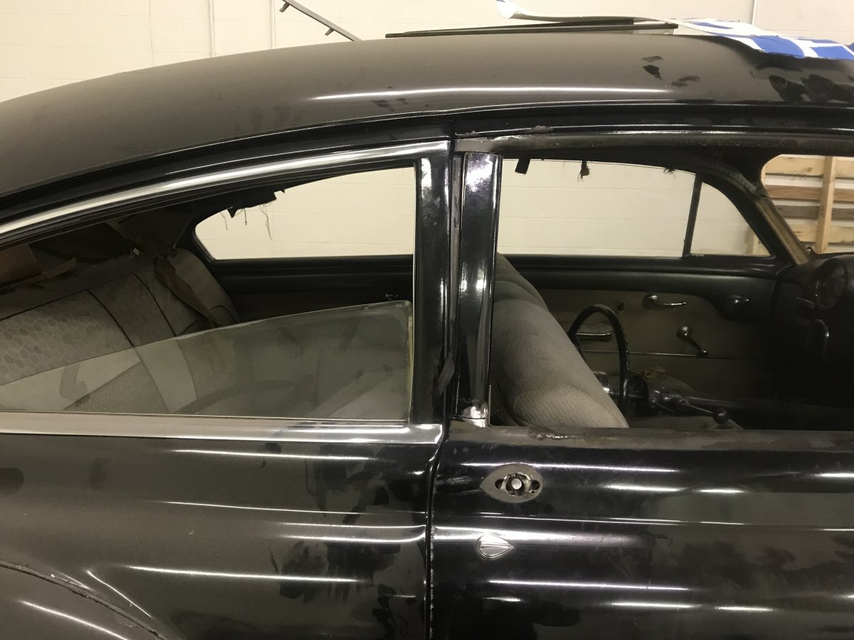

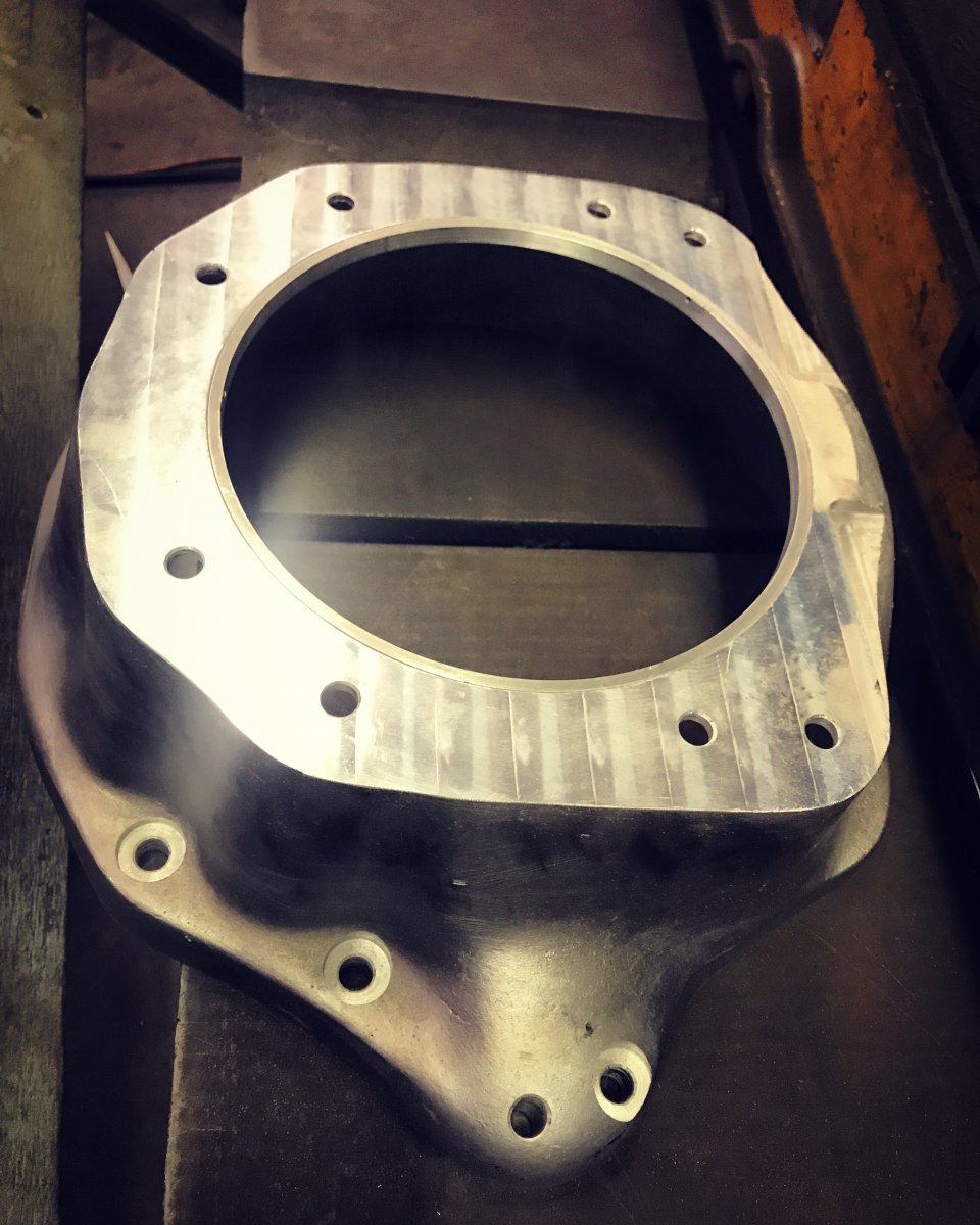

    B875555B-E56B-4EFA-834C-53B1D890B068.jpeg D1675BBA-E2F0-4F92-8497-F1CF3ACBDEB5.jpeg CBE87C59-FB96-4905-95BC-E4AA01028C7A.jpeg 4CB9383E-0917-43D8-AE8E-8ABB7E93AAC9.jpeg D6365E7A-DEC6-465F-A523-E076642D869B.jpeg So in my spare time away for all the builds I have going on in the shop I am also building my wife a car as well. At first I was going to build a mild Kustom out of her 49 Buick . A Larry Watson inspired car . But lately I’ve been kinda seeing a lot of people going that route so I’m going to go in a different direction.
    I know most people will not get this build and think I’m ruining a perfectly good car , but I like building different things , and I’ve always loved early Gm concept cars .the Buick YJob for example . so why not build a Kustom version of it out of my wife’s Buick. I’m running a Buick 401 nailhead that I swapped Curt Iseli for and he got the running original straight 8 out of the car, 4l60e trans , Camaro front clip , the car will be on air . And have some pretty neat stuff on it when it’s done . So stay tuned

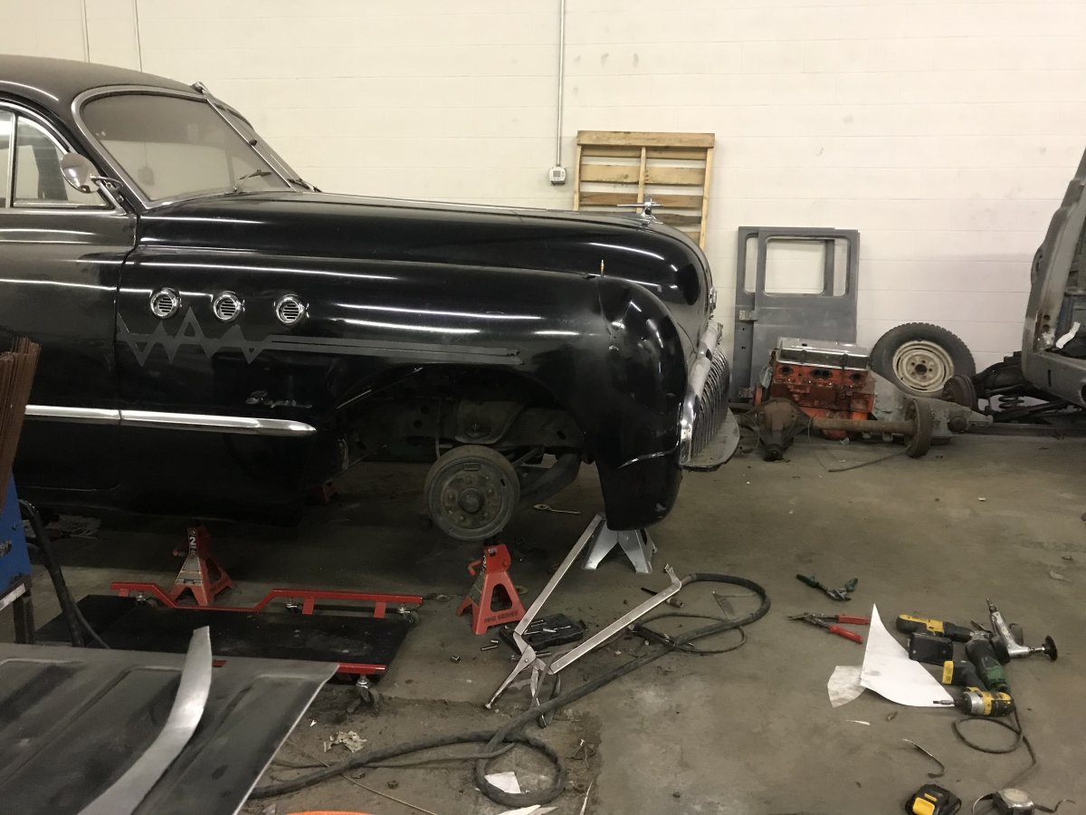

    Camaro front clip fitting like a glove . With going this route it gave me a 3" z'ed kick up just by installing it . Also the steering box is in the same spot as the original setup was . FFA5C3DC-2EB7-4345-B12C-374782BFE53C.jpeg 3E422142-6017-4FA8-A489-7F6DD8233943.jpeg

    I'm on board for the ride and can't wait to see progress. Looks to be a cherry Buick to begin with.
    Damn, I'd love to be that talented; what do you do now for headlamps?

    I have a couple trick up my sleeve I’m going to do with the headlight :)

    If you want cheap disk brakes and 5 on 5 bolt pattern, use 80's full size Cad spindles and rotors, calipers etc. Up to 84 works. I did that on my 49 in my avatar with a 79 Trans Am front clip, which should be the same as yours. Fits like stock, I used everything up to the TA ball joints.

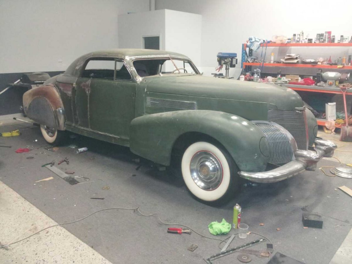

    0297D408-5584-4964-88D3-4711E7CB5CF4.jpeg Funny. A mate just tipped me off to your thread. Just this morning I dug out this old photoshop of my 39 and looked long and hard at the y job and Cord inspired headlight delete. I might have to watch to see what you do.
