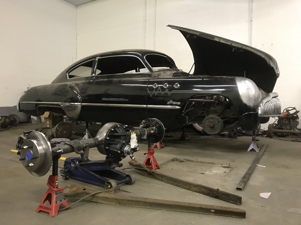

    3685A947-9BE5-4DE5-B576-AC16238492B2.jpeg 9210ED24-C830-4D69-99DF-B300EEFB2776.jpeg 898D8545-4EF8-422D-AA13-70F897E4BA63.jpeg

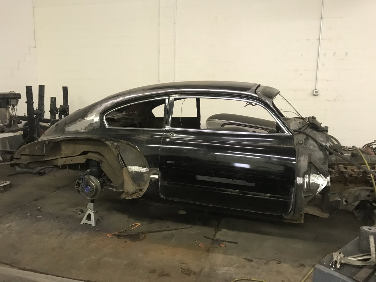

    I Found some time yesterday to work on the e job , started by setting up the new Currie rear and building a trailing arm setup out of parts offf of the old rear and I beam .

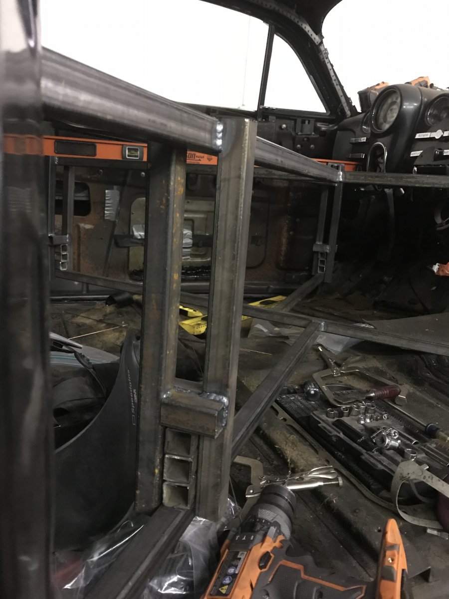

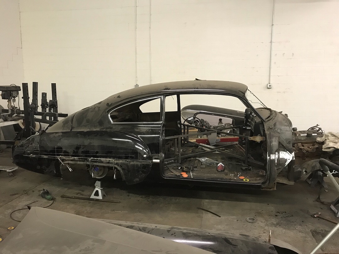

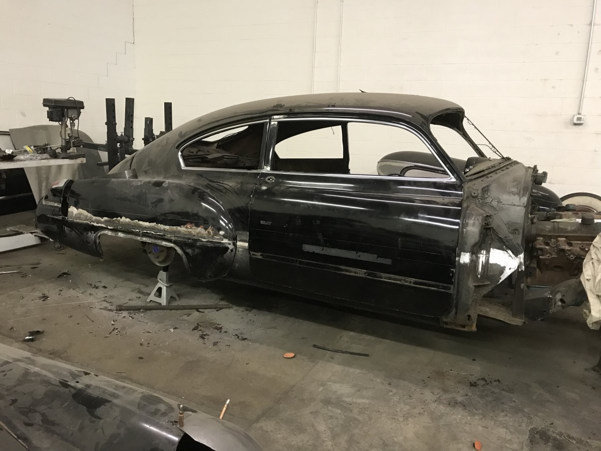

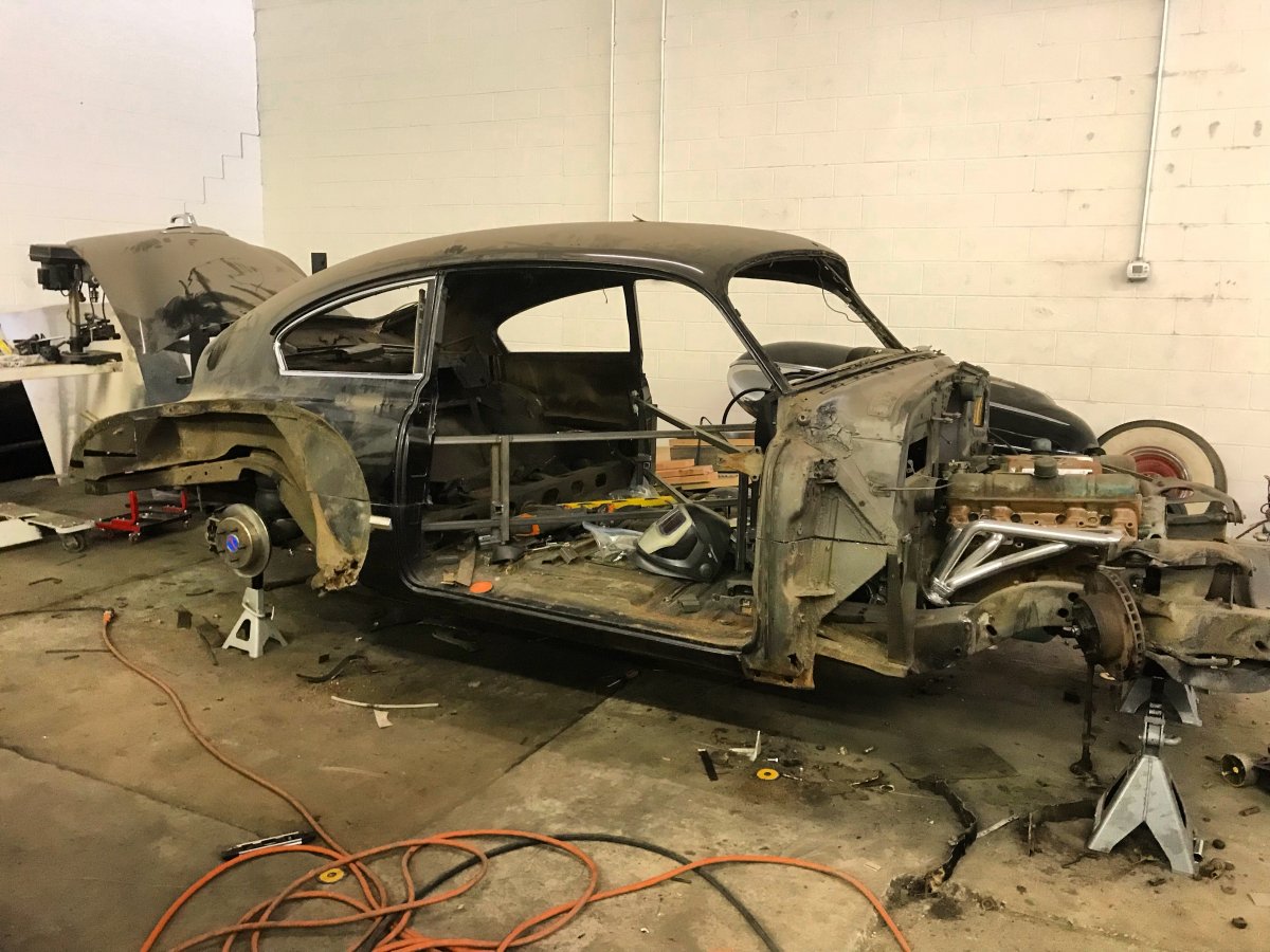

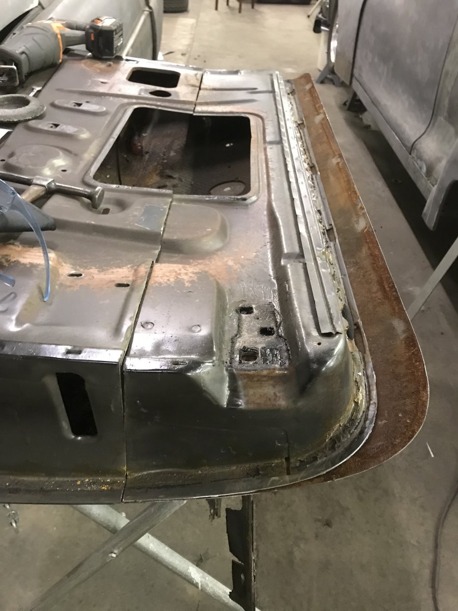

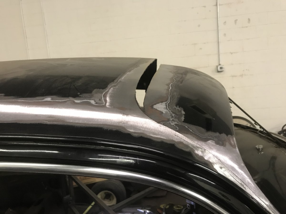

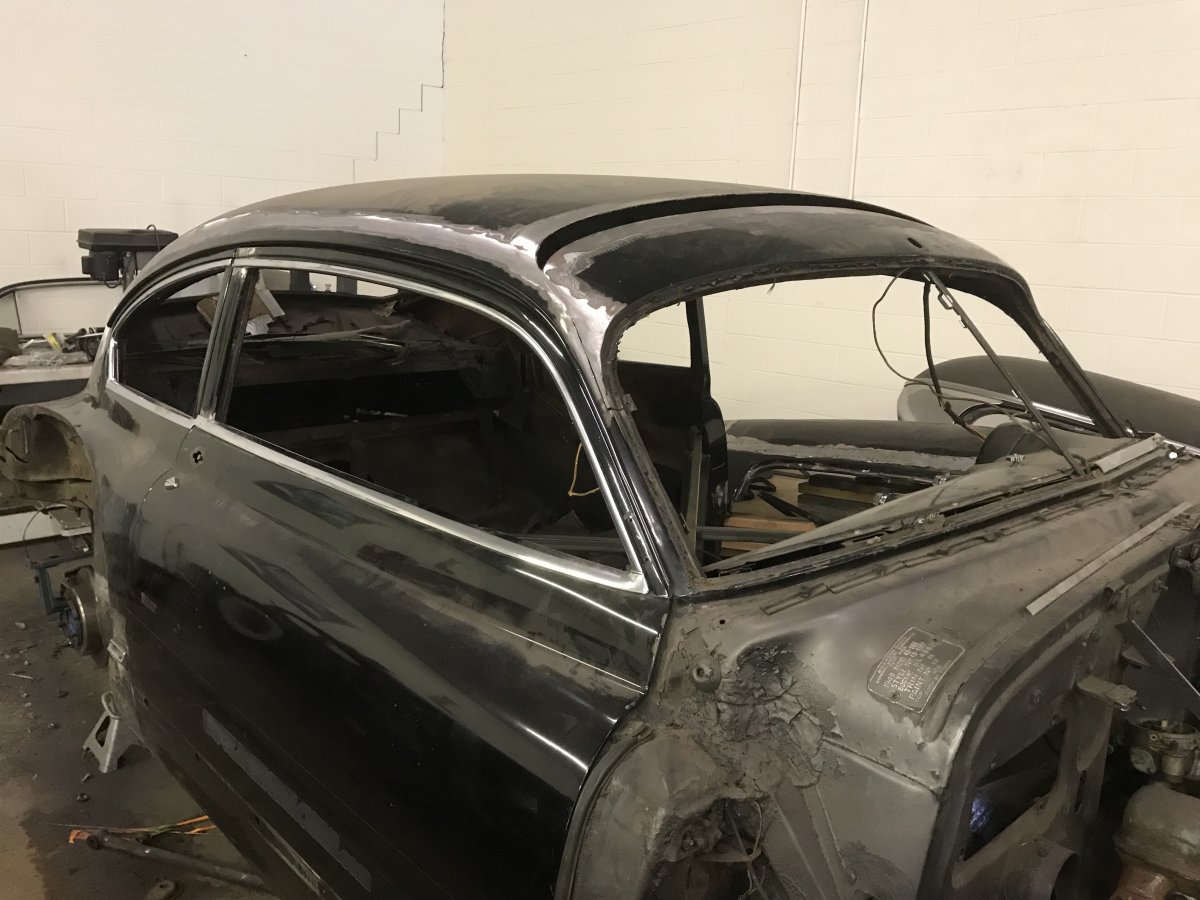

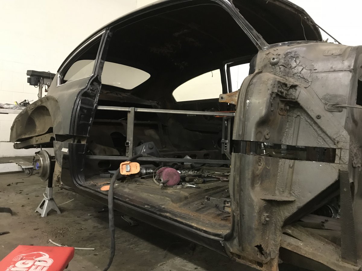

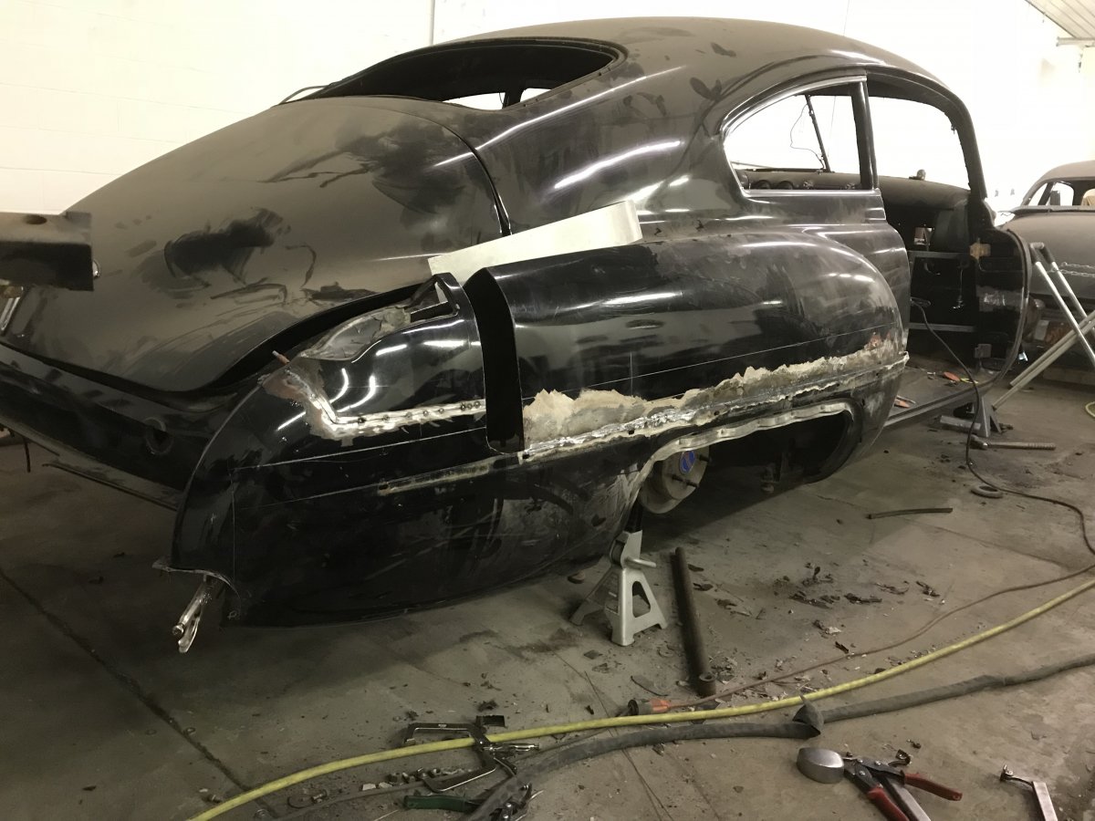

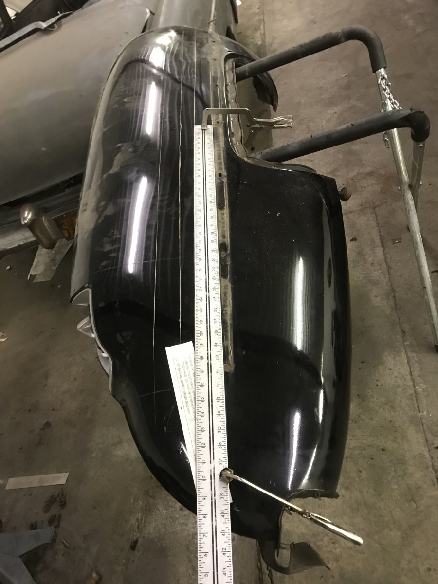

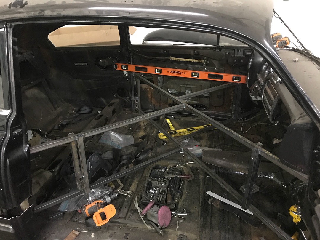

    D17F4D68-0AD2-4A03-B2FC-D2ABA0934F73.jpeg 60C98213-7E63-4CE5-A83A-427E8FFAFDD8.jpeg 9948A5A2-9B2B-4B70-B2C1-A0E27007A611.jpeg F377CCE4-B807-42C1-904E-C0D2618DF262.jpeg Saturday update........
    It seems like now days Any and everyone is out here chopping the tops on cars and No one is really sectioning them anymore ,especially the big cars . So let’s start the weekend off right by sectioning the EJob . My wife and my brother helped out tremendously by dissemble the car while I ended up making the internal bracing like a giant jig. So that everything will stay in place side to side front to back but can move freely up and down . Right now the bracing site on 3 1” tall square tube so when the time comes to lower the top part of body down I can pull the tubes out at 1” increments at a time and everything stay true side to side front to back .so stay tuned

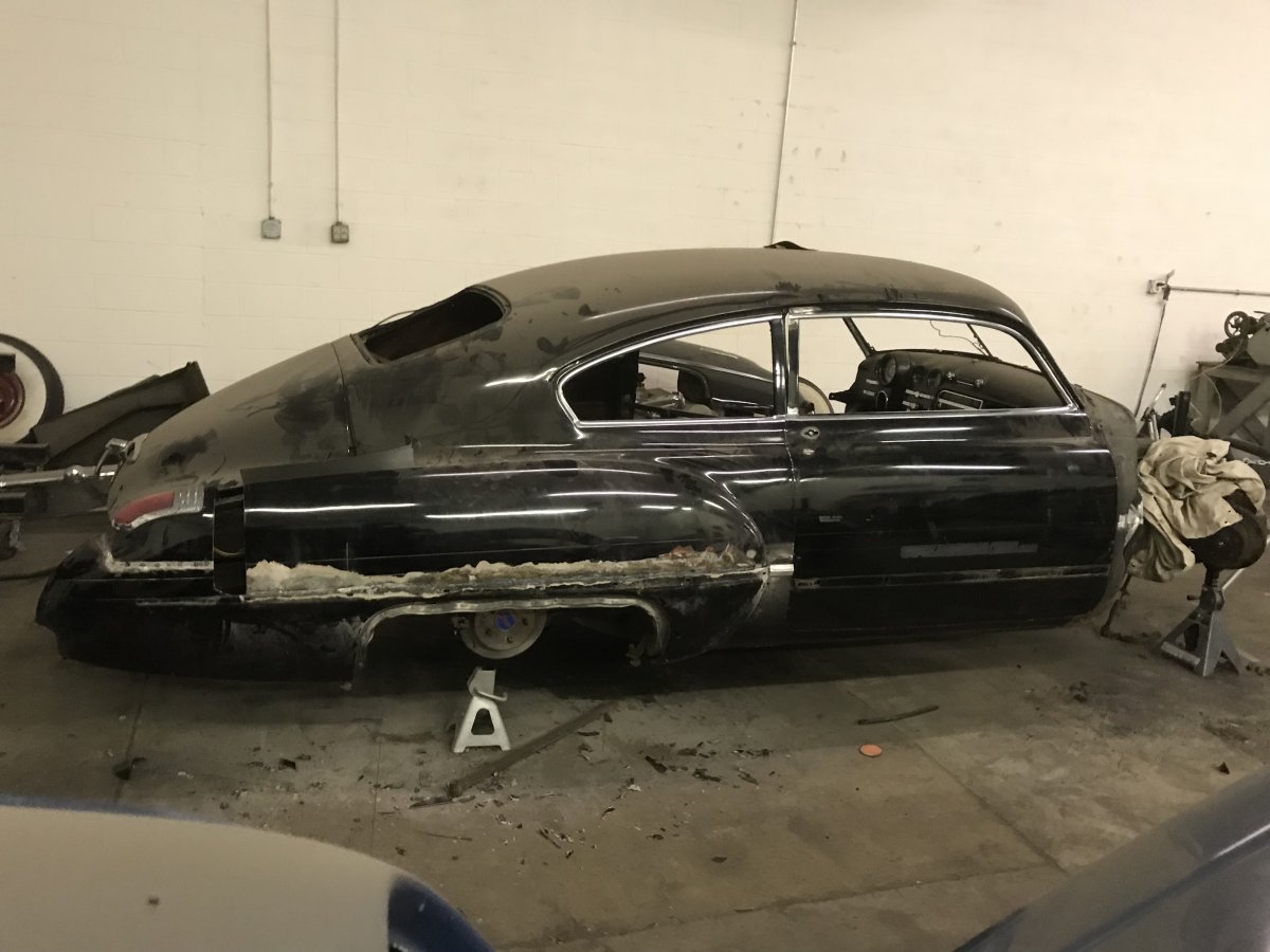

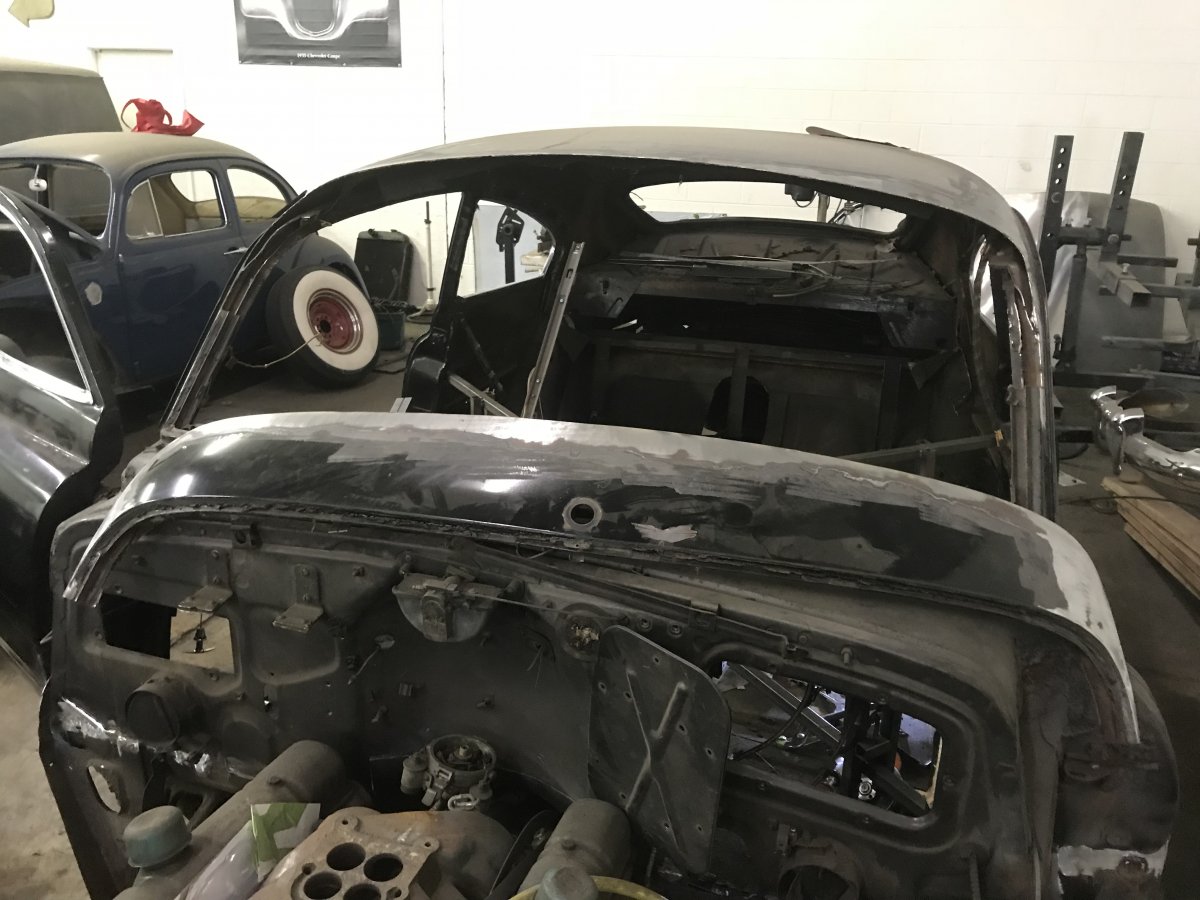

  11. Cody Walls
    Joined: Nov 14, 2008
    Posts: 1,574
    Cody Walls

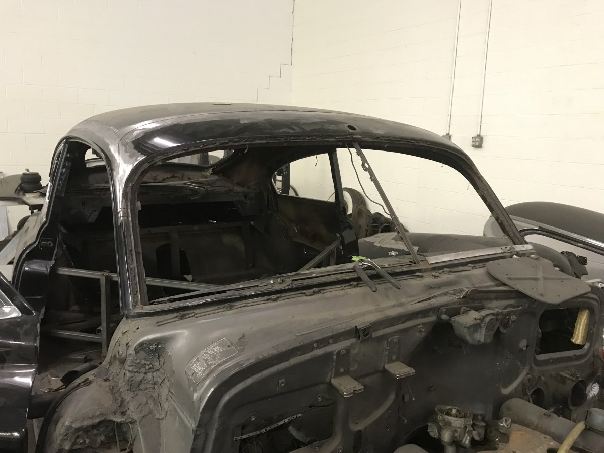

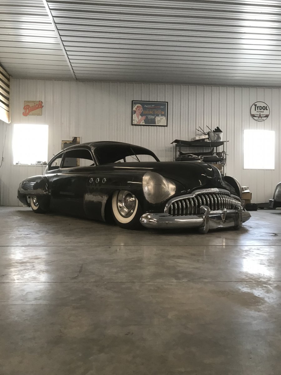

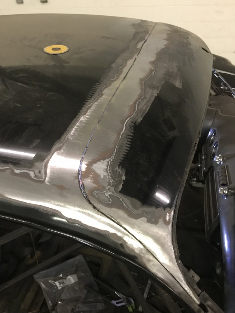

    Everything is cut and dropped it place . I’m really happy with the Proportions of this car , now onto hrs of welding and grinding . 06F3B1CE-F7A1-4E9C-ACB5-7EB8FFAC7226.jpeg

    I see you did the doors the right way, and not cut them thru the middle. How much did you take out of the roof line to get it down? Nice job along fo the ride. Frank

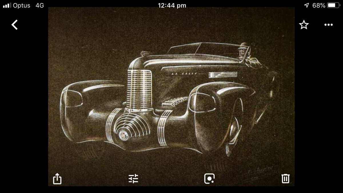

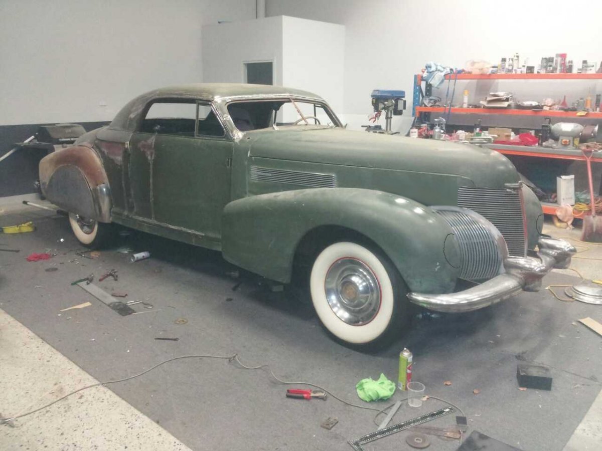

    Clever work on the doors and roof section. Here is some GM inspiration.
    Cody Walls, Stogy, loudbang and 2 others like this.
  20. 1-SHOT
    Joined: Sep 23, 2014
    Posts: 2,855
    1-SHOT
    from Denton
    A very futuristic looking LaSalle

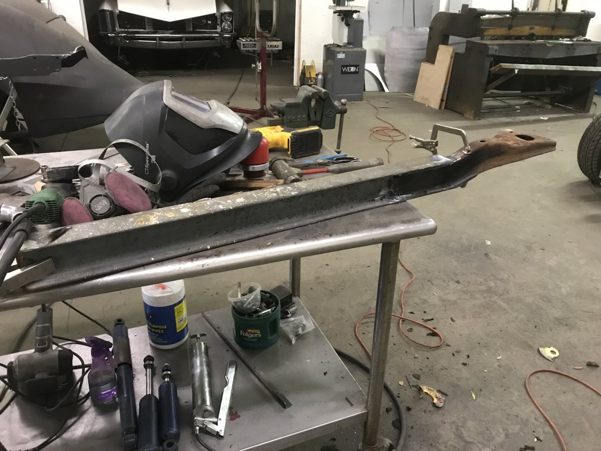

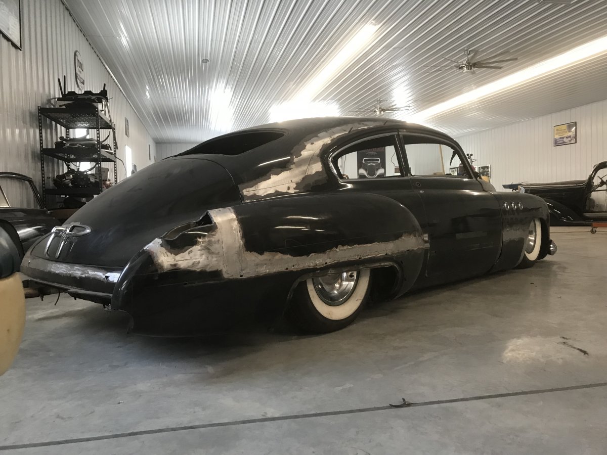

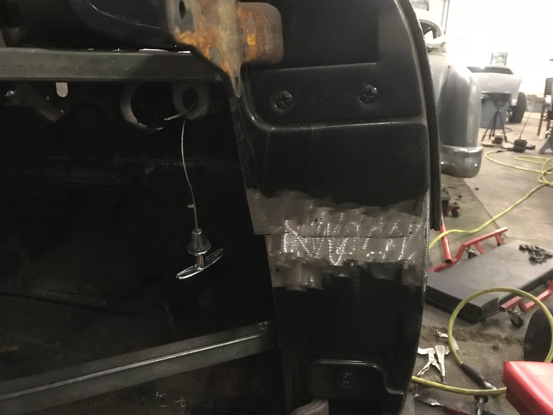

    1A5F148A-EFCC-47A8-9F4B-12CB6F7FFF35.jpeg 75FB4879-8E88-476C-B45A-6220D68AD250.jpeg
    Sorry it’s been awhile . I’ve had a new shop built, moved in , and today was the first day since September since I got a chance to work on the Buick
    Cody
