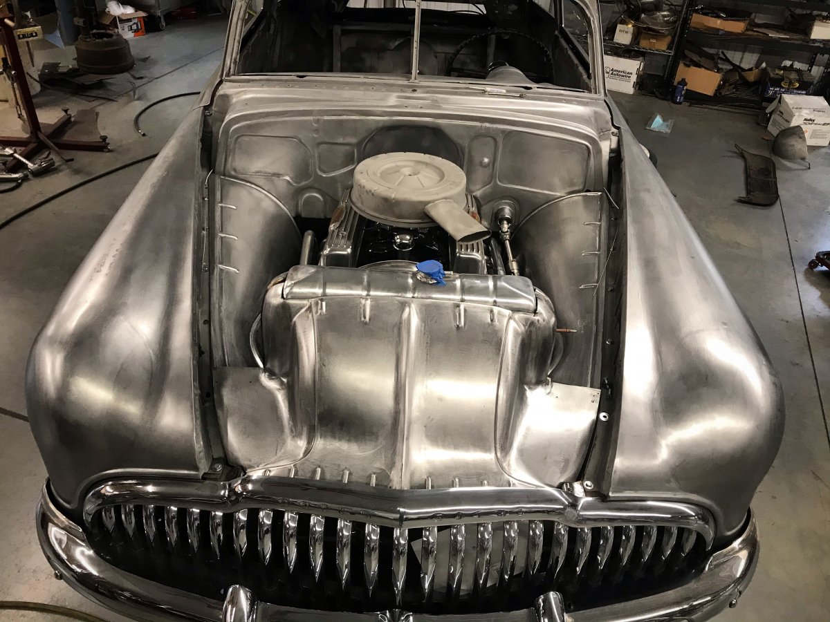

  3. Flat Roy
    Joined: Nov 23, 2007
    Posts: 533
    Flat Roy
    What an incredible build. A real beauty. You have been blessed with amazing skills.

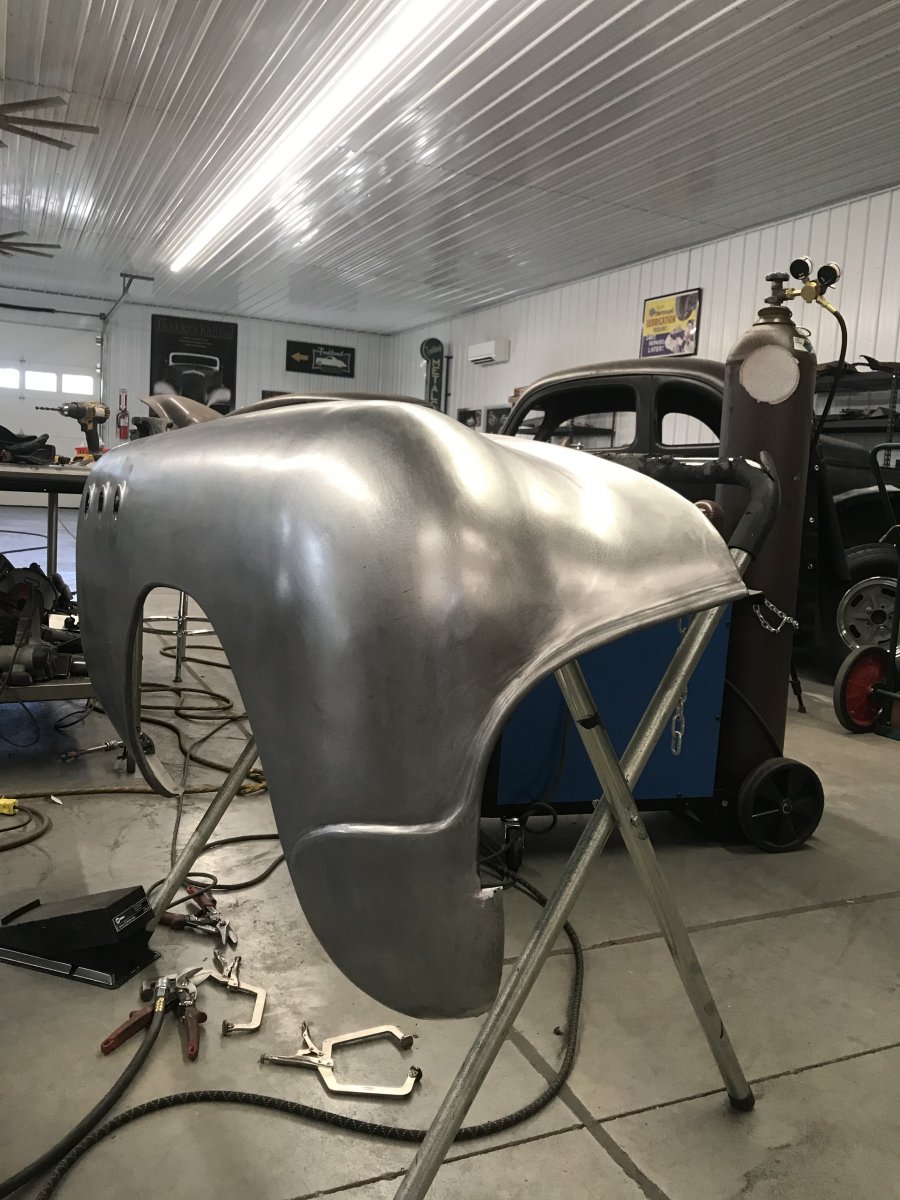

  5. Cody Walls
    Joined: Nov 14, 2008
    Posts: 1,574
    Cody Walls
    It’s funny you should ask , originally the b piller was leaned back 3-4 degrees, I leaned it forward 3-4 degrees and rounded the top . But without having a stock one next to it it looks like it should of came that way

  6. Cody Walls
    Posts: 1,574
    Cody Walls
    I’m using Tig er70s2 , .035 I look at metal differently than most people . Metal doesn’t warp . It’s shrinks or stretches . When you weld it shrinks causing a distortion . Once it gets stretched back out(hammer on dolly) it goes back to its relaxed state , something that can only be done with Tig or torch welding, something you can’t do with a mig

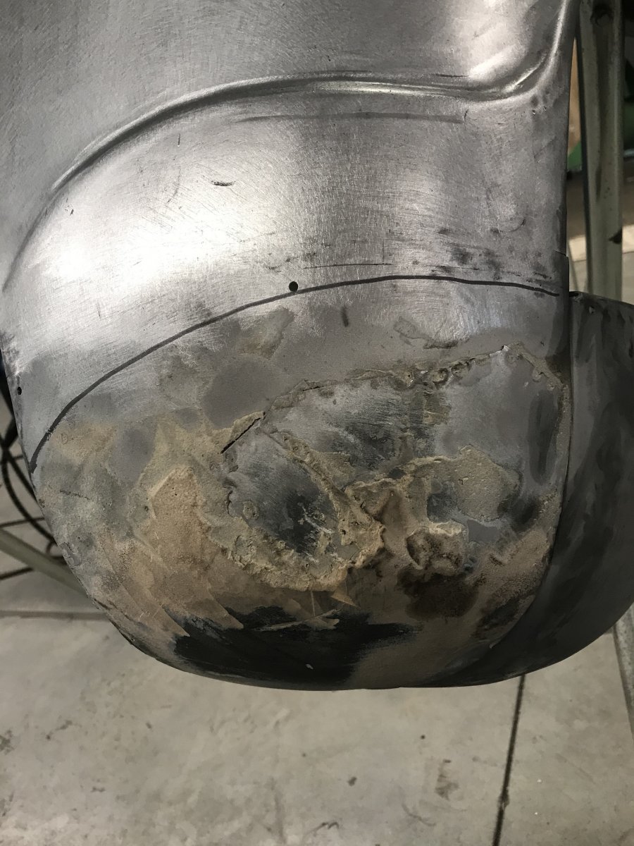

  10. Cody Walls
    Posts: 1,574
    Cody Walls

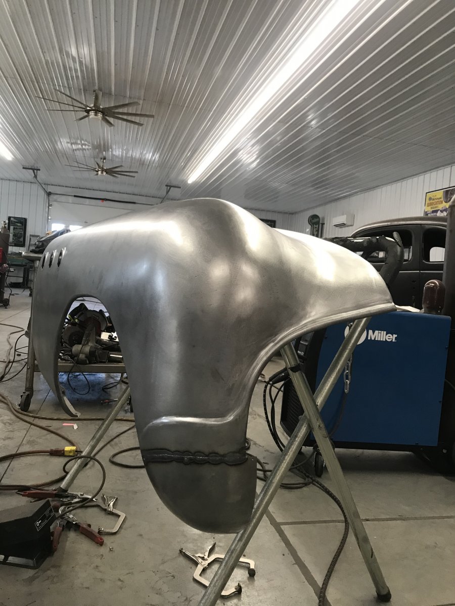

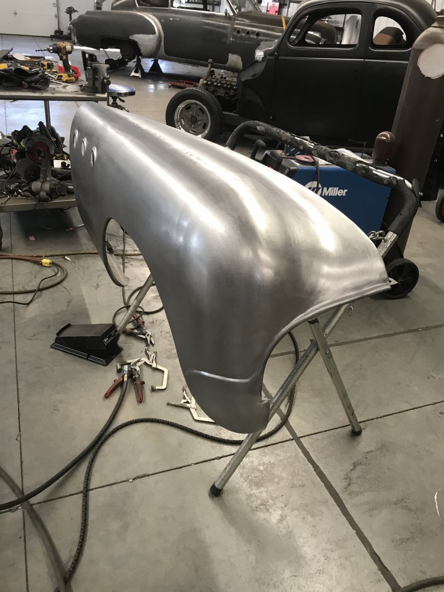

    metal finished the front fender as well as fixed to rotted out area on the front bottom

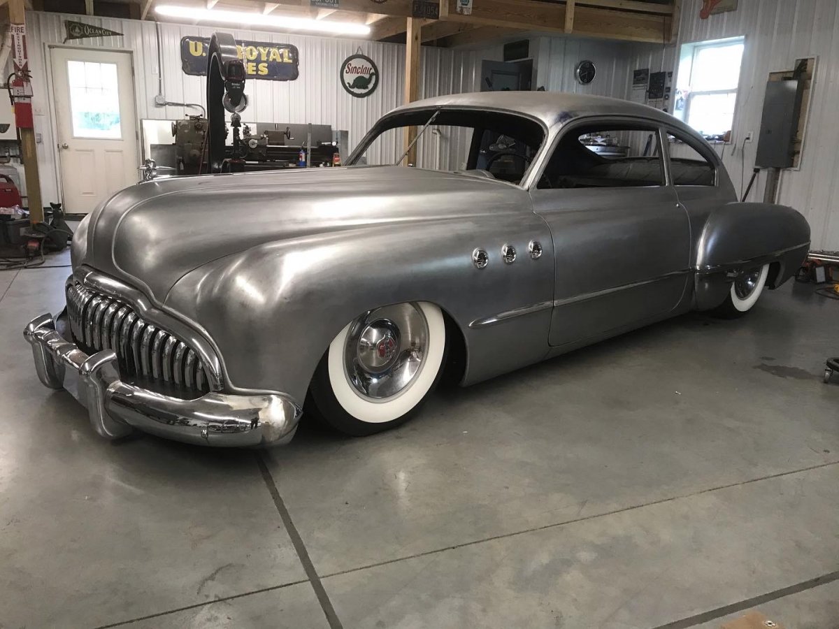

    Linin' up ribs with bolts, grille teeth and radiator grooves is just rubbing it in our faces @Cody Walls. :D Looking fantastic as always!!!!

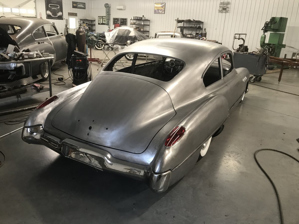

    I love the little trick with the taillights, moving them back, to get rid of the step in the fender.

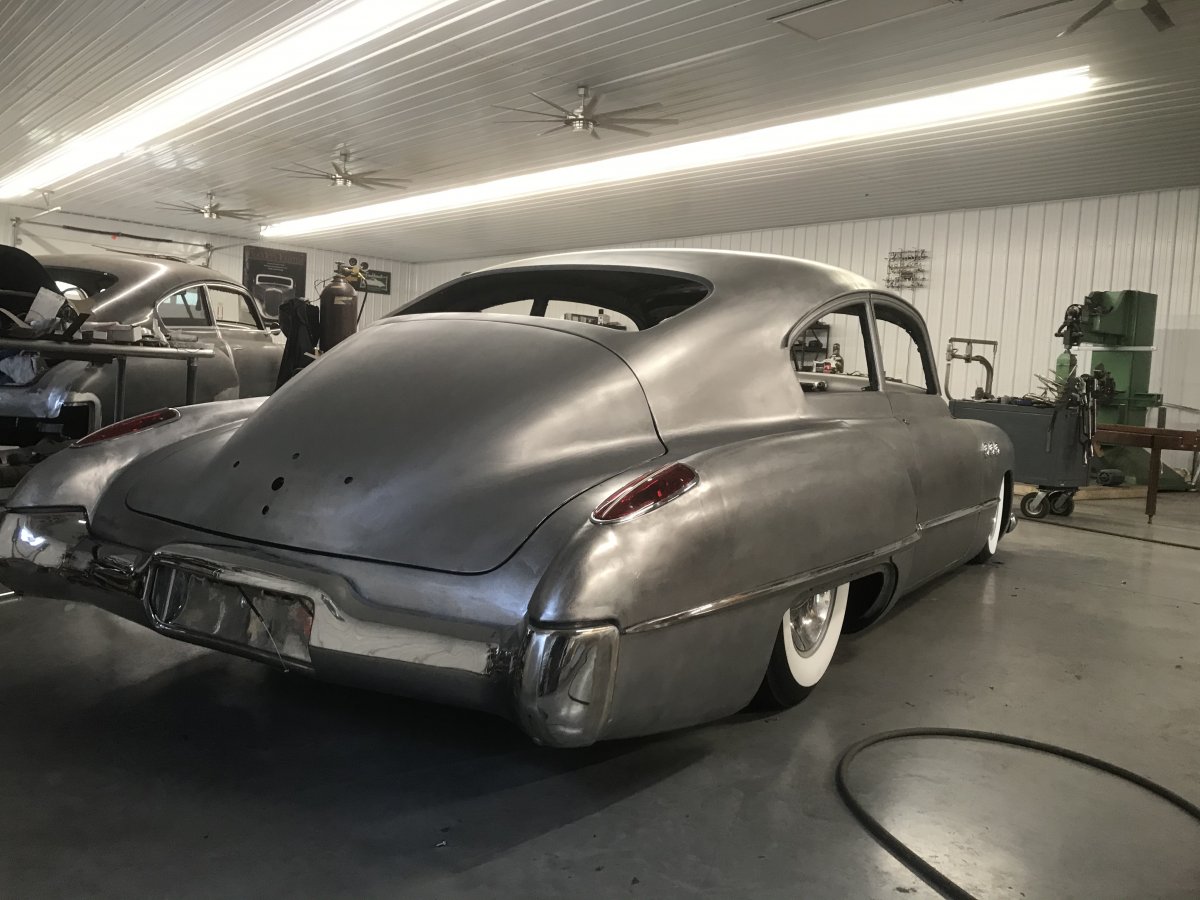

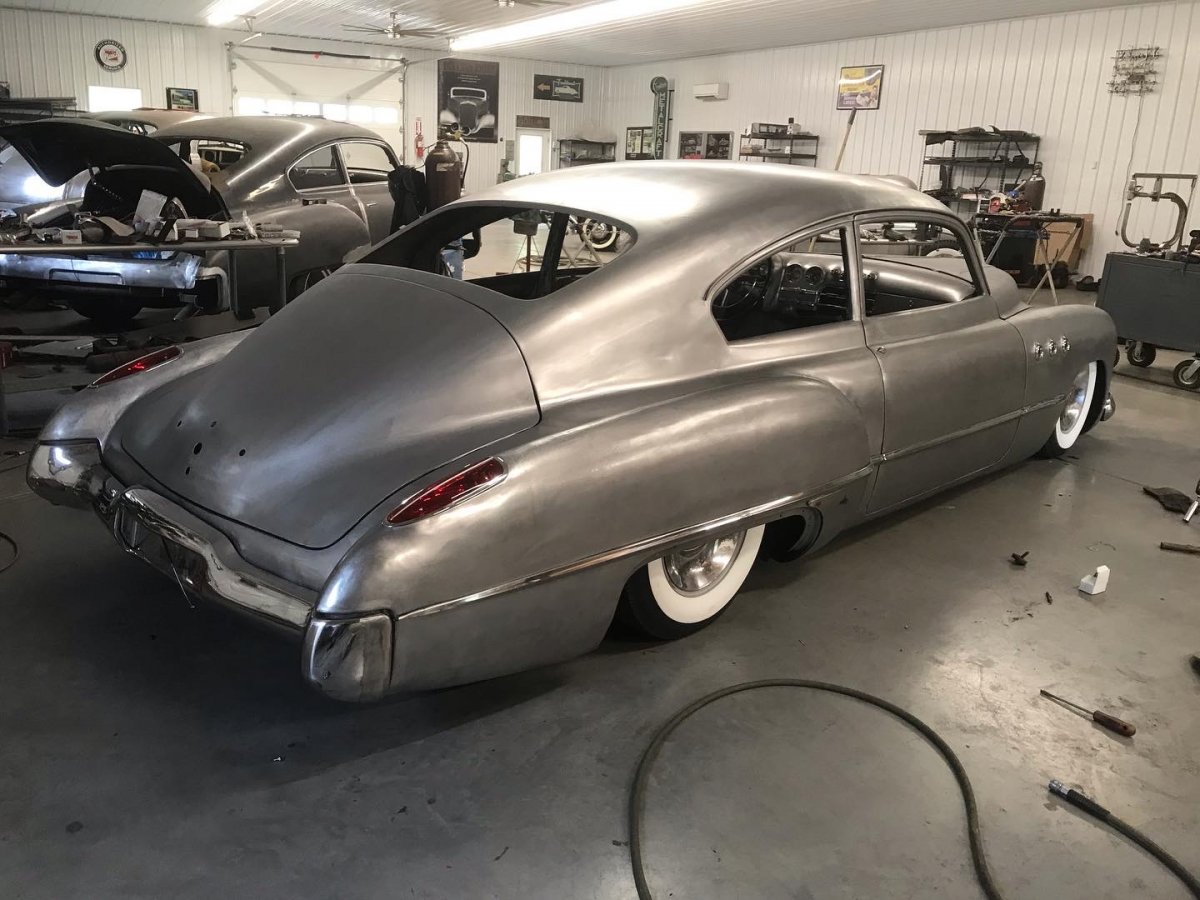

    Posts: 1,574
    Cody Walls
    D1A02981-D8C2-43F1-92D0-72C4EA1296DC.jpeg 1DD5864D-4C50-45AF-BB67-E4425BA46116.jpeg 047B2E25-F003-4F0B-9CD9-3A0D96E3DBF9.jpeg A1288C68-BD70-47AA-9703-4791E7D2A26C.jpeg 76496DE9-7873-4FE1-91B4-7BEC82B34968.jpeg
    Ready for the Jalopyrama
