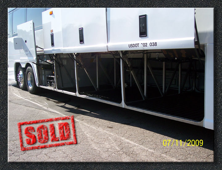

  24. Here is a pic of the MCI system
  25. kscarguy
    Joined: Aug 22, 2007
    Posts: 1,612
    kscarguy
    Thanks for the pictures. Perfect timing as I am working on the gas strut design. On the bus pic, it looks like the gas strut is mounted on the inside of the bottom arm, that means when it is closed, the strut actually rotates past centerline and tries to rotate the hinge inwards (very slightly). This is good to know.
    The struts come in various sizes and strengths, so I stopped by NAPA and the counter guy copied the catalog pages for me with all the specs (lenght, force, etc.)
    Since they come in various forces. I will have to weigh all the door parts and based upon the cylinder mounting location, calculate how much force is needed to hold up the door...I think I need my statics engineering book for this one. They are just too expensive to buy and try.
