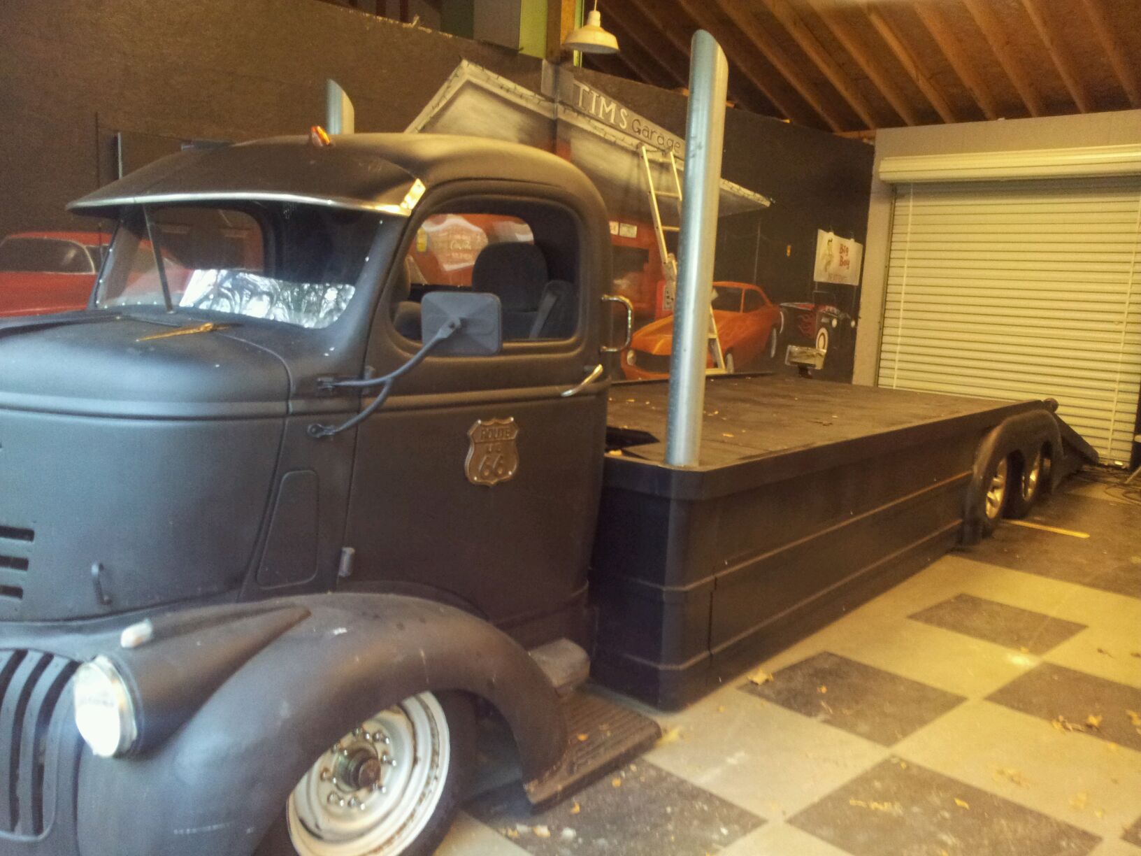

    I am playing with ideas for extending the box and making the transistion to the rear tires feel less abrupt...
    It would have a curved raised edge to match the front fender...
    It might be easiest to make it from fibergl***...

    here are some pics of my chev coe. I am sending them to you so you can see what pickup fenders can be modified to look like you want. Your truck looks sweet.
