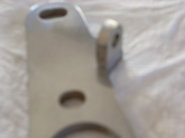

    The new bushings to mount the hinge arms.
    The hinge rotates on the small diameter. The short stub will fit inside the cross pipe and locate it.

    Spent much of the day drilling and tapping a gazillion holes. I made more chips than Frito Lay. I bolted one hinge together and it workes great. The alignment is dead on too. It is still missing the nylon washers (on order) but even "loose" it feels really good.

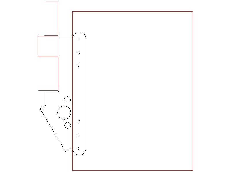

    I did try to design some box mounting brackets. My goal was to make them look like they were built by Henry Ford, but they also need to function. This bracket is meant to be welded to the rear axle front spring hanger.
    I am open to any and all ideas...
