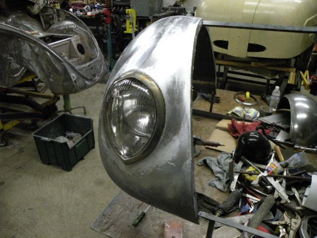

    This is a set of 41 Ford COE front fenders I am building for a customer Danny.

    Very nice; the mould-in headlights will be a knock-out......What's the process, mig or tig, then finished with lead?? Looks very original..

    If you were asking about the 41 COE fenders What you see is actually a pattern for the final shape design. My customer is coming up from Cal next week to do a final look at & approval. Then we will start making the panels. All hand formed steel tig welded in & metal finished no plastic here. On the underside I will make a molded pod to cover up & protect the bucket's on the inside. The side wheel well opening are being re contoured to give them a art deco look this thing will be slamed The idea is to make them look like a stamped quality fender when bare Danny.
