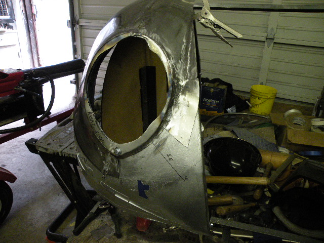

    Here is a shot of the 41 Ford coe front fenders I am building with 37 38 style head light buckets Danny

    Are you using any solder around the right side of the headlight bucket, or is it
    all TIG?
    (Suggest you post pics under the "Let's See Some Metalshaping" thread for
    better "exposure". Nice Work!!)

    36 Rokit the panel is just sitting on top of the buck in that picture I will cut out every thing underneath. Tig in & metal finish I posted some early build pictures in it's own thread but nobody seamed interested in the progress so I just dropped it Danny.

    Here is some update photos of the reworked 41 coe front fender's I am working on Danny.

    Todays up date on the 41 COE front fender I pretty much finised welding the head lite pods then ground the weld's inside & out. Next I did quite a bit of hammer, dollie, slap work then did some finish work with the shrink disc. next area is the front lower chins into the reworked wheel arches what do you think Danny.
