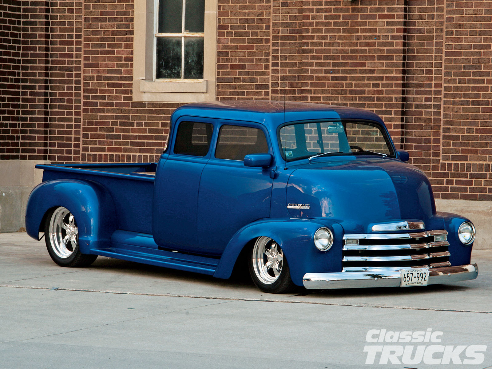

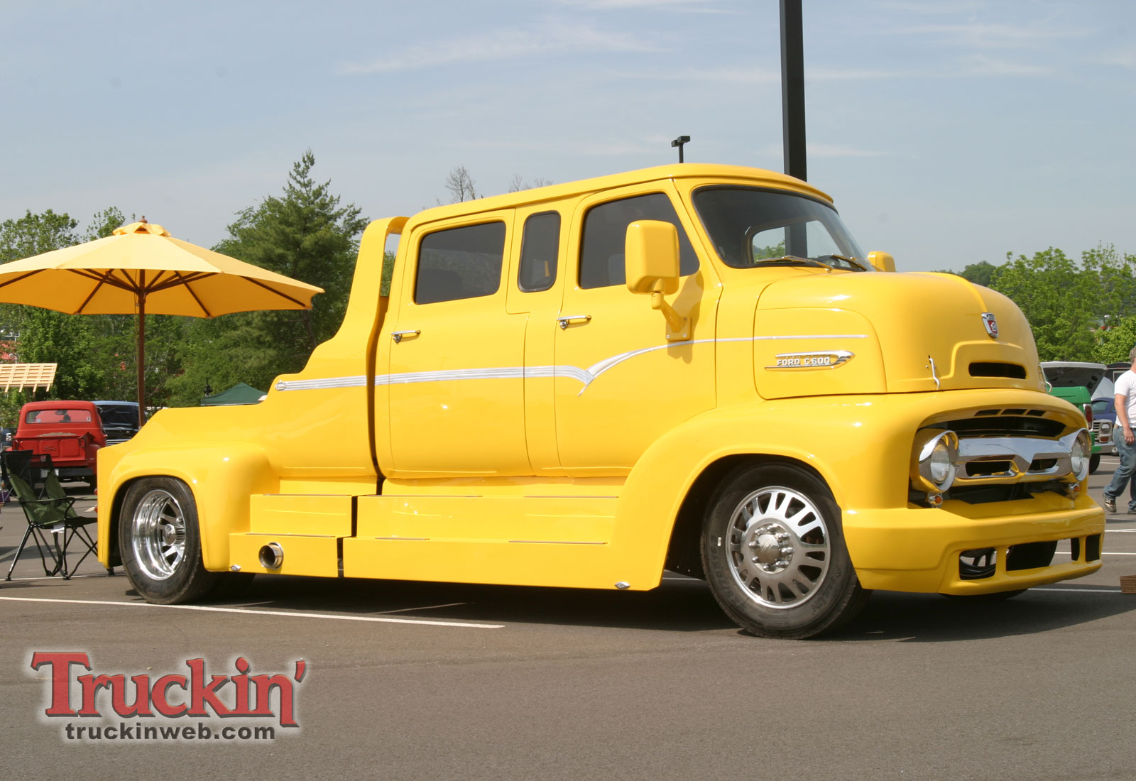

    quick Google search
      460.1 KB
      128
      12.8 KB
      118
      257.1 KB
      106

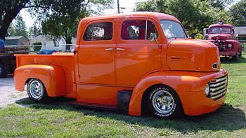

      27.1 KB
      104

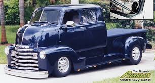

  6. hdman6465
    Joined: Jul 5, 2009
    Posts: 662
    hdman6465
    [​IMG] Here is my 48. Extended 28 inches.
