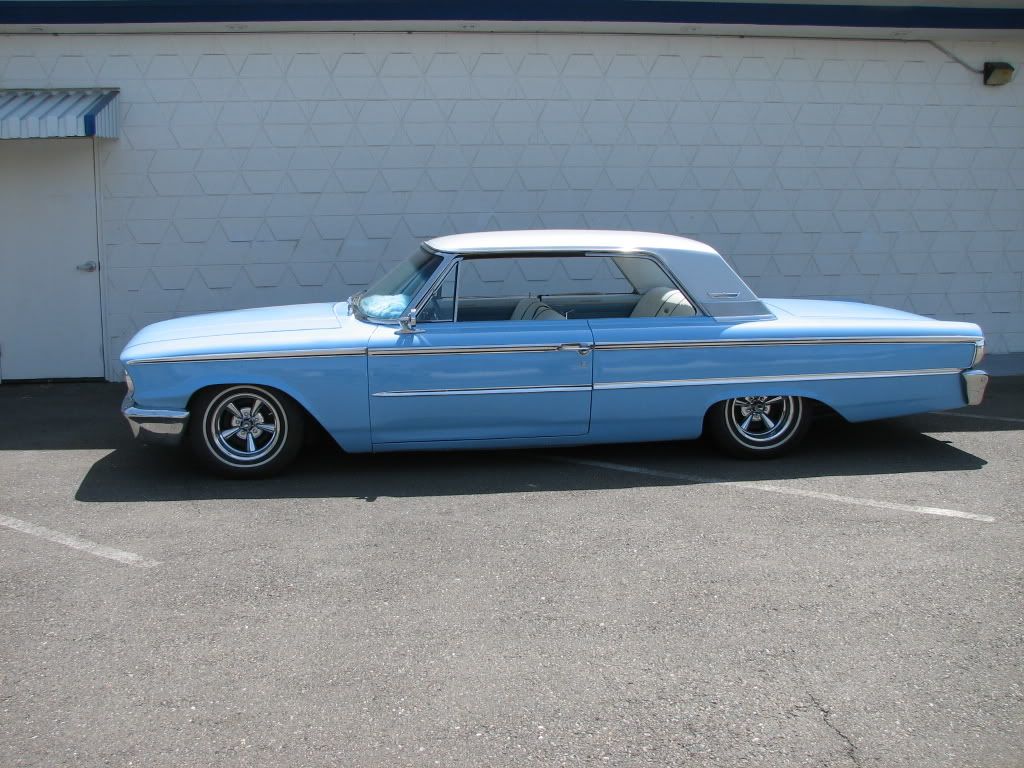

    I'd like my car's stance to be similar to sleeper's 63.
    http://i174.photobucket.com/albums/w88/phantomsdib/Picture001.jpg

    well one coil is one coil...360° is one full circle..ie..one coil..I took 1.5 coils out of my 53 chevy it looks good it lowered it around 2 inches and it didnt effect the ride in a bad way..it acctually improved the stance and the cornering a bit , but i did replace alot of suspension parts too, and lowered the rear about 3.5". I know its conservative compared to some of the cars on here but i live where ground clearence is a necessity
