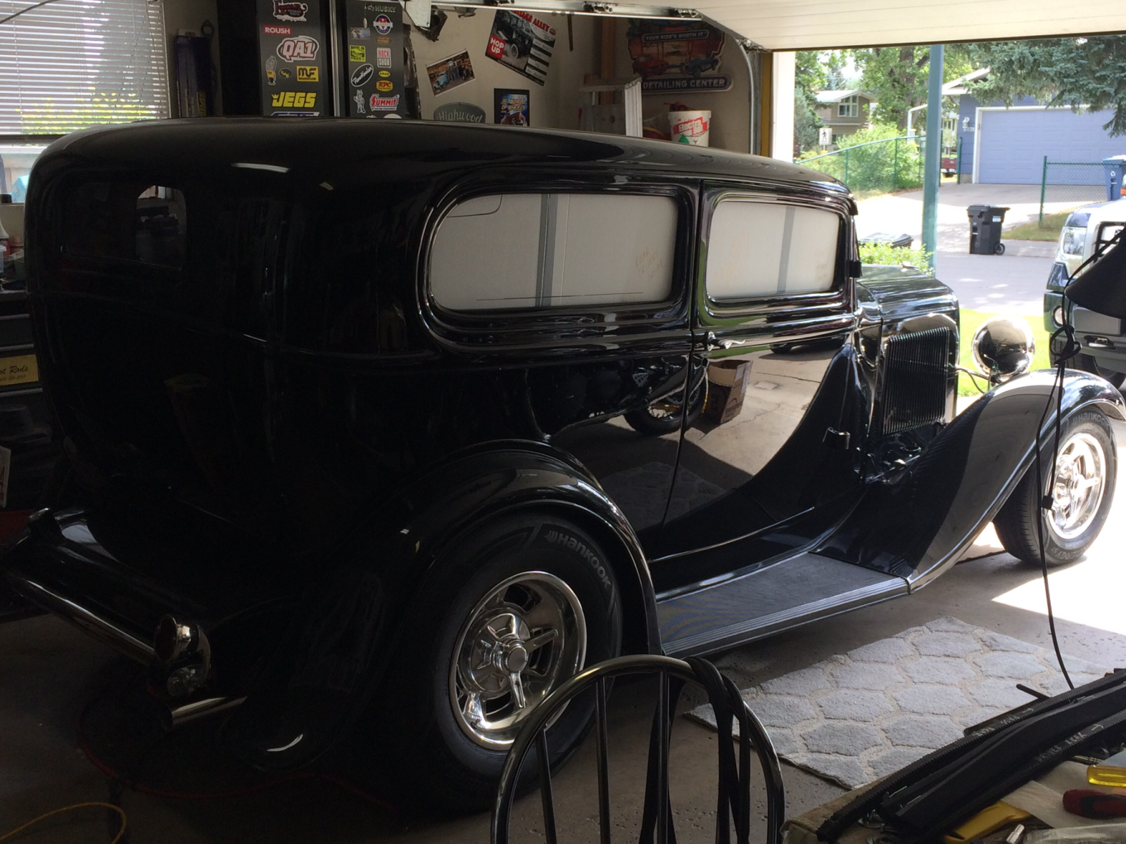

    Hey Doug, if you look at your pic you can see that your springs are 250#s.
    Can’t believe no one has really answered this poor chaps question yet.
    No offense eddy, but without angle included in answer Harold is still left guessing.
    Last 32 Tudor I had that was fully dressed used 250# springs and mount angle was close to 20*. Current Tudor project is also going to use 250# springs with units mounted at 20*. Also, I have found the HT springs (high travel) give a better ride, so going with them again as well. It will likely run in highboy form more than skirted, but this is her with her dress on.
