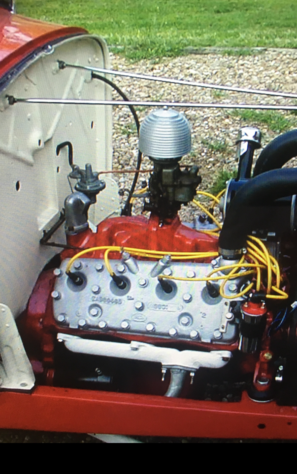

  3. Petejoe
    Joined: Nov 27, 2002
    Posts: 12,613
    Petejoe
    from Zoar, Ohio
    Not a pump in head but here’s another configuration.

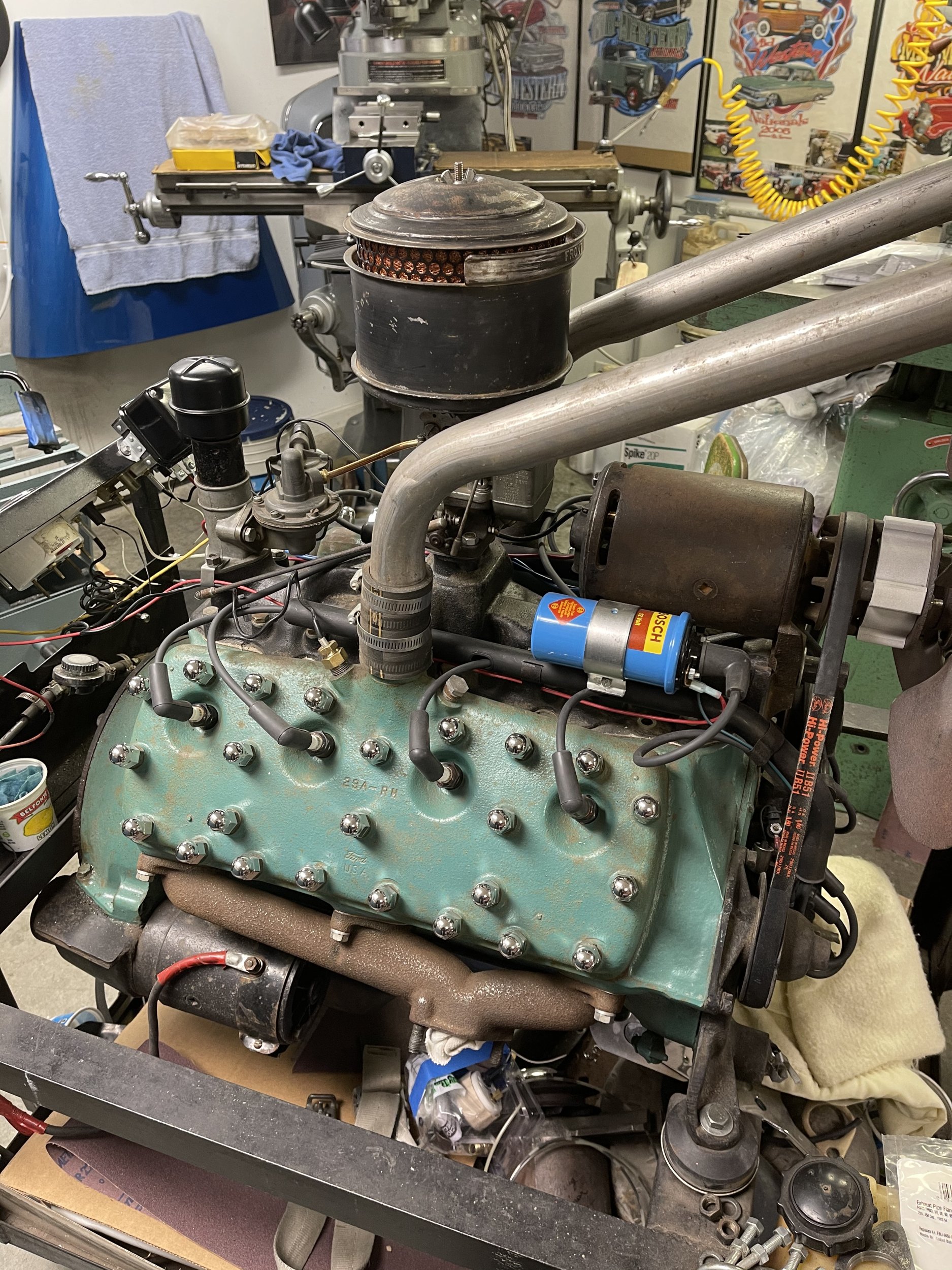

  4. chevyfordman
    Joined: Oct 4, 2008
    Posts: 1,511
    chevyfordman
