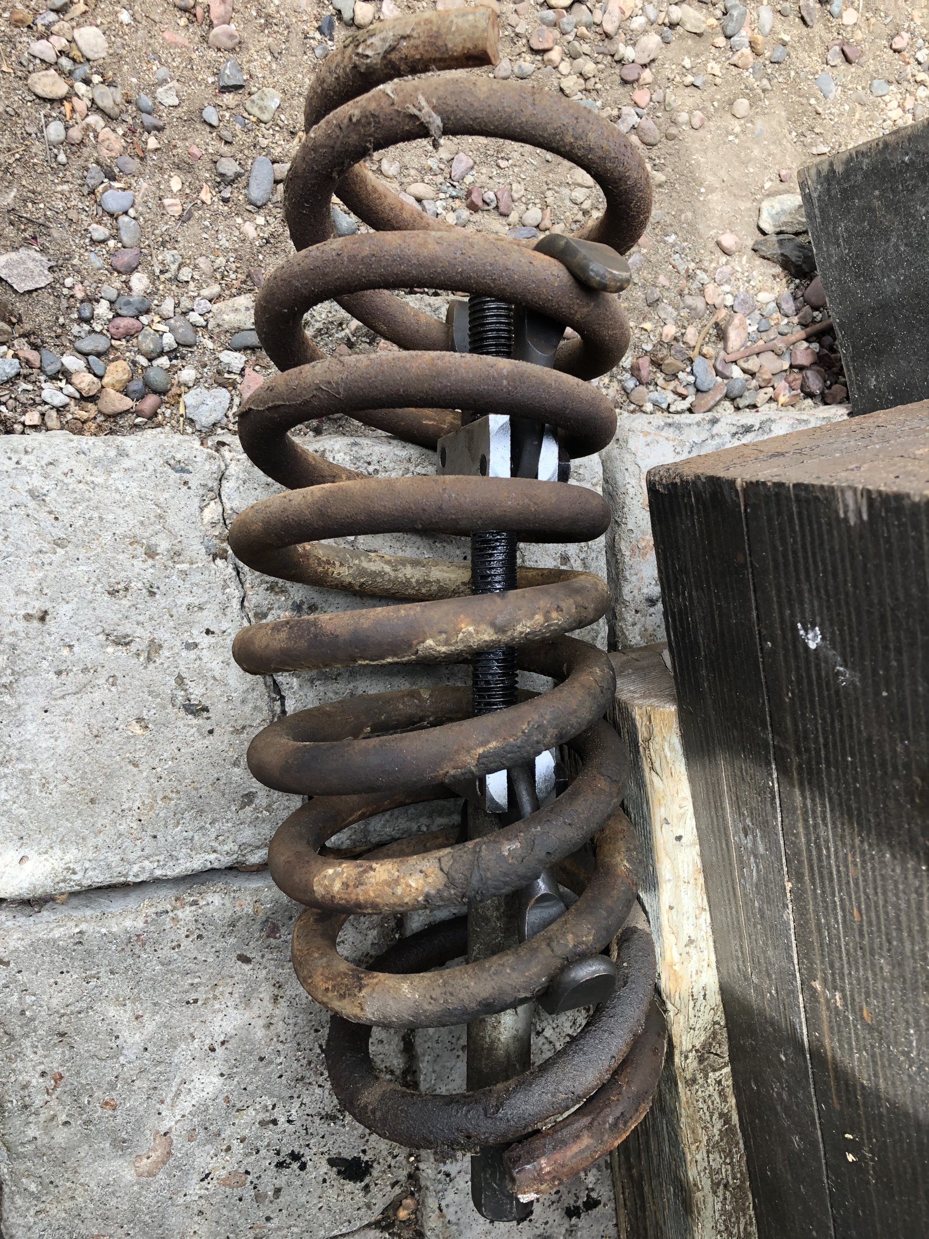

    IMG_8279.jpeg Hey guys this is the coil spring tool that I’m using. I was installing a new spring but couldn’t get the spindle close to get the nut tightened. I got a Jack on the bottom of the A-arm but it is jacking up the car. Any ideas on getting the coil to sit in the correct spot. Is it supposed to curve when compressing it with the tool?

    Wrap a chain over the frame rail and attach to axle on jack and use it as a compressor from bottom of aframe. And BE CAREFUL

    Back that off and reclamp, need to locate the compressor to get an even pull / compression on the spring. Having it bent like that adds to the danger, plus it doesn't fit.

    The internal spring compressor should have 4 hooks that grab opposite sides of the spring top and bottom. So the spring stays mostly straight. The threaded rod should be approx in center of the spring.

    Those are made to compress the spring in an arch.
    The two long arms, one top and one bottom align with each other, the two shorter arms, one tip, one bottom align with each other.
    As you tighten the shorter arms will grab first and start putting the bow into the spring then the longer arms will start catching up and compressing the other side of the spring. You will and should end up with a nice bow in the spring.
    Now the important part, you must first figure out the springs pigtail location, let's say the pigtail sets in the pocket straight out, you set the spring compressor so that the short arms are straight in and the long arms are at the spindle. Second part, the spring compressor has to have the arms aligned with the front crossmember. Not forward and backwards running with the length of the frame.
    Once you have the arms in the proper location on the spring and the spring bowed in the proper position installing it should be easy. The compressor is made to bow the spring so that the top of the spring fits into the top pocket and bows the bottom of the spring towards the pocket in the arm and should set into that arm pocket as you raise the arm into position.
    The one I've used for over 40 years I added a coupling nut between the bolt head of the compressor and the arm bracket. This moved the arm bracket up the threaded rod and allowed me to stick the bolt head of the compressor thru the shock hole in the lower arm making it easier to get to the bolt head of the compressor.
    I've used it that way for 40 yrs on everything you could thing of, station wagons and front lift springs under race cars are the worst. Anyone that ran race cars in the 70's and 80's have to remember the moroso front drag springs and how incredibly long those were !

    ABN coil spring compressor tool sold on Amazon is the type I’ve had luck with, it compresses the spring and keeps the spring more strait. I keep the threads on the on the main shaft well greased. For some reason couldn’t copy and paste.

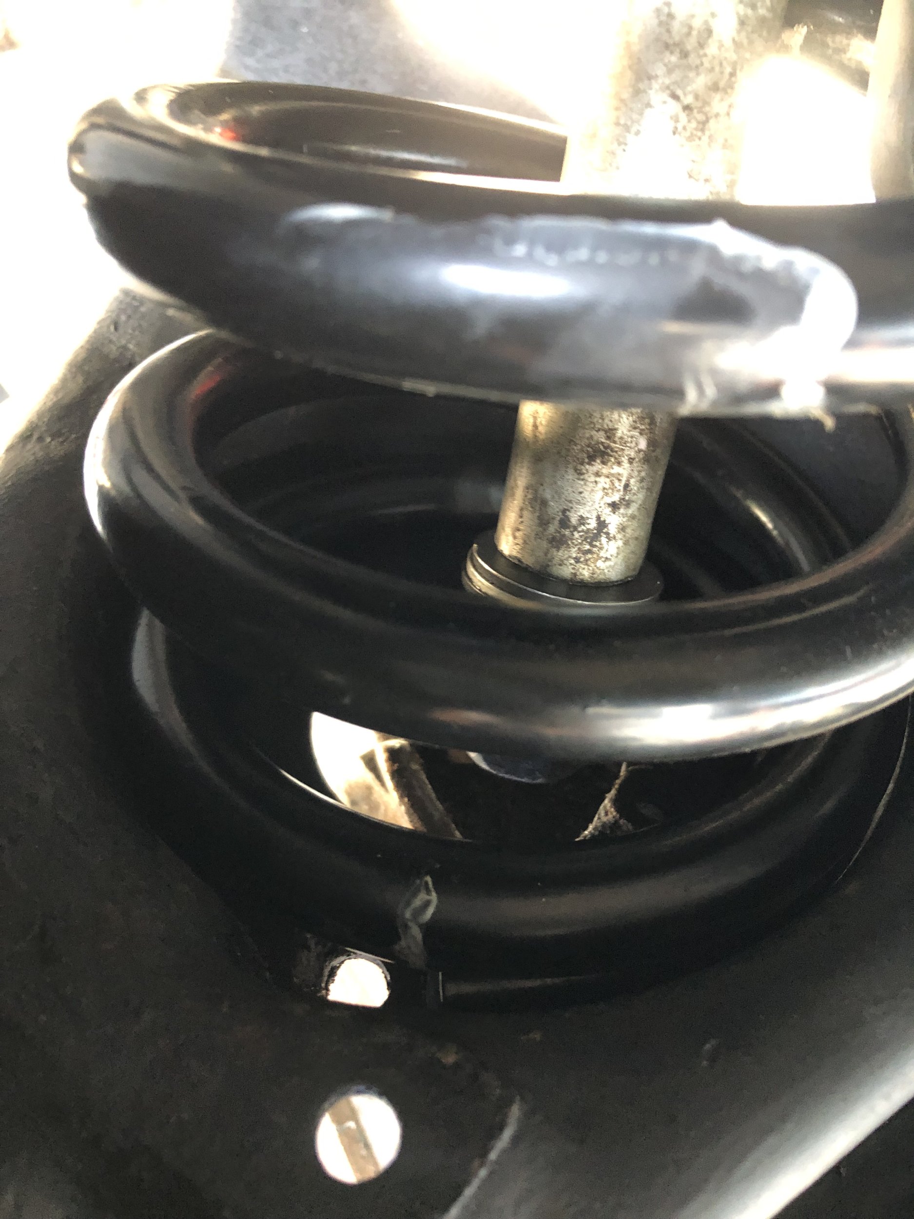

    The pig tail is 1/4” from being in the pocket. I used a strap wrench to rotate the coil as close as I could to the pocket.

    I did my '66 Belair last year, same compressor, new name brand springs. Length was the same as the old ones, coil diameter was a little heavier.
    I changed them at a friend's shop, I used to do these alone somehow. The first side was an out and out fight. Sat it down...it looked like a figure-8 car and too high. And it took us 5 hours, but we did other things too.
    I made the decision, out it came and we lopped off TWO coils. I found a nut to fit the compressor rod threads, 1/2-13.
    Get the spring situated, centered the tool best as possible. Put the compressor rod thru the shock hole and held it with a washer and nut, 90% of the battle was over. Dropped it down and it looked good.
    The second side we did on the next morning. 2 hours flat, we were done. We did the alignment the following week.
