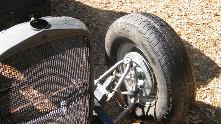

    Hey Guys, Building a couple goodies here and finally recieved the QA1 coilovers from our better late than never friends in Washington (No, not DC). Anyway, the coilovers did not come with springs, but most are pretty reasonable on Ebay, and they're chrome. What I do not know though, is what weight springs do I need for these coilovers? I've been told these coilovers, QA1 Eagles, don't even require springs, but I think they do.
    See pics, and welcome all thoughts and suggestions.

    The shocks in the pic QA1? they look like regular shocks to me. Coil over shocks have a threaded body for the lower seat/adjuster nuts and an upper retainor for the spring. I would imagine 300lbish since it is kinda short maybe + or - 50lbs
  3. If you can weigh the front end, you can go on and measure the shock length at ride height and determine the correct spring rate to allow the shock to compress that much. Yes, they WILL need springs...unless you've got another method of holding the car up hidden in there somewhere.

    from Florida
    Sorry, I put the straight shocks from a mustang II setup in place of the coilovers until they arrived. The eagles I received are adjustable, and I will pull out the spec sheet to see what weight capacity they have. Found a set of 200# on web but thought that was to light even for the LT1 car, but they are several sets of 400# on the bay for under $100.
