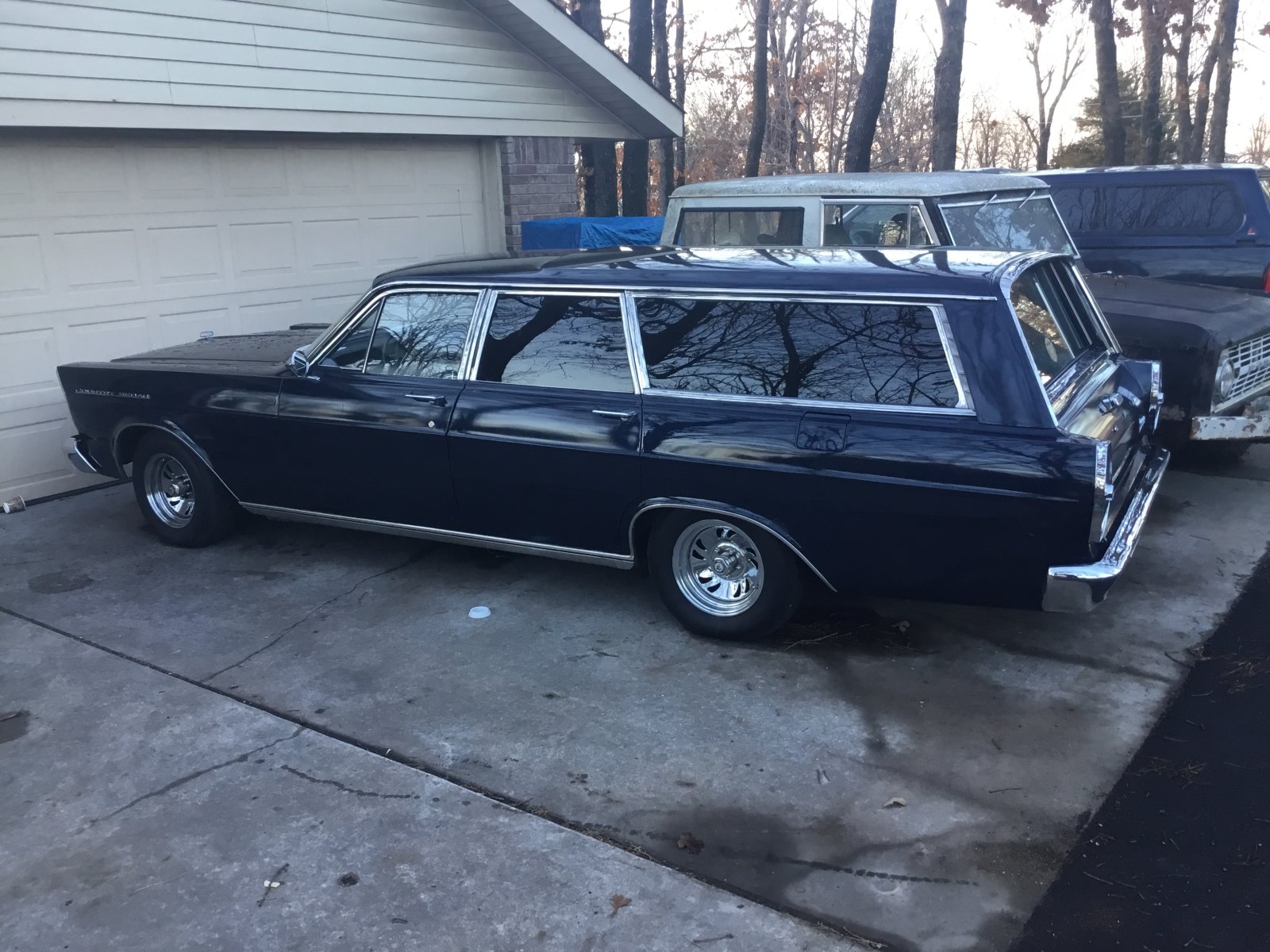

    The previous owner lowered my ‘65 wagon and I hate it! It makes it real hard to get in and out of! No sure if I like it’s look. But sure don’t like driving down the road looking up at other cars! Not sure how he lowered it, but it’s low! It will,be getting a new set of rear springs soon!

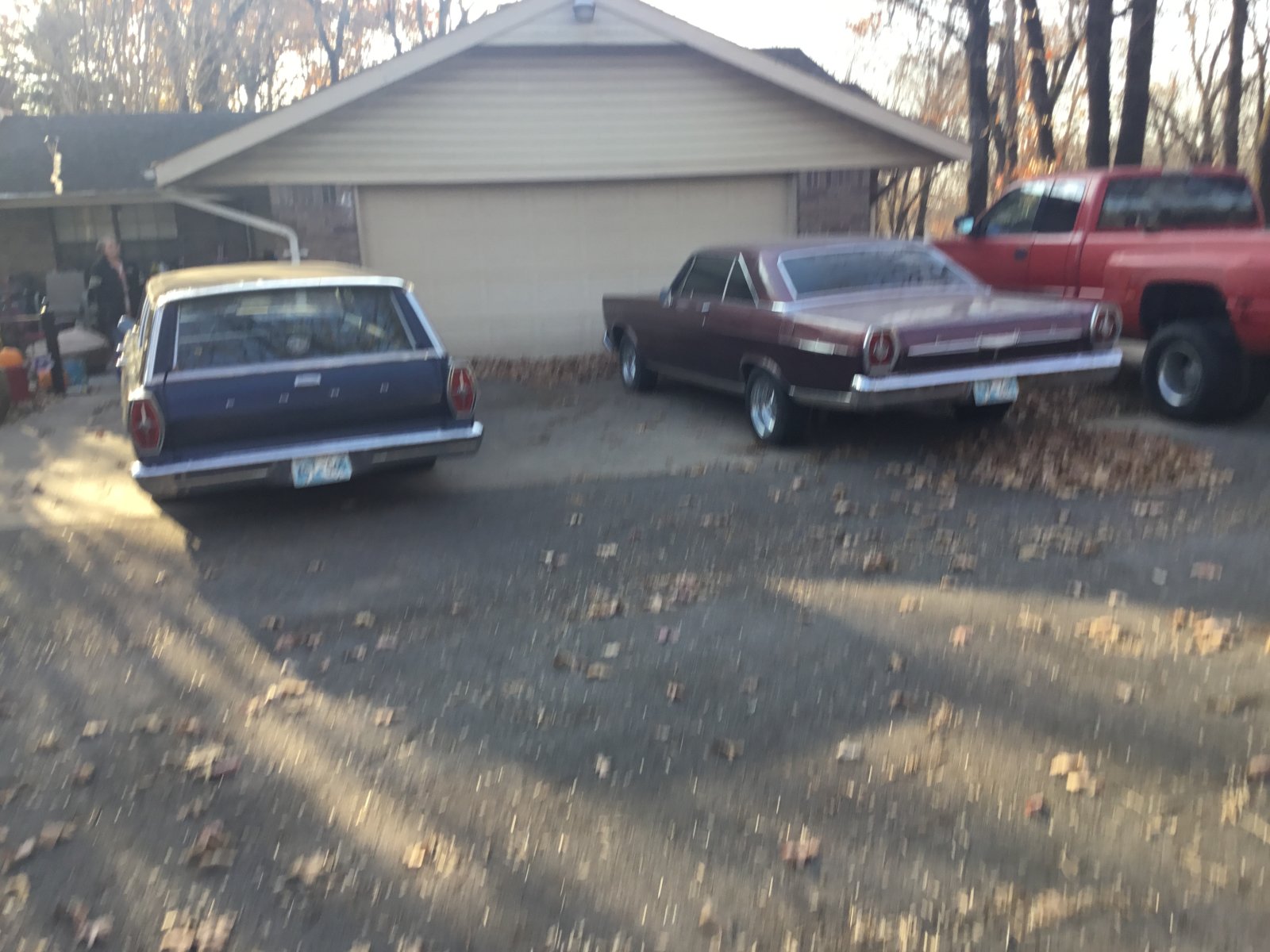

    I figure, I haven’t looked under there…..too low! Lol I think he may have heated the coils with a torch, also! Either way it’s getting new ones, to give it a better stance, like my 65 XL!
    Here’s a shot of the differences in stance! F0C8AF6B-28F6-4199-AE4D-7E67358BF59A.jpeg 275B14A3-05AF-44F0-8E28-49C820973872.jpeg
