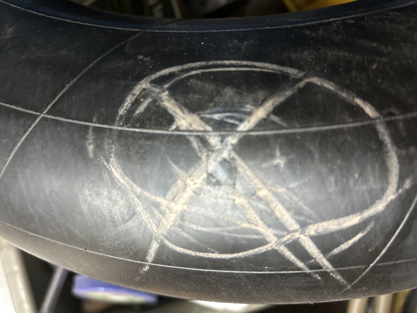

    I've been very happy with the
    Coker American Cl***ic bias ply look radials on my T RPU. The tires are mounted on 1950 Mercury
    wheels without safety bead locks so I'm using tubes. In the last few years I've had two flats caused by
    the little "stickers"that are on the inside sidewall of the tires. The tire shop said radials flex causing
    abrasion on the tube eventually causing a leak. I thought the first leak was an anomaly so I didn't
    remove the stickers on the other tires. After my second flat, I had the remaining two tires stickers removed.
    So I'm saying that if you're using tubes inside radials it would be a good idea to inspect and remove
    those damn stickers before you mount the tires. CaptureCoker.JPG .

    Learned my lesson with my first set of Coker Excelsior Radials and those dam little stickers. The abrasive stickers combined with the poor quality radial tubes Coker was selling at the time spelled disaster. Finally had the tires broken down, pulled the tubes, installed new tubeless valve stems and went tubeless. Worked fine.

    Those little aluminium stickers are nasty. Had the same problem on my avatar . Second day on new rubber had a flat. Tyre shop repaired the tube but a few years down the track the patch failed. From now on we make sure the old rims are good and no tubes. We just take the gamble and don’t carry a spare in anything, a lot more luggage space.

    Interesting! I had the same issue with their cl***ic radial black walls. The tube was determined to be the issue but was not aware of the “tags”.
    Saved the tube to show them in Hershey and son of a gun, It has a square abrasion where the leak is.
    Should be an interesting discussion in their booth.

    The little stickers on the tire liner indicate the location in the tire’s construction where there is a splice, for the body plies, the belt package and the bead bundles. If the tire is designated tubeless and the wheel has tapered bead seat, ditch the tubes. They are the air container, not the tire, and the slightest penetration is an instant flat!
    Plus the tire runs hotter with with tube flexing..
    If you are adamant about running tubes make SURE that they are radial tubes.
    There is a difference, namely gauge of the rubber, splices and vale stems.

    As a quick follow up on this topic, I met with Steve at the Coker booth in Hershey. He wrote the original order for the tires a few years back and reaffirmed that it was ok to use radial tubes with the American Cl***ic radials. He had no full explanation for what happened to me but in all fairness, they were very busy in the booth at that time.
    As an aside, I did try to run the tires without tubes to find they did not hold air sans tubes.
    As a good will gesture, I was provided a complimentary tube.
