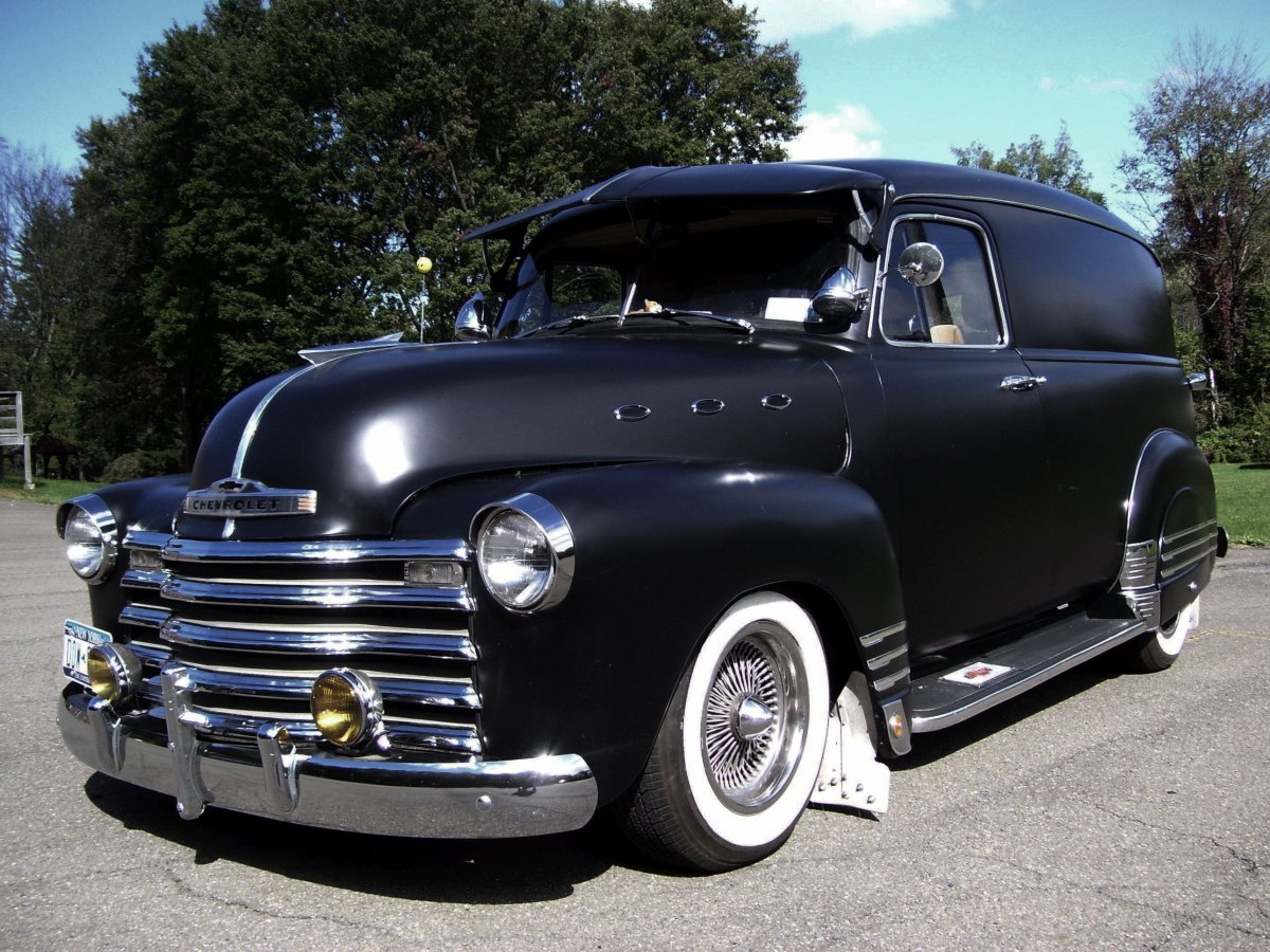

    I agree with D.O.M. When I first built the Sedan Deliv. I ran Bias plys and it handled like a dump truck. Switched to radials and it handled like a go-cart...1000% improvement.
    I had to use radial tubes for that very reason. I couldn't get the wire wheels to hold air. The tubes were a little expensive, and a little tougher to balance, but never had a problem with them.
