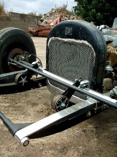

  2. simon g-s
    Joined: Mar 1, 2009
    Posts: 116
    simon g-s
    Yeah you are right, tie rod is out front. Axle is home built using Sherpa van spindles. these were flipped side to side as the Ross steering box ( from a combine harvester ) was fer left hand drive and axle was from RHD ( normal for UK ). I did heat and bend the steering arms to restore ackerman. Problem was definitly the tyres, 3/8" out up and down and side to side. Wasted ££ ketting them reset on the rims. Some wierd brand radials sorted it, steady at 100 mph now.

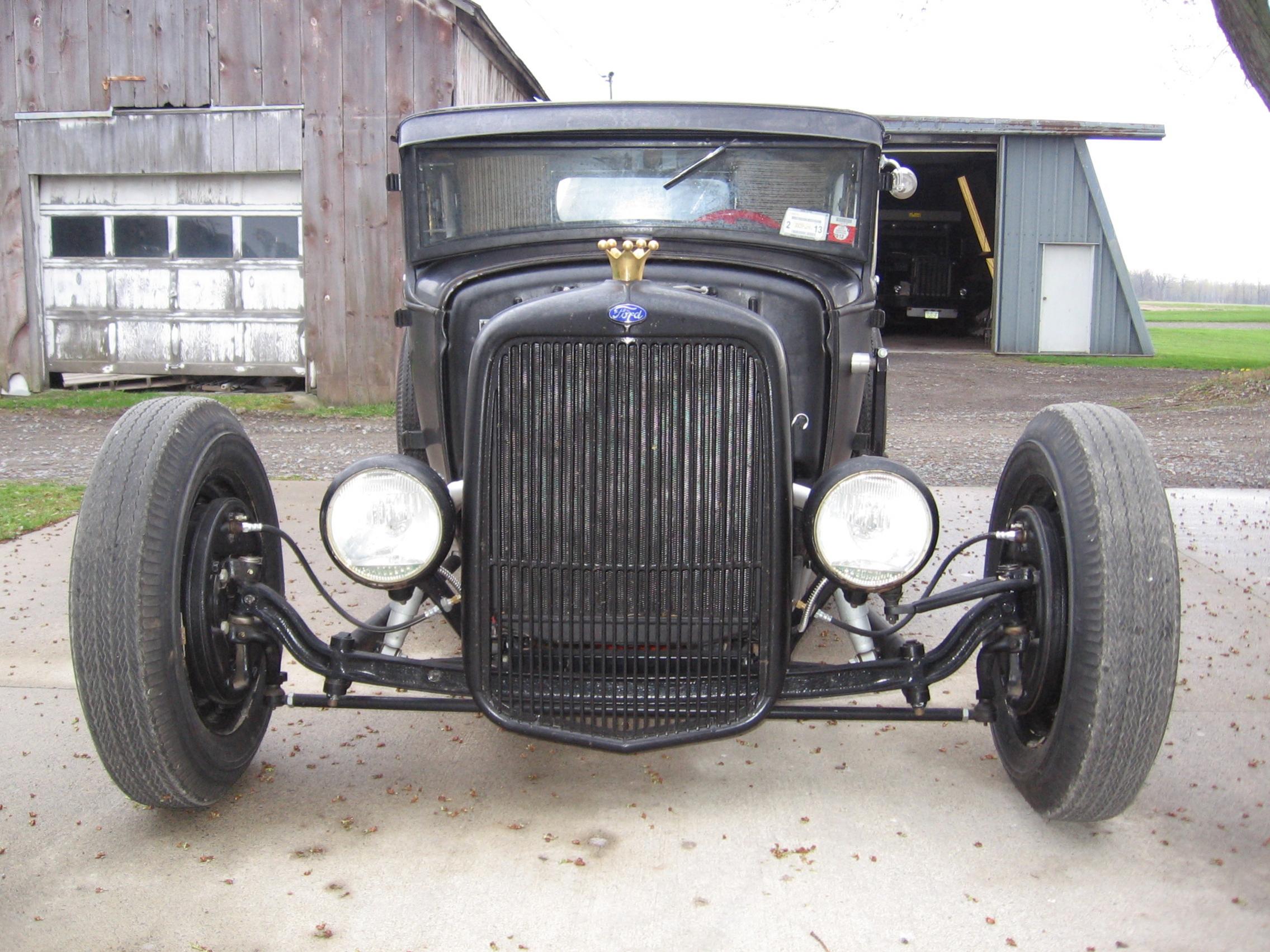

  25. 3030
    Joined: Dec 21, 2010
    Posts: 206
    3030
    When I built this A I had used tires on old 40 ford wheels took it around Charlotte speedway and down the backstretch at about 85 she started the death wobble not much fun mind you. I've been around that place at 175 when I worked at Pettys so I'm glad she did't end up in the fence. Called Cokers got 4 new tires the same size now no near death scares. They were great to deal with. Sometimes I think a lot of the problems might be the old traditional junk wheels we try to run. Tuff being a HAMBer an keepin it out of the fence. Jim

  29. flatcrazy
    Joined: Apr 12, 2007
    Posts: 80
    flatcrazy
    Nice car! What size tires are you running? They look like like Firestones from the pictures.
