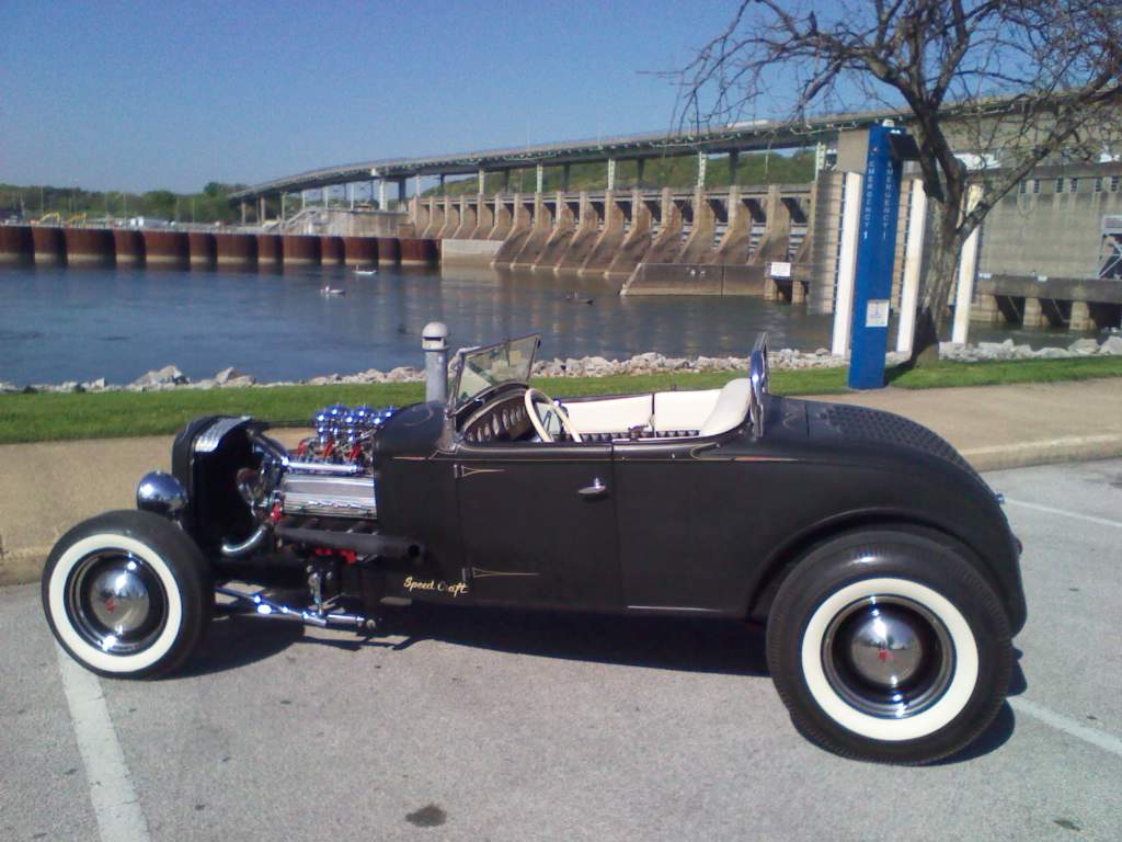

  11. OoltewahSpeedShop
    Joined: Oct 18, 2007
    Posts: 3,103
    OoltewahSpeedShop
    These are BFG Cokers. No problems with them either.

  12. GARY T.
    Joined: Mar 23, 2008
    Posts: 1,985
    GARY T.
    from S.W. Pa
    What size are they?
    Nice car!!!!

  14. OoltewahSpeedShop
    Posts: 3,103
    OoltewahSpeedShop
    5.60X15 and 8.20x15
