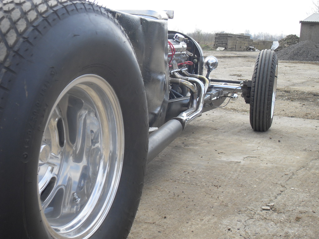

    Used Dyna beads in firestone dirt trackers as they were too big to fit the balancer machine. Smoothed everything out a treat. THEN fitted Cokers ribbed on the front, frickin nightmare, nearly destroyed the front end. Tried all I could think of including dyna beads but NOTHING can really fix out of round tyres like some ****ty secondhand radials. Dont look so good but no fear.

  30. I can not see how you mounted the tie rod. If the tie rod is in front of the axle you have ignored the Ackerman theory and that is your problem and not the tire problem. Post another picture of the front end from the front end.
