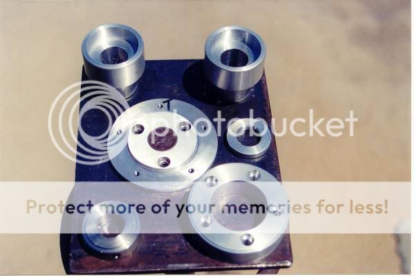

  3. You may have to use a piece of angle to bolt it under the dash, but these can be any size you want.
    1/2" aluminum plate.
    Make it larger and you can bolt in a couple of instruments and/or light switches etc.
    Moon Equip. used to make several varieties of this style.
    Some with instruments, some without.
    These are some of the pieces for the home-made steering column.
    The lower right piece with five holes is what locks the flat plate to the column.
    Here's all the pieces for the steering column fwiw.
    Complete column.
    Aluminum con-rod.
    2" bore with stepped reducer bushing.
    Another view.
    I know you said 39, but a bracket with a few equally spaced holes makes it nice to move the column left or right if necessary.
    The column in use here is 1 5/8" OD fwiw.
    Rare double wrist pin con-rod....;):D

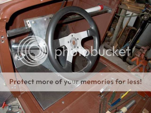

    fleetside66
