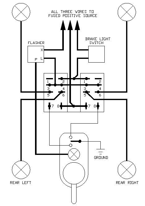

    Check the relays pinouts the tail lamps should be connected to the wipers of the relay switches.
    Some relays have the wipers and the Normaly open connectors on opposite pins

    ****** Jack, can you repost the schematics again for this? Seems that the Photobucket pictures no longer display. I finally reaquired a nice Yankee 9000 turn signal indicator and I would love to be able to run this on my roadster.

    I saved ******Jack's schematic and am re-posting it here in hopes of helping others wanting to use an old T/S switch. I built one according to ******Jacks instructions, and once I worked out my own stupid grounding problem it worked out great.

    You the man Woody!, thanks
