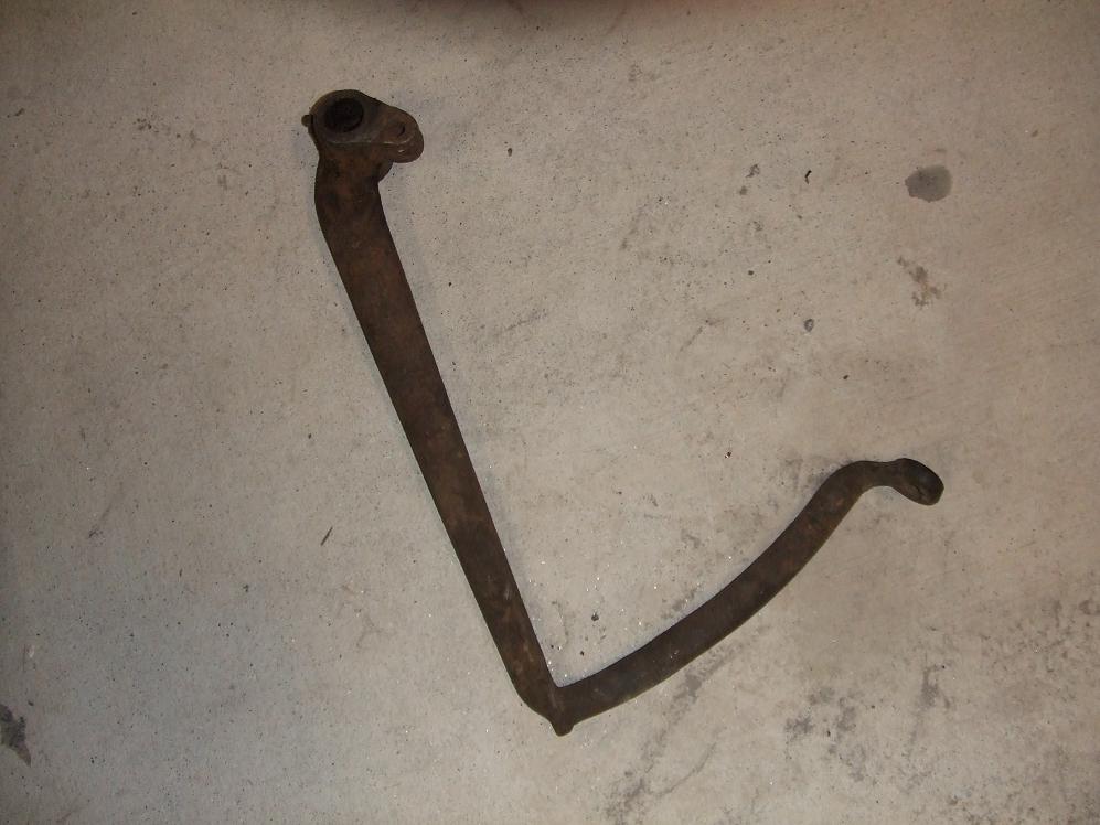

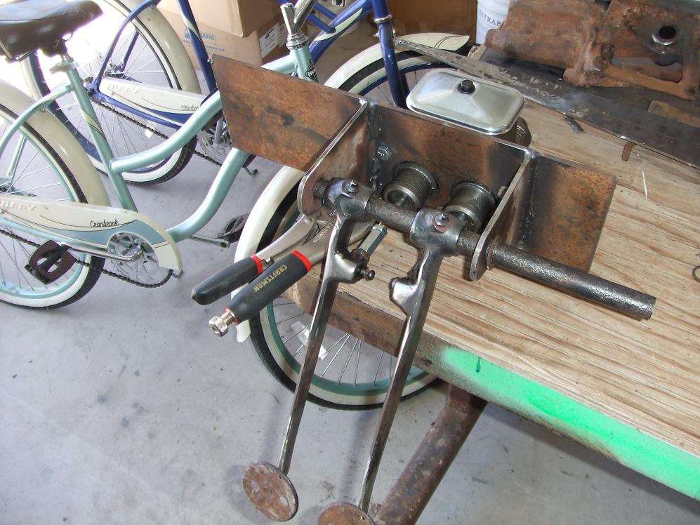

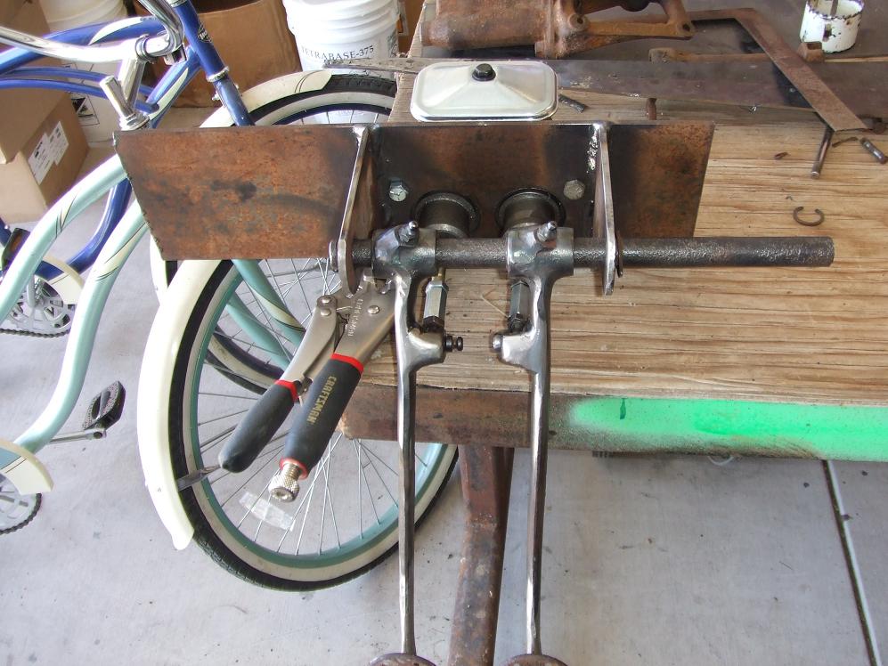

    The slowest build ever....continued....Making some " Ansen style" or wanna be, brake and clutch mounts and pedals. Used 1940+ ( really don't know ) Ford pedals cut down and rewelded. The master and slave combo right from Auto Zone.Trying to keep it looking "old hot rod", love the way the pedals came out.

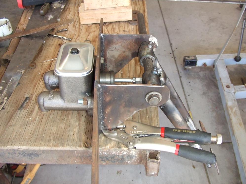

    Here's what I did with this.......made a piece to fill the gap at the top of the panel. Hope I did the right thing, I quess I will see............

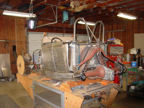

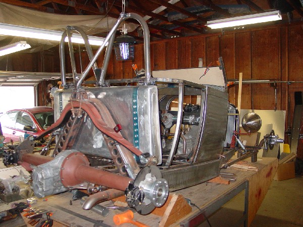

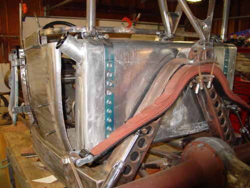

    I was looking at your 1st pic of the body sitting on the frame, this is what I did...not sure if you sorted it out yet or not.
    -Jason
      146.7 KB
      318

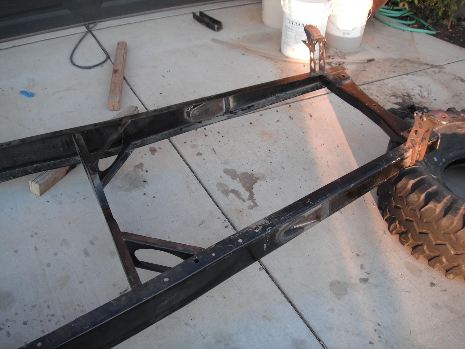

    Trying to get the front frame boxed this weekend so I can make motor mounts and rearend mounts, and figure out everything inbetween...........
    and clean out the shit in the garage....
      281.2 KB
      276
      252.2 KB
      295
      322 KB
      434

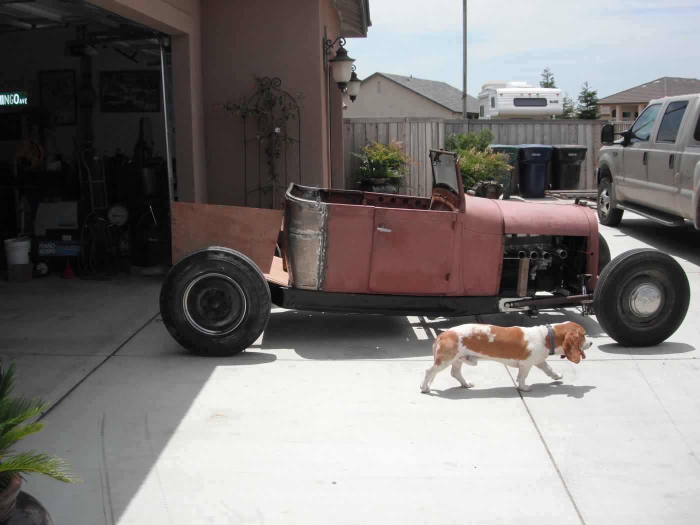

    Put it together as a roller so I can keep fabbing and mounting things up. Lotsa help from Reese the wonder dog. Need opinions.......gas tank only on the back or shorten up a pickup bed? Yes, I know , I asked for it!
      204.5 KB
      440
      226.9 KB
      421
      235.4 KB
      2,041
      214.7 KB
      415
      225.2 KB
      458

  18. TexasSpeed
    Joined: Nov 2, 2009
    Posts: 4,632
    TexasSpeed
    from Texas
    I really like where this is going. I don't blame you for wanting the extra room.. I think a short bed would look better than just the bare end of the deuce chassis sticking out. It may look just fine without the bed. Do you have any rear 3/4 shots or rear shots of the RPU so we can get some ideas?
  19. iammarvin
    Joined: Oct 7, 2009
    Posts: 1,196
    iammarvin
    from Tulare, Ca

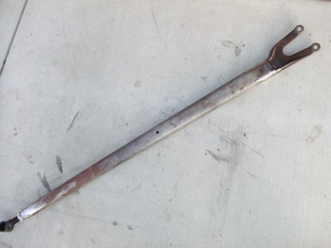

    Wow, it has been a long time since an update. Made up some rear "ladder" bars out of a front wishbone, still have to make a trans/ladder bar mount. Then make up a torque arm.
      106.2 KB
      242
      164.7 KB
      231
      142.8 KB
      233
      134.6 KB
      227
      147.8 KB
      251

    TexasSpeed....... does this help?
      133 KB
      260
  21. TexasSpeed
    Joined: Nov 2, 2009
    Posts: 4,632
    TexasSpeed
    from Texas
    Yeah.. In my opinion, I think there's too much frame sticking out the back for it to look good without a bed. If the frame was shorter then it would look okay without a bed. If it was me, then I would run with a bed but that's just me. It's not my build. Maybe you've got a trick up your sleeve that you've been saving for it. Build it however you want to.
    I'll be keeping my eye on this one regardless. I like it.
  22. iammarvin
    Joined: Oct 7, 2009
    Posts: 1,196
    iammarvin
    from Tulare, Ca
    Texas,I think you are right. I have been thinking the same thing. I've been trying to trade my pretty nice stock bed for a pretty nice shortened bed. No luck so far, considering hard to chop up my bed.

    Some pictures of what I will run as ladder/radius rods, front wishbones split and used as ladder bars. Torque arm in the works..........

    Made an X member so I could mount my trans and rear end locators. If anyone see's any bad thinking, please point it out. Next up, trans mount, is 3/16 good or should I use 1/4?
  26. TexasSpeed
    Joined: Nov 2, 2009
    Posts: 4,632
    TexasSpeed
    from Texas
    I think it looks great. How are you going to mount them to the X-member? Looks like you might be planning to run a bar from one side to the other in between the top and bottom bars?
    iPhone - TJJ app
  27. iammarvin
    Joined: Oct 7, 2009
    Posts: 1,196
    iammarvin
    from Tulare, Ca
    Thinking of a 3/16 thick plate on the bottem of the x member for the trans mount, gives me 3 degrees pointed down on the trans output shaft. 1/4 inch plate on top of the bottom bar x member for the rear ladder bars and the torque bar to mount to.
    If that makes sence.....

    The crossmember/rearend front mount being made. I have decided to use tierod ends instead of 4 bar ends on the front mounts of the rear ladder bars, I just thought the tierod ends have more movement then the plastic/polyurethane 4 bar ends, I may be wrong...... opinions are taken into concideration. Thinking of a torque bar to the top crossmember? Maybe better to the ladder bar?
    I really do not think this set up needs a torque arm since it is fixed on the rear axle housing....??
