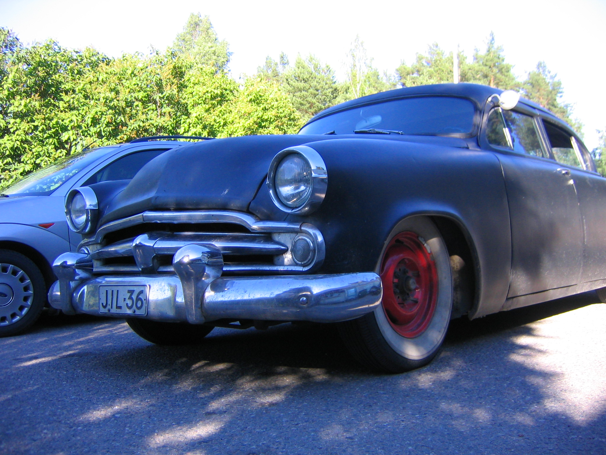

  12. Lättähattu
    Joined: Oct 29, 2009
    Posts: 132
    Lättähattu
    from Finland
    Nice trick, if i just would know that in 1996 when I cut 1 ½ coils off the springs. Make it low enough, but messed up the geometry. Original shock mounted between upper and lower control arm, became useless. That was cured same way as you did, making new upper mount bolted to the frame. But still have problem with tire wear, cause can’t adjust camber enough. Maybe I should be brave enough to put upper control arm to the press and straighten them little to make them longer. Also that long tie rod to the right front wheel cause bump steer to right wheel, but that ain’t too bad, but right wheel wears out even quicker than the left one.
    But still I have driven 105 000 miles with that thing and I’ll keep on driving lots more, so even it is not perfect, it ain’t too bad either.
    By the way, it is -54 Dodge Kingsway, export model, technically same as -54 Plymouth.
