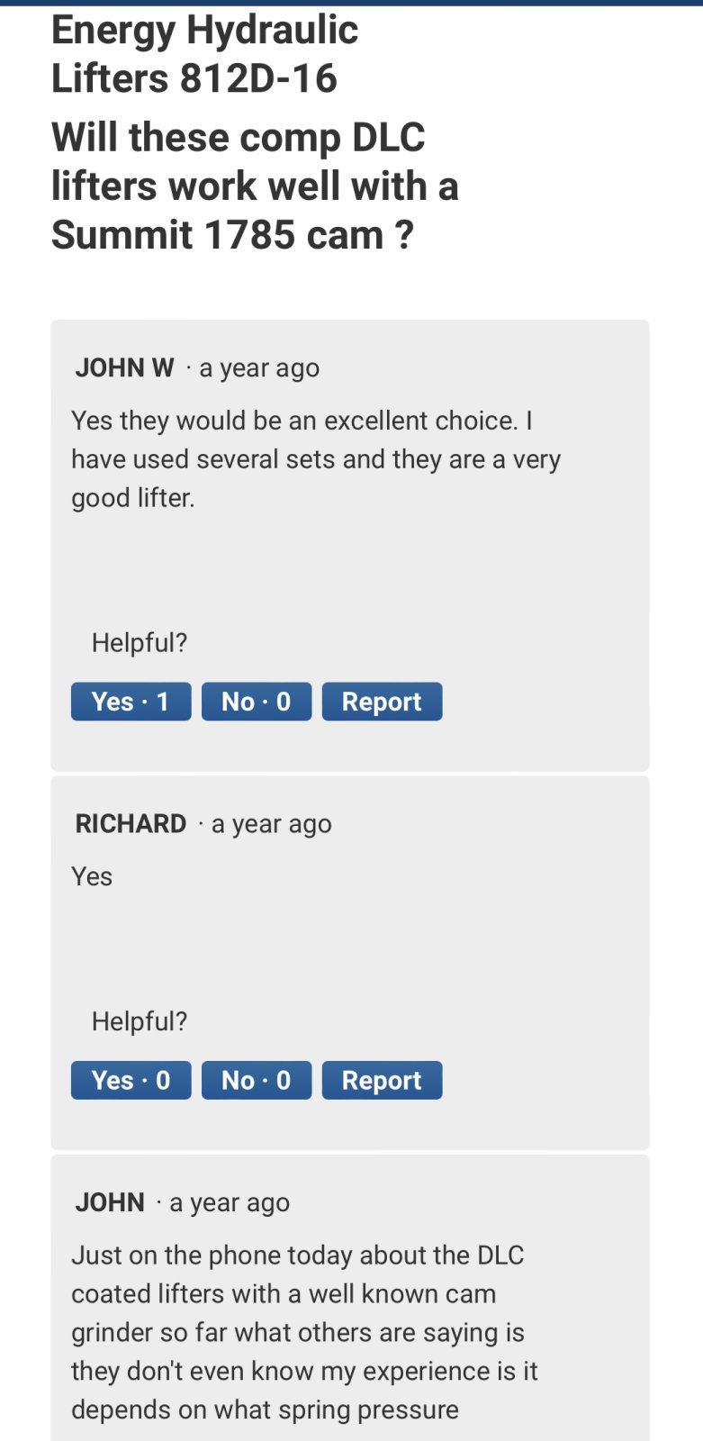

    What Summit Racing Q&A has to say about them. IMG_3035.jpeg IMG_3036.jpeg IMG_3037.jpeg IMG_3038.jpeg

    Sorry Mike, but I can see the ops point here. He may have called Comp and gotten their recommendation, but its always wise to ask for the real life experience of people who may have already tried the product......especially with the current issues camshafts and lifters have caused. :)
