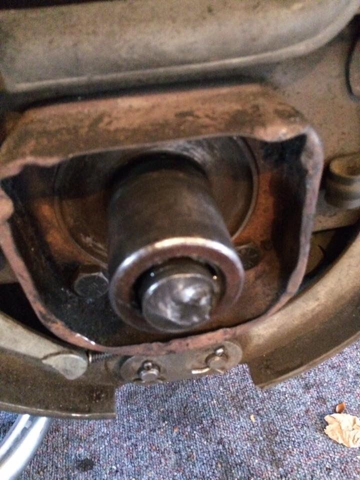

    Hi all, Technical question wondering if a 1938 Banjo diff would be compatible with a 1947
    Sent from my iPad using The H.A.M.B. mobile app[​IMG]

    Maybe in your haste,you made a typo??? if not yes, a 38 banjo is all the same in 1938

    47 rear will be wider. Are you sure your present banjo is 38 and converted to juice brakes.

    Remember the original 38 banjo was cable brakes and 47 car was juice brakes and torque tube while 47 pickup was the same but open drive.

    38 axle shafts are too short to work in a 46 rear. The banjo center sections will interchange. The whole rear end could be changed out but use the shortened driveshaft and torque tube. Check to see if you like the gear ratio.
    You could also use the spiders, axles and axle housings with your present gears. center section
