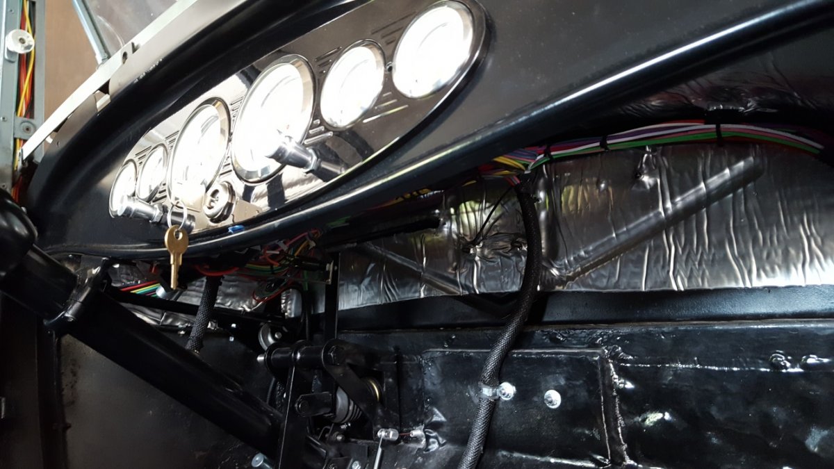

    I used the EZwire kit on mine. Not bad in my opinion. Great kit for the money. I soldiered every connection so it took a little longer. I would never recommend to anyone to do the black wire kit. The wires should be hidden anyways. You will thank yourself later when troubleshooting. I also invested in waterproof connectors off amazon for things like lights and turn signals. 20170401_120249.jpg
