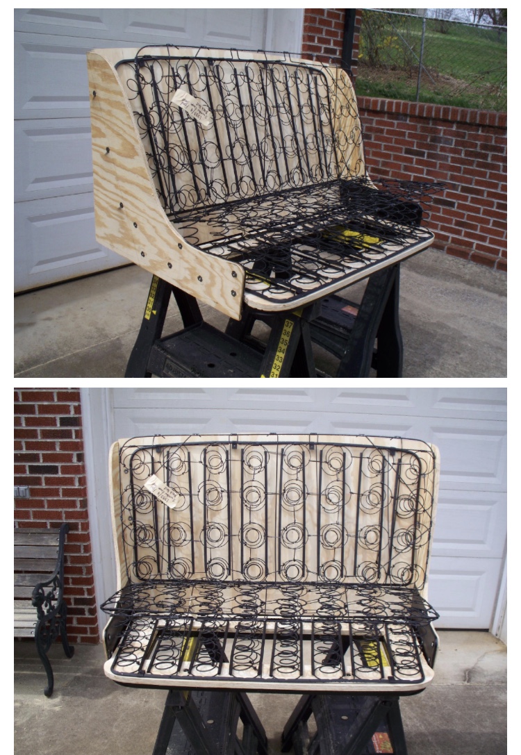

    Picture 003.jpg wpdsc02581.jpg View attachment 2679180 View attachment 2679180 I have received several request for a 34 style seat with the side wings. After a little research I made this seat with the wings. It does the flip up as well as the adjustable back. I think a fixed back seat without the handle showing could look fairly close to original with the right upholstry on it.

    Nice job guys, I just rebuilt my 32 window seat, and I need to make one complete for my 34 This gives me some good ideas

  9. M.T.'s seats are a thing of beauty; the "wings" will really add to their factory look. Almost a shame to cover them up w/ upholstery!

    Well thanks Robb... one the nicesest compliments we have ever received. But reality is it does get covered up and to be honest if the foam & upholstry is done correctly one wouldnt know if it was stock seat or not. For a more original feel and look I also build these in the fixed back style as well. (Non Adjustable Back)

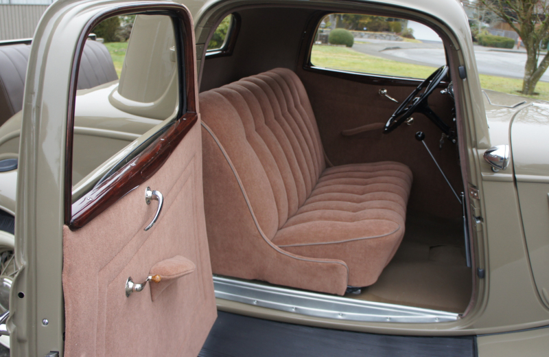

    Patiently waiting for my 34 coupe seat from Metaltwister (Bengels). Should be arriving soon. Is that it in the pic above? Thanks again, Jason

    That would be it Jason... Like your new wings?

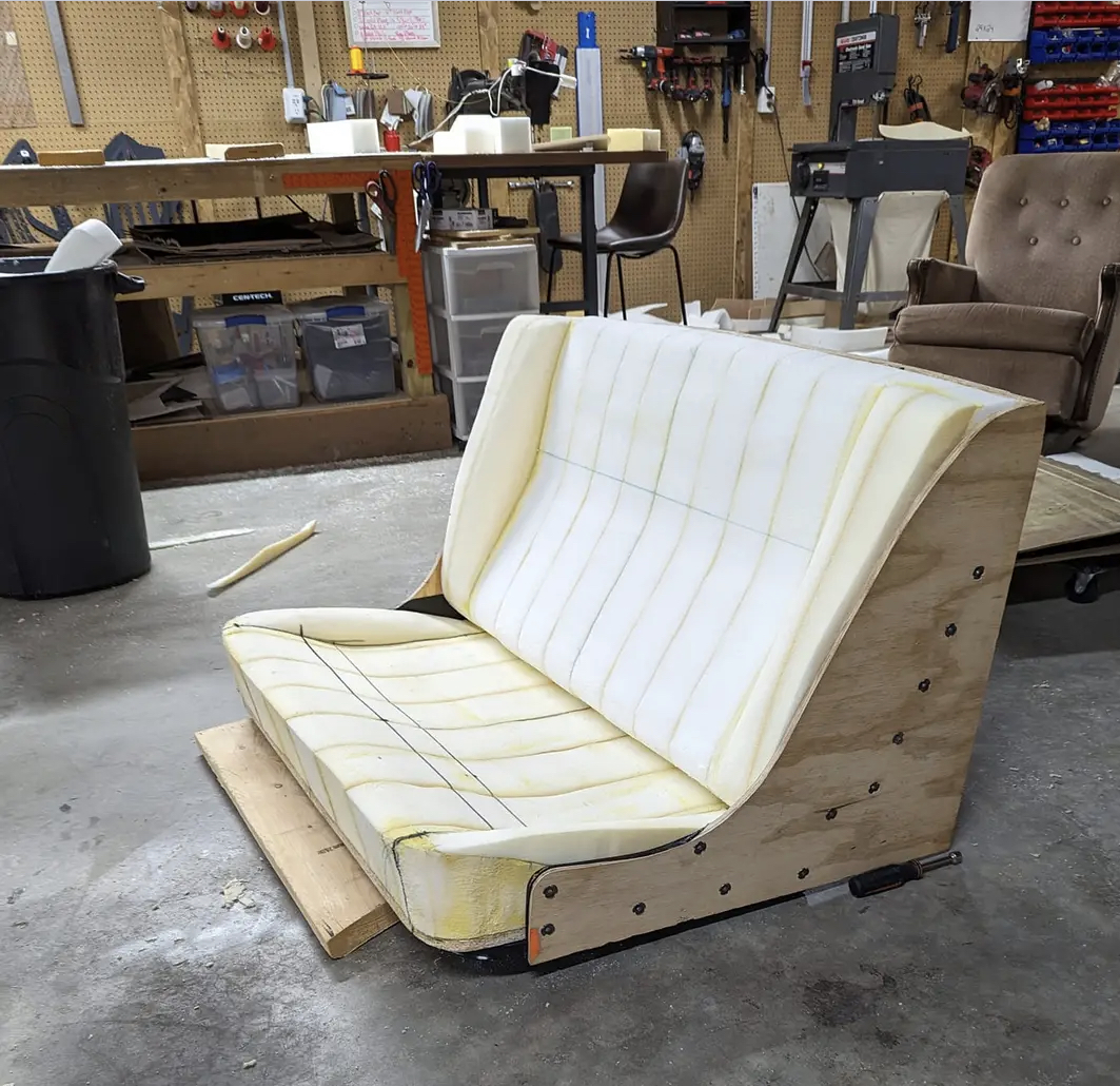

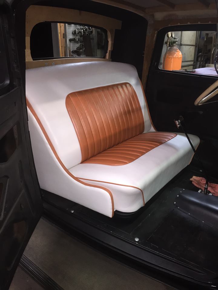

    heres a 3 window seat we built for a customers car and my wife upholstered it, i had an original 3 window seat pan and wish i would have taken pics of it, i have a couple 33/4 and 35/6 coupe seat pans at the moment and am trying to find pics of 32 3 window seat pan for reference
    IMG_7994.jpg 20799954_1604844679555432_8689079427813482316_n.jpg IMG_7991.jpg
    RICH B, ss34coupe, clem and 2 others like this.

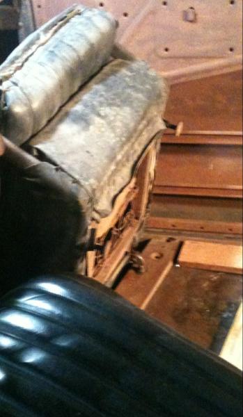

  22. Anybody want 32 Tudor sedan pics?
    The driver side slides on two tracks with adjustment stops.
    The passenger side folds down and flips forward toward the dash for access to the rear seat.
    The rear seat is wood framed with springs.
    The upper cushion fits into two slots in the rail below the rear window.
    The lower cushion slides in and locates with two holes for the pins on the front fixed riser.

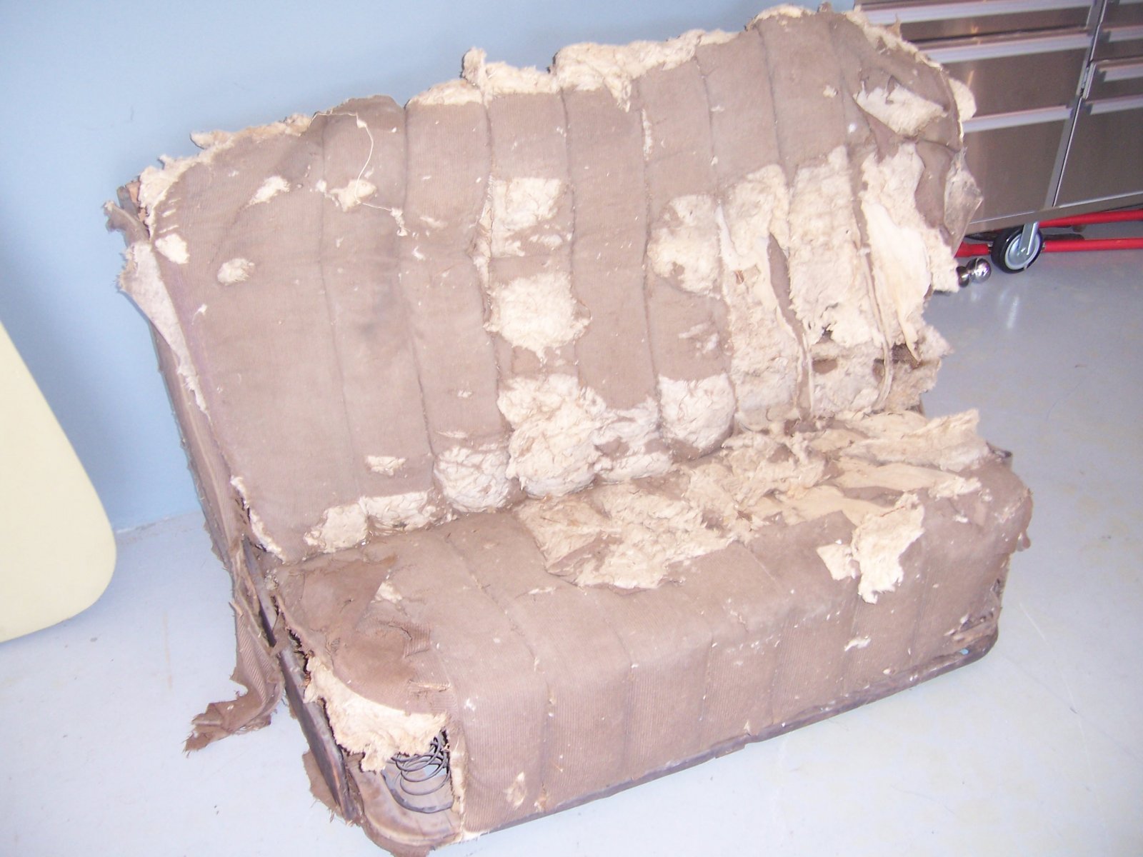

    According to Snyder’s, the seat bottom springs for the ‘33/4 coupe seats are the same - both the 3 window & the 5 window. The backrest springs are different thickness, depending upon 3 window or 5 window. I’ve made a few seats ‘33/4 seats, based upon patterns from original seats. I’ll include a few photos of an original ‘34 3 window seat and a seat that I made. IMG_5294.jpeg IMG_5295.jpeg IMG_5296.jpeg IMG_4670.jpeg IMG_4709.jpeg IMG_4737.jpeg
