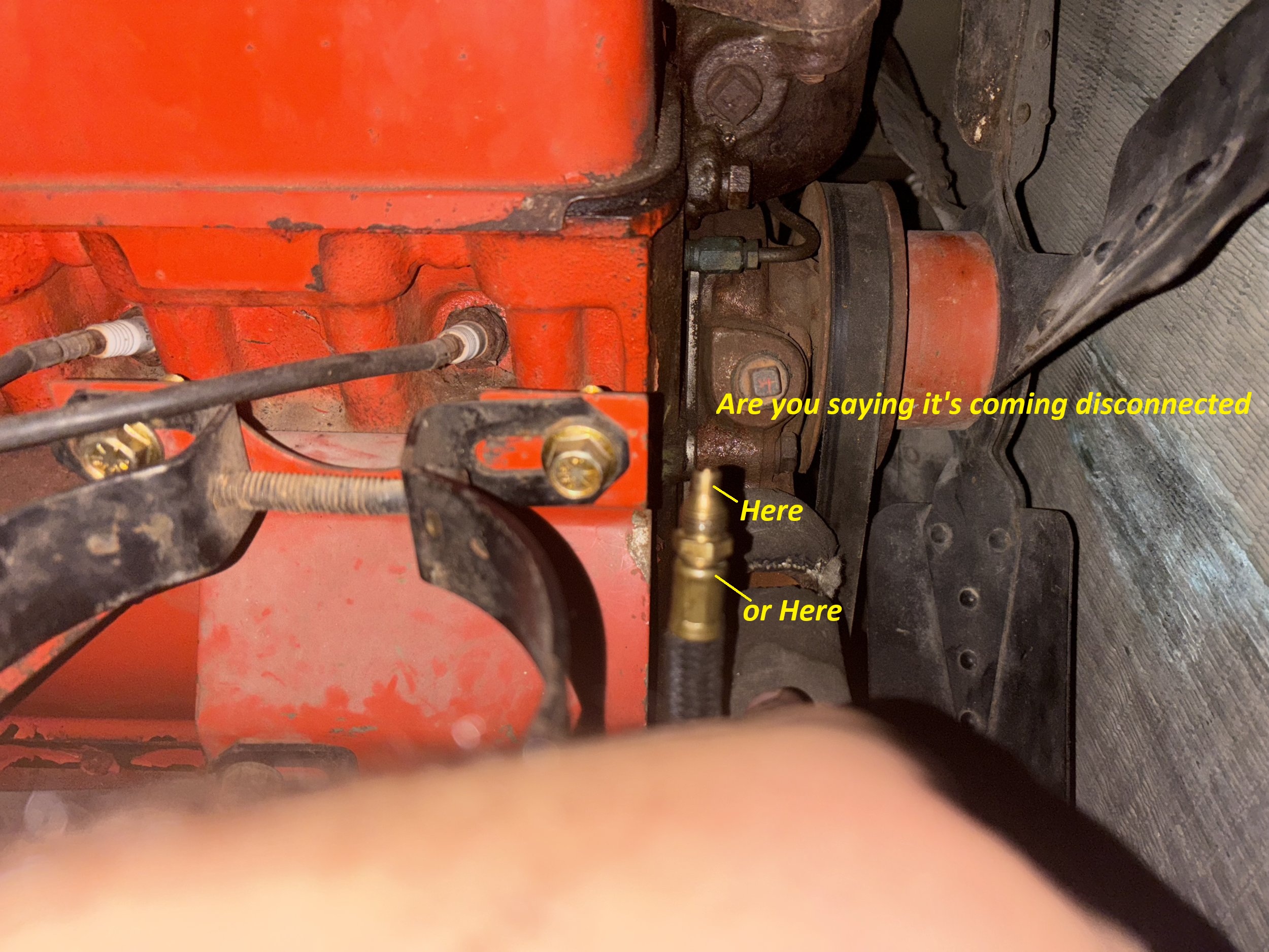

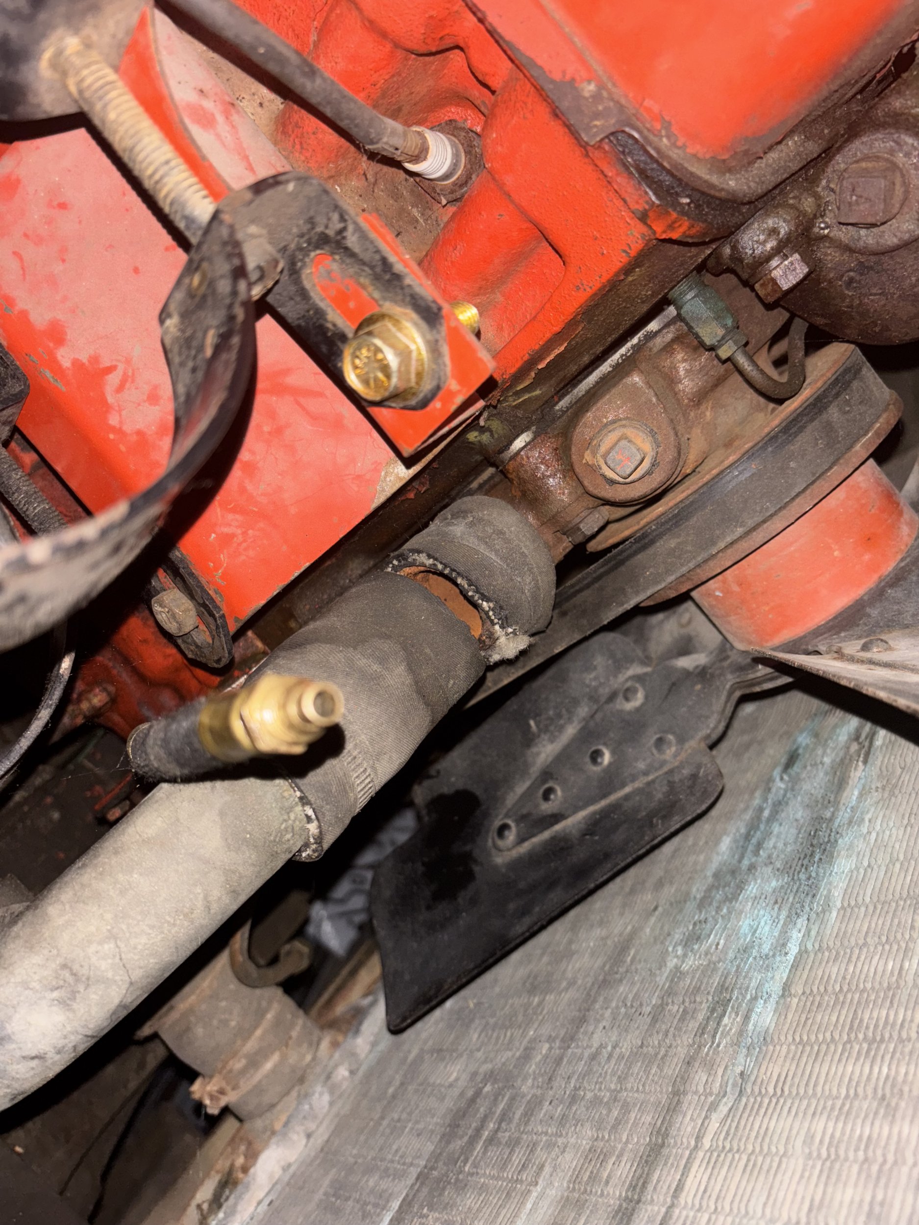

    I have this compression fitting. It keeps sliding off the end of the line. The others look the same but are on sturdy. I’ve never dealt with one like this what is going on? Thanks IMG_9944.jpeg IMG_9943.jpeg

    I’m sorry but those pictures are not descriptive enough. What are we supposed to be looking at?

    I didn't find Waldo and have no idea what you're trying to show us.
    The fitting you seem to be trying to show us is not in focus in either of those photos, and we don't know what it's supposed to connect to.
    Better pictures of both sides and a better description would help.

    I’m back! Everybody calm down lol. Sorry for a bad pic it was dark and outside. Here’s the fitting going to an oil bath cleaner on a 270 GMC. How are these installed? IMG_9964.png IMG_9963.png

    I was going to post about that type! I hate them. The cone end is supposed to compress around the tube when you tighten it against the seat at the bottom of female port, Looks like maybe just not tightening enough? Be sure the tube stays past the end of the cone.
    05snopro440 likes this.

    IF that fitting is supposed to compress around the tube, you're not tightening it enough to compress it.

    If you don't have the correct female fitting for it, it will never get tight.

    Please show us a picture of what you're putting it into.
    Thanks for the nice clear picture of the end of the tube, that helps!
    Those fittings were used on a few places on old trucks, a smaller one (1/8" tube) was used for the oil pressure gauge. I've been able to find new nuts for them, it's called a threaded sleeve nut.

    I think that was it! I also may have not got the tube all the way into the fitting. It’s snug now, thanks for the help!
