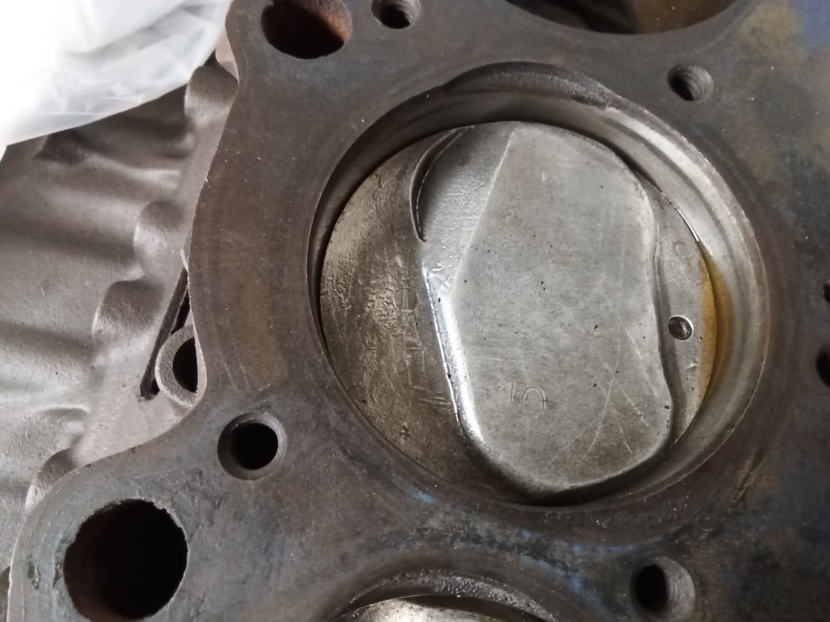

    I’ve got a pair of #206 396 heads going on a’89 454 . With steel head gaskets I should be in the 9 to 1 cr. range.

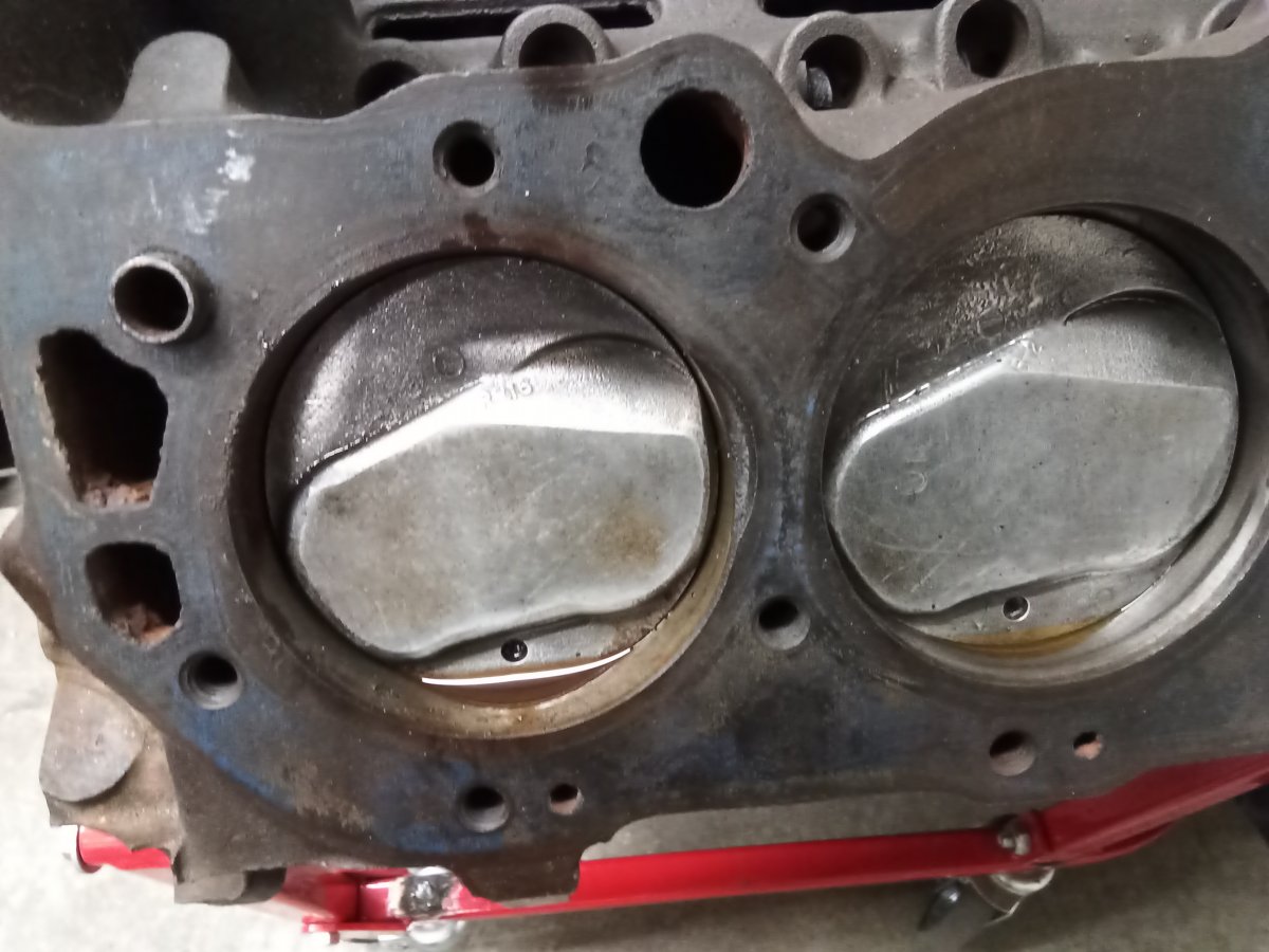

    4.094" is stock bore, so it's likely that it's standard size.
    What clues tell you it's a 375 hp engine? The stamped code? 4 bolt mains? Doesn't have rectangular port heads, so that's not one.

    Did the 4 bolt 396 have Hi Perf cast in it on the side?

    I don't remember. My 2 bolt block has P*** cast on the top rear, I think.

    I had a buddy who had what he told me was a 396 block, it was bare, but had “hi Perf” cast in it(pretty sure that’s what it said). Just was curious

    there are various things cast in various places...I think many blocks say "HI PERF" "P***" in at least one place. but I think it has to do with which blocks use that particular mold...so the ends of the block will say several things, even though the block itself is only one of those things. Hard to explain....but what it means is, don't get too excited about a block just because it says "HI PERF" somewhere on it.

    It's a 2 bolt block. Whatever it checks out to be, I have a couple sets of heads to cover my build. I really thank you guys for all the help>

    My FM books shows 2240 as a 396 325/350 closed chamber.

    Also my 1966 SS 396 350 said HI Perf 2 bolt main engine
