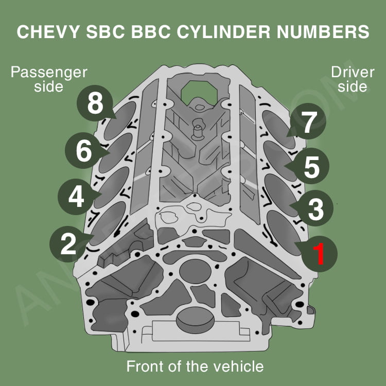

    350 Chevy motor has low compression on #5 left bank and 0 compression on #8 right bank. New rebuild less than 100mi. On engine. Heads have no cracks.valves are seating. Cylinder walls are smooth. Compression is good on all other cylinders. All parts are new. What could be the cause? Thanks trucke

    I was wrong it's #5 and # 8 my screw up. Trucke

    you should probably edit your first post to correct this info as many people will not read these responses as a linear conversation, and simply reply to your first post with it being 4 and 6.
