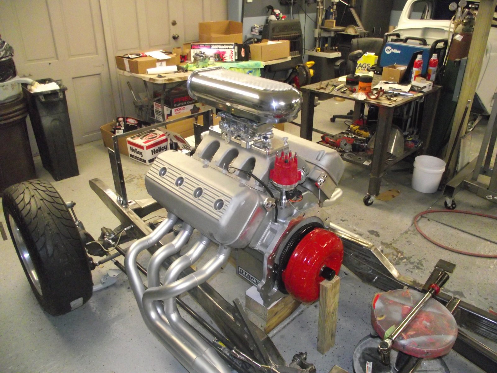

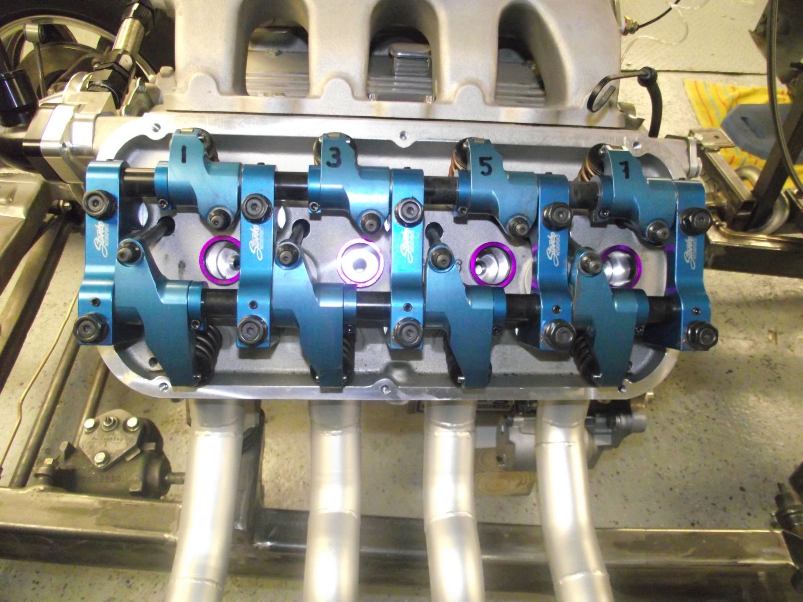

  19. coop46
    Joined: Sep 5, 2010
    Posts: 128
    coop46
    from New Jersey
    Some pictures for interest

  21. Oneball
    Joined: Jul 30, 2023
    Posts: 1,703
    Oneball
    Have you got an oil pressure gauge connected up so you can confirm you’ve got oil pressure?
    Did you notice a change in resistance when spinning the oil pump?
    Looking at an oil feed diagram your Hemi feeds oil from the 2 and 4 cam journals. It’ll only feed at a specific point in the cam rotation when the hole in the cam line up with the port to the head. See photo below.
    If you can’t find the exact crank position that works then once you know you’ve got oil pressure get someone to turn the crank slowly whilst you operate the drill. You’ll need two whole crank rotations to get one cam rotation.
    Just noticed Tommy explained all that above.
