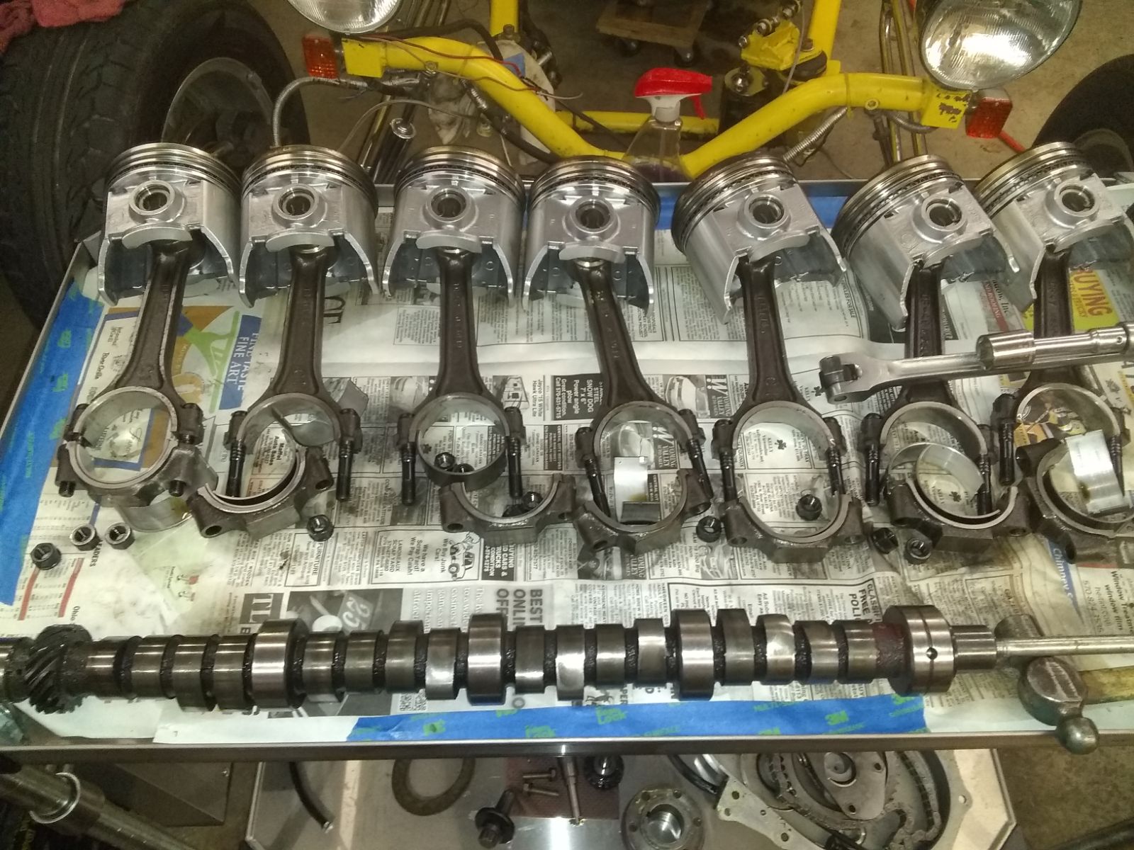

    Ok, just as I expected to see upon dis***embly. A wiped-out cam and lifters. Lots of metal bits. So, complete tear down and off the machine shop. I am trying to ID this block. The number I get off the top is AB 161929 - 2 D26 W.
    Can anyone give me any info with that information? thank you!

    You know that more SBCs than any other engine have been blown up racing?
    You know that one of the concerns with a cam/lifter failure is the diameter of the lifter and that SBCs are smaller than a hemi? Early hemis don't require as much lift and duration as a SBC either. 300X500 is a BIG hemi street cam.
    If the rest of the parts are fully cleaned and inspected, and a new cam, lifters, damaged parts (rings? oil pump?) and a gasket set are acquired, you will be ahead of the game. Fresh SBC long blocks are no longer under 2K unless you s****e the bargain sites. The lowest price available from Summit is 2121 for the VRE-DCM5. Every one less than that is not available now. That does not include intake, carb, WP, Alt, belt drive, exhaust and tins. Yes, you can source many different parts used, but the hemi is just re***emble.
    I joked earlier that if you didn't have the experience and liked SBCs, just do that. You have all these HAMBers helping you and guiding you with this project. Can you really put together a fresh SBC for less, air cleaner to oil pan, fan to converter? Not some good used but fully ready to go deal? Price both options out, down to the radiator hoses, fuel lines and chemicals.
