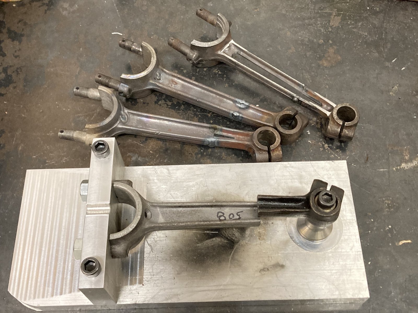

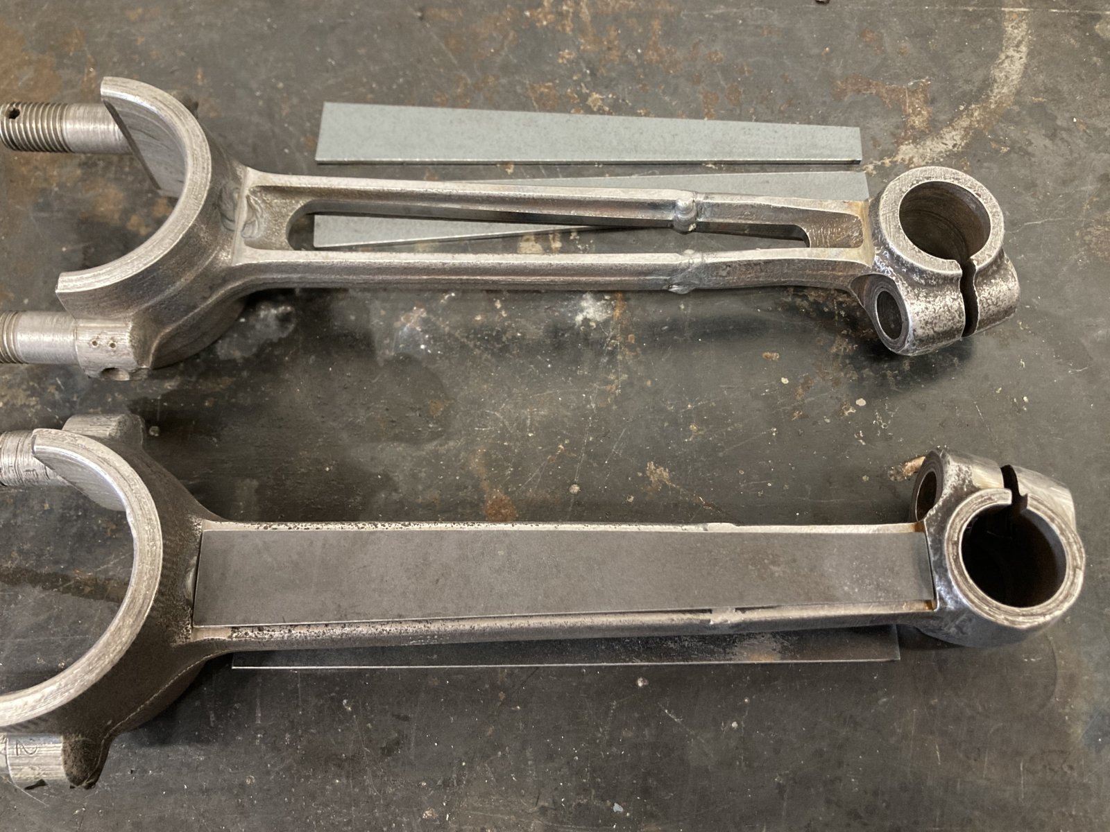

    Find the donor rod ends you want, graft em together, and run the hell out of em! They did it back in the day, and it works great for a relatively low power engine. Here are some pics of a set of A big end T small end rods cut to length and boxed to fit in a T with A crank
    EC951982-F0C9-4469-8AF8-DA36C478A3AA.jpeg 0FDA9014-28F4-477E-84F8-ECF74ECBA8ED.jpeg 7231BF04-3732-4BA1-982D-3827FCF21CFE.jpeg
    metalhead140, GuyW, XXL__ and 7 others like this.

    This might be the answer @Kevin Pharis, just have to find the right size rods & someone who is brave enough to weld them up! :D a question, it looks like you removed the web before welding them up? I guess removing stress raisers is the key with the removed material? Have you photo's of the finished item?
