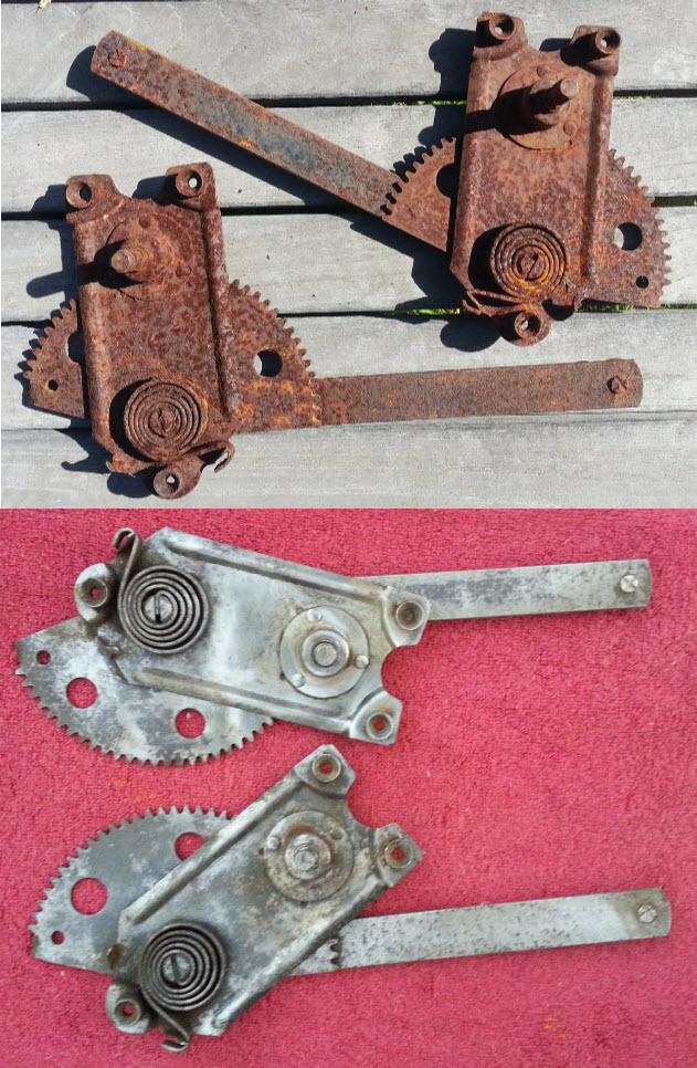

    I have a 2 gallon bucket (8:1 water:molassess) that has been going for several years. I buy 5 gallons buckets of it from feed stores for less than a gallon of tradition rust eater. IT WORKS! Leave parts in for about 2 weeks, rinse off and the metal is shiney silver. You'll need to prime it or something similar to prevent flash rust quickly. I put a stuck pair of window regulators in and they work like new now.
