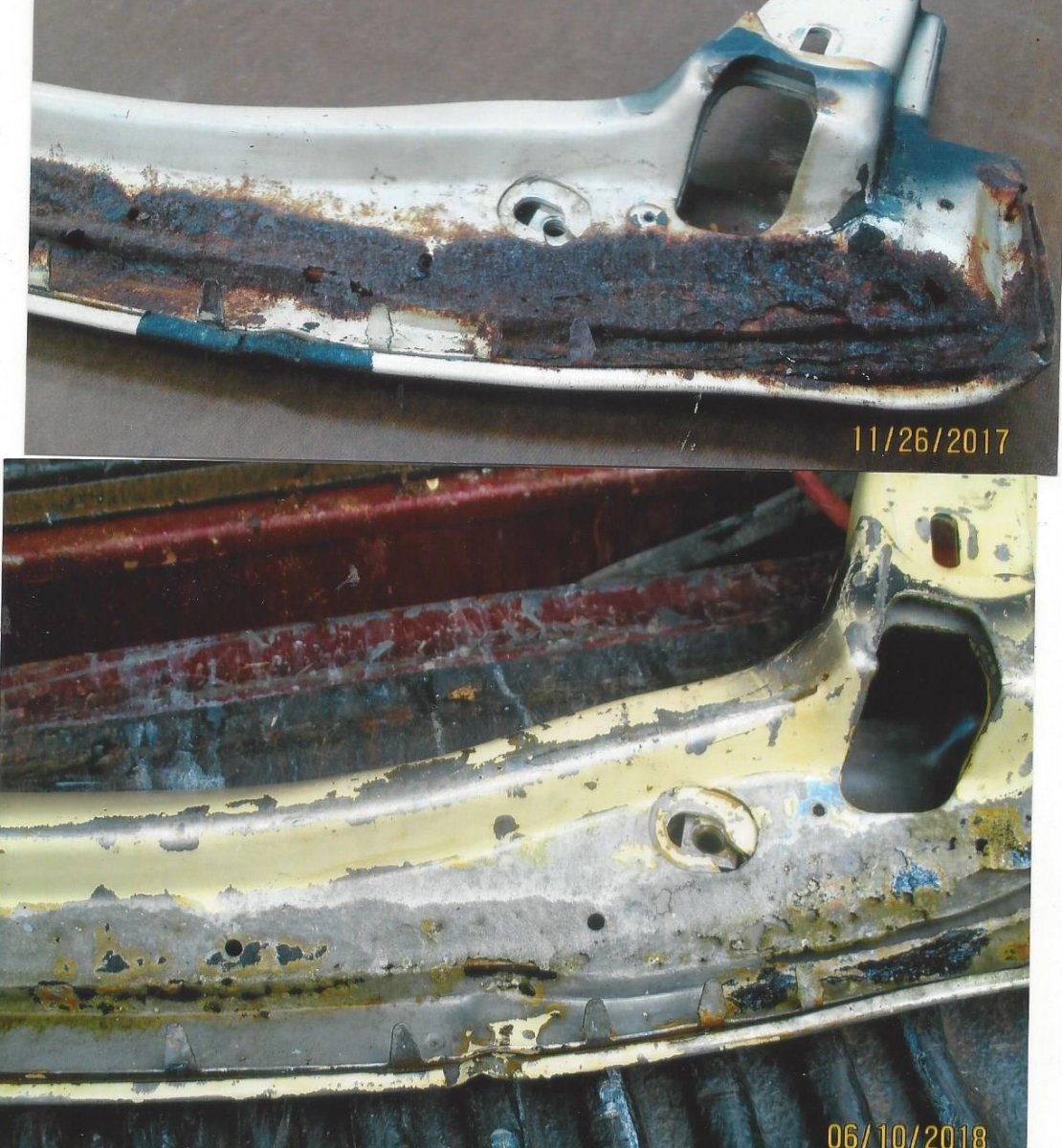

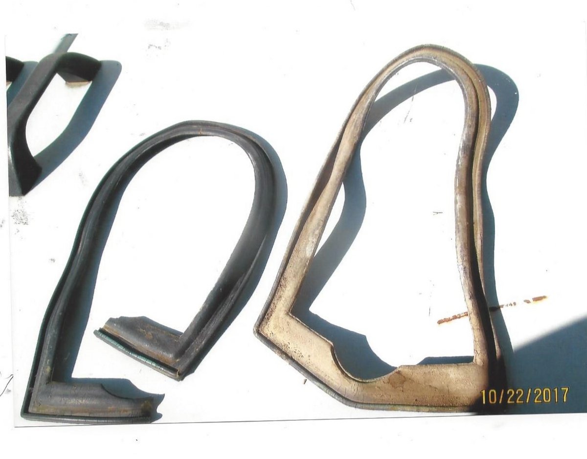

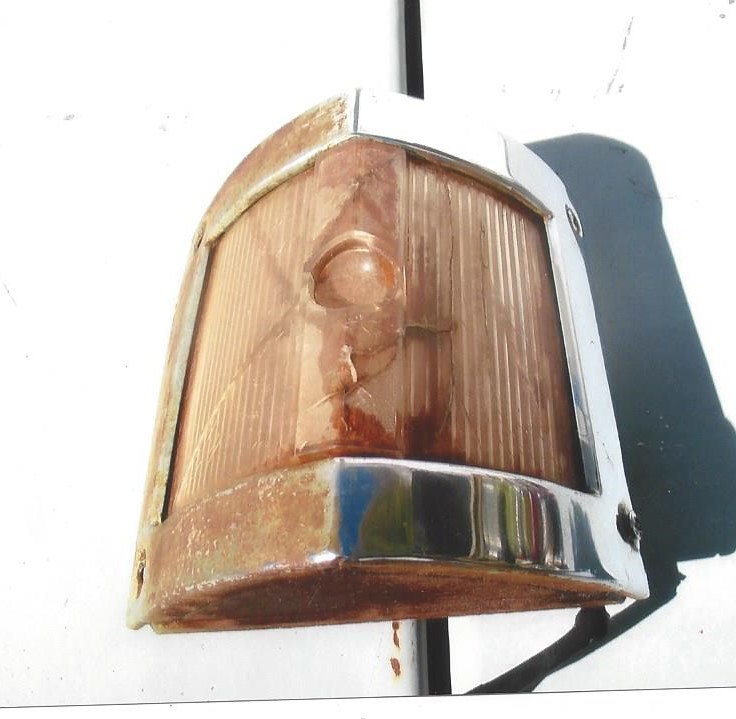

    Works for me. And doesn't stink. The second pic was rinsed off at the car wash and left to dry. And the metal was left untreated for 4 months. Scan0492.jpg Scan0784.jpg Scan0785.jpg

    ^^^^^ ? For light surface rust, this was in my tank for 15 minutes. Scan0491.jpg
