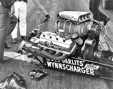

    I'm with everyone else on this, wall art. A ****tershield may contain things to a certain degree however the risks far outweigh the gains IMHO.
    upload_2018-6-21_12-47-29.jpeg [​IMG][​IMG]
