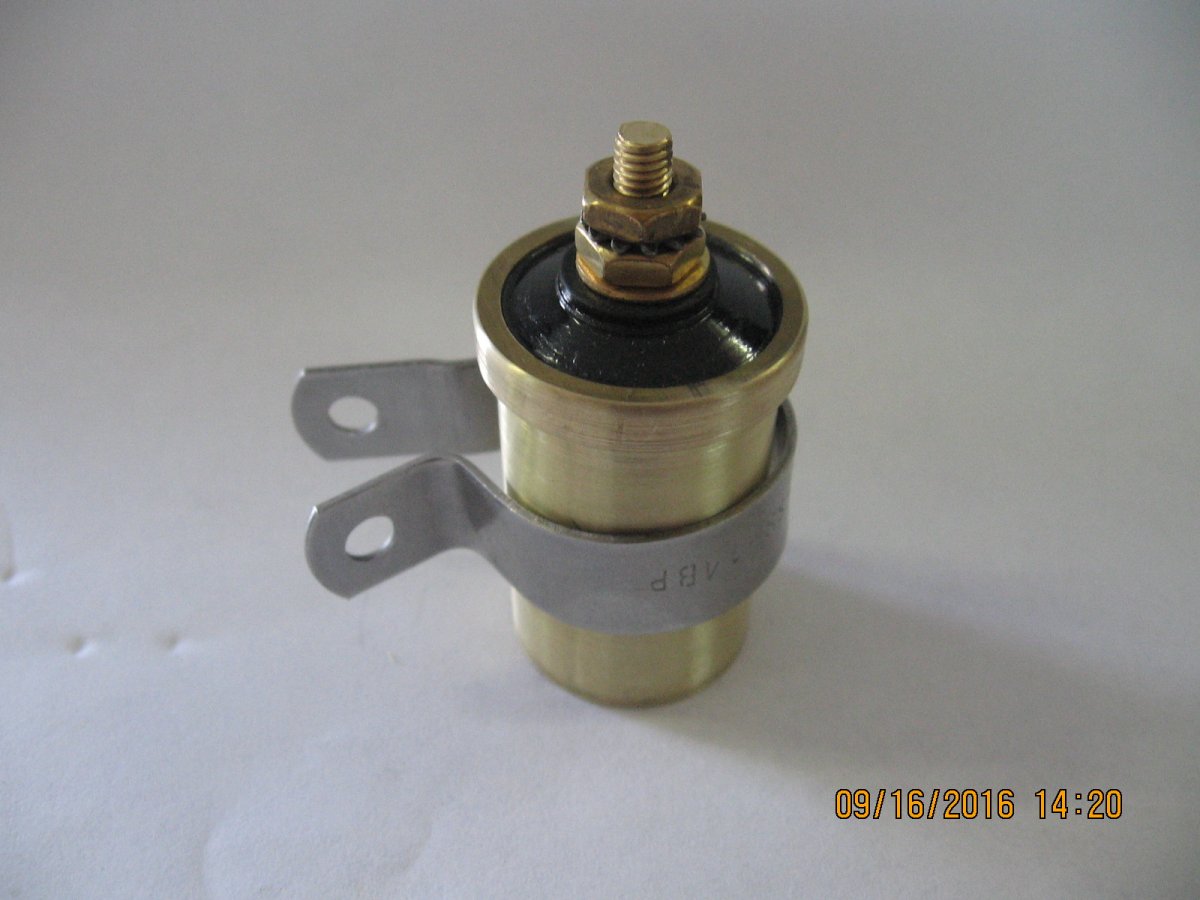

    Are you running one of the large br*** Mallory condensers that originally came with these units, or a regular automotive condenser? (I ***ume it is mounted on the outside of the distributor, as the second set of points takes up the space where the condenser "lives" in a conventional distributor.) You should be aware that the original Mallory condensers are 360 nano-farads while a standard automotive condenser is usually in the low to mid 200 nano-farad range. As a practical matter, I have found this makes no difference on condenser life, though it might affect point life. It's probably just a matter of inferior foreign made condensers. Next time, try to go to NAPA and try to find a Standard Auto Parts unit. They are usually better quality than something you would get at O'Reilly's etc.
    Or you could try to find an original Mallory, though they are getting harder and harder to find lately. Because of this, I am making reproduction units by packaging a modern severe duty film condenser in a large br*** case. ( I think they look neater, too!:cool:)
