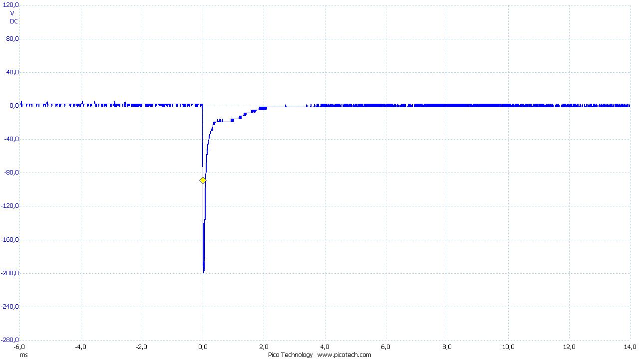

    Here's the spike from the coil in a ordinary 12V relay. It dissipates in about 2 milliseconds total (one full division is 2ms), the rise time from zero to the -200V peak (well, the bottom as it's a negative voltage, but you get the idea) is a fraction of that time, and that's the voltage rise the switch movement would have to keep up with. They just can't move fast enough, as they start with zero opening the voltage needed to start a spark there is also very low, you can't outrun the train if it already ran you over before you started moving.
    The hump you can see halfway through the spike is avtually caused by the mechanical movement inside the relay, as the coil has released the contacts. Says a little about how slow the contacts in a relay moves, at least slow as electricity sees it.

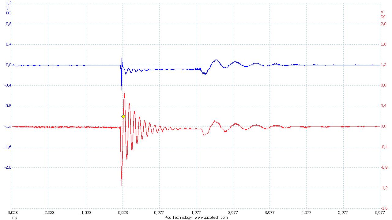

    Here's the oscilloscope result from some playing around with an improvised points ignition (an ignition coil, condenser and regular switch hooked to a 12V power source on a work bench). The red trace is primary voltage, blue is secondary.
    The strong oscillations lasting a couple of milliseconds from the start of the spark is a resonance between the condensers capacitiance, and the coils inductance, the frequency is a result of their size in relation to each other.
    In my electronic ignition also used for bench tests doesn't get those oscillations from the start, as there's basically no capacitance in it. The weaker, lower frequency after the spark has died it more or less the same in both systems, that's the last remaining energy in the coil that wasn't enough to keep the spark alive.
    Just to mention something that goes on in there, that we rarely need to know anything about.

    You're right, we don't need to know some of this, but some of us appreciate a deeper understanding of what's going on.
    So, this this graph, at what point is the opening of the contacts?
  14. G-son
    Joined: Dec 19, 2012
    Posts: 1,503
    G-son
    from Sweden
    The switch open where the red trace starts going steep down. Looks like the switch closed just ~1.2 ms before that, not much time to charge the coil that test, but that's the joy of improvised test setups on the bench and a storage oscilloscope hooked to them, you get proof of what you messed up, easy to view and save so everyone can se what you did wrong. :rolleyes:

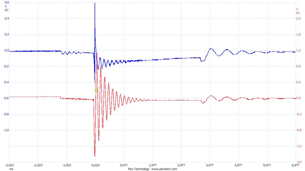

    So the slight drop in voltage starting about -1.1ms before that, what's that from?

    Well, I was thinking that was the point when the switch closed, but that should go up then... Been a while since I did this test so i don't remember the details. Now I'm thinking the switch I used for the test didn't break the current abruptly quite as it should, the voltage drop could be from a change in resistance through the switch before the final break perhaps. There were other times I did not get that voltage drop there, like this.
