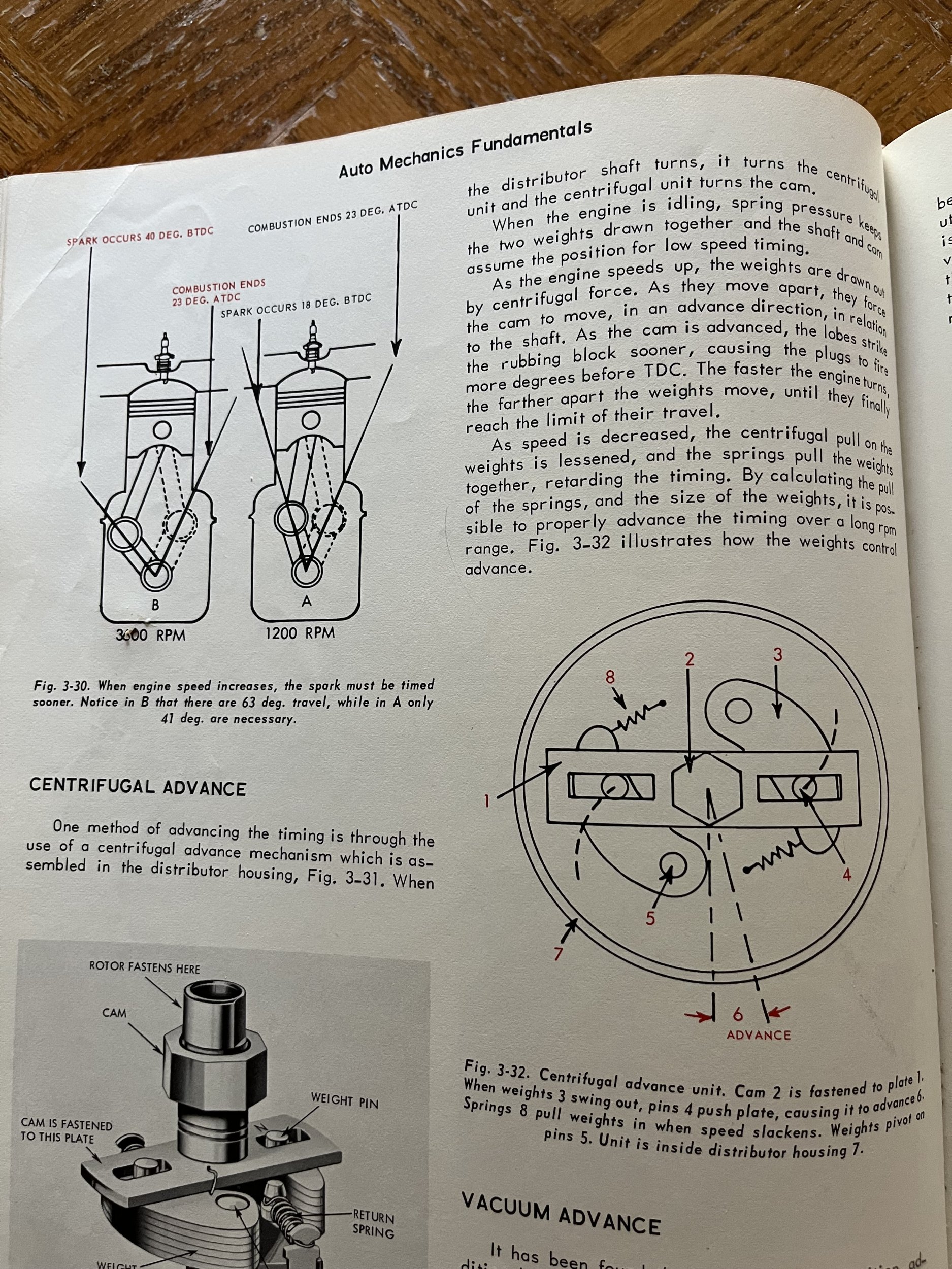

    Because of time and crank angle.
    Most spark ignited engines operate at varying speeds and loads, so the timing must also be variable. This is to keep peak pressure of the combustion process centered on the ideal crank angle for optimal power output. It's a moving target.
    Engines that operate under a constant rpm and load may have their timing locked out, but this is for simplicity and reliability.
