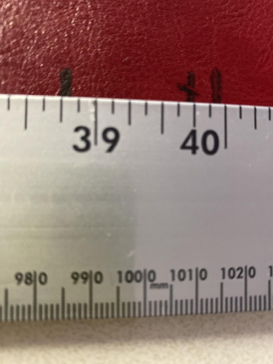

    Sent from my iPhone using H.A.M.B. fooled around last night sewing some. The ruler got weird on me so I went to bed. But I did figure out how the bobbin works and a few other things. Gonna start watching my lucky needle videos and go from there.[​IMG]
