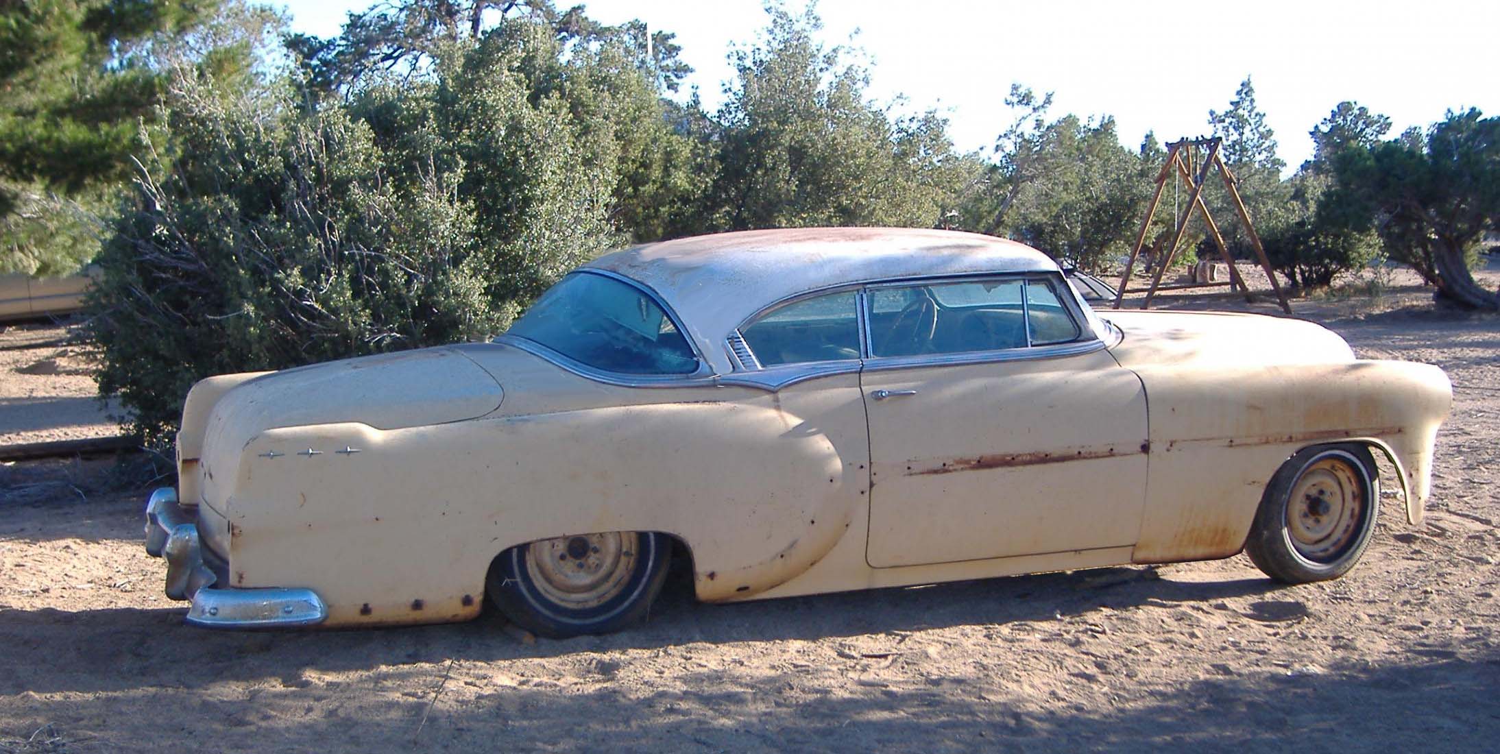

Customs contemplating "FREE" 54' pontiac chop

    I'll go with NO CHOP

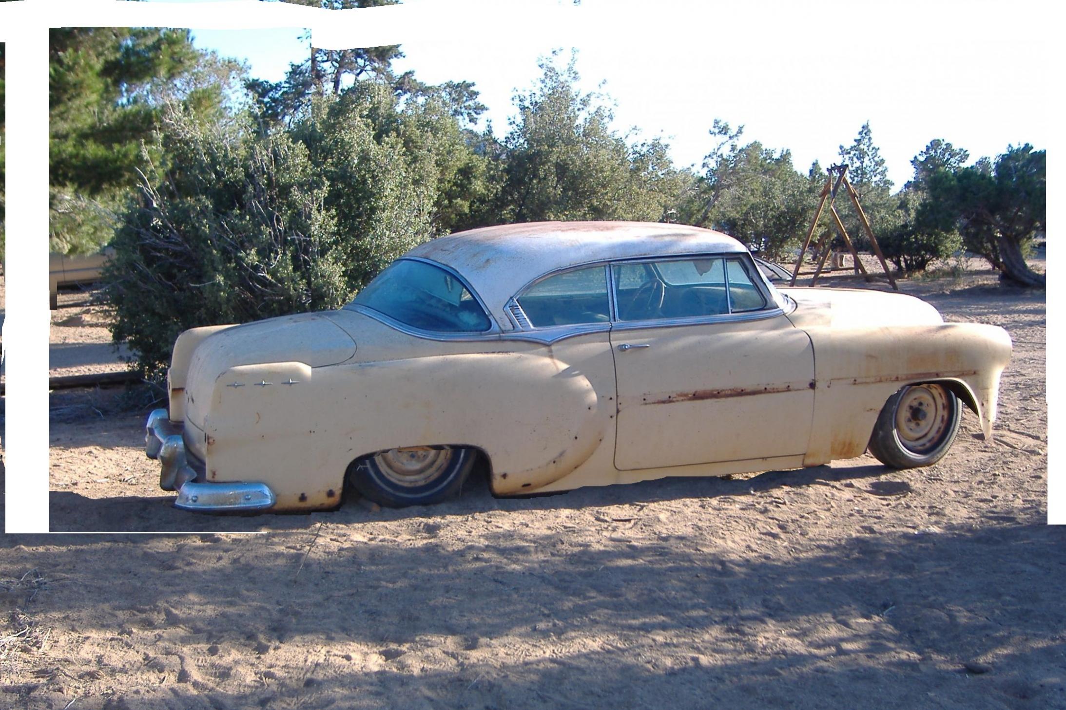

    lowered with a real quick(and ****py!) chop...the back window on here is f***'d but u get the idea

    I vote no chop as well. I don't think it will look right with a chop. Just lower it and it should look good.

    Got to agree with everyone else on this one. Simple chopping (now THERE is an oxy*****) would shorten the side window height and screw up the not only the top's proportion, but the proportions of the entire car.
    If you're really determined to do something with the top, taking the crown out of the roof sheetmetal could give you what you're looking for, and provide the side benefit of allowing all the gl*** to remain stock. Of course you better have a fair understanding of the top's structural engineering, and have your metal working chops down to pull it off.

    thank you everybody for your responses, i kinda had thought that the roof already looked pretty low as well. Im a fabricator so its hard to resist chopping but that sure saves me alot more work and headache. thanks for the input all.

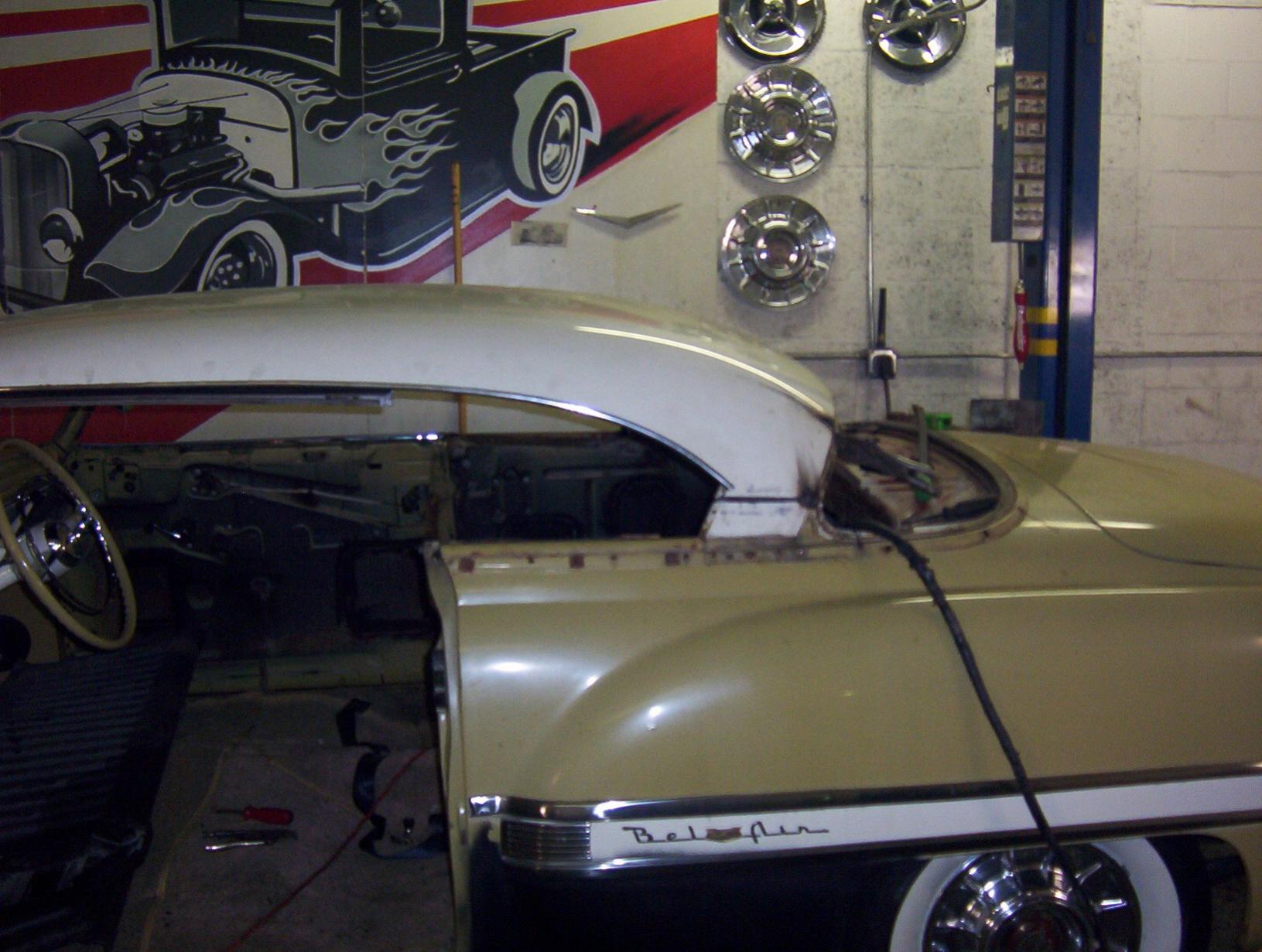

    im going against the grain here. i would chop it 3 inches, and make a lexan backgl***. just like the moonglow. it would be very unique, and i dont think it would look squashed.. its actually a very easy chop. heres a chevy i did. i know its a longer differant car but still the same vibe. colors are close too..

    now see that chevy chop (above) is exactly what i was talking about. I dont think a couple inches would make it looked squashed. It is a very easy chop to do with the a pillar and b pillar at almost the same angle and it could be done with no splitting side to side or lengthwise. This is not my first chop and i know what people are saying in regards to it looking squashed but mercs are long to and they are one of the most popularly chopped cars. Either way im going to get it on the road prior to turning it into MORE of a project. I do appreciate all the input.

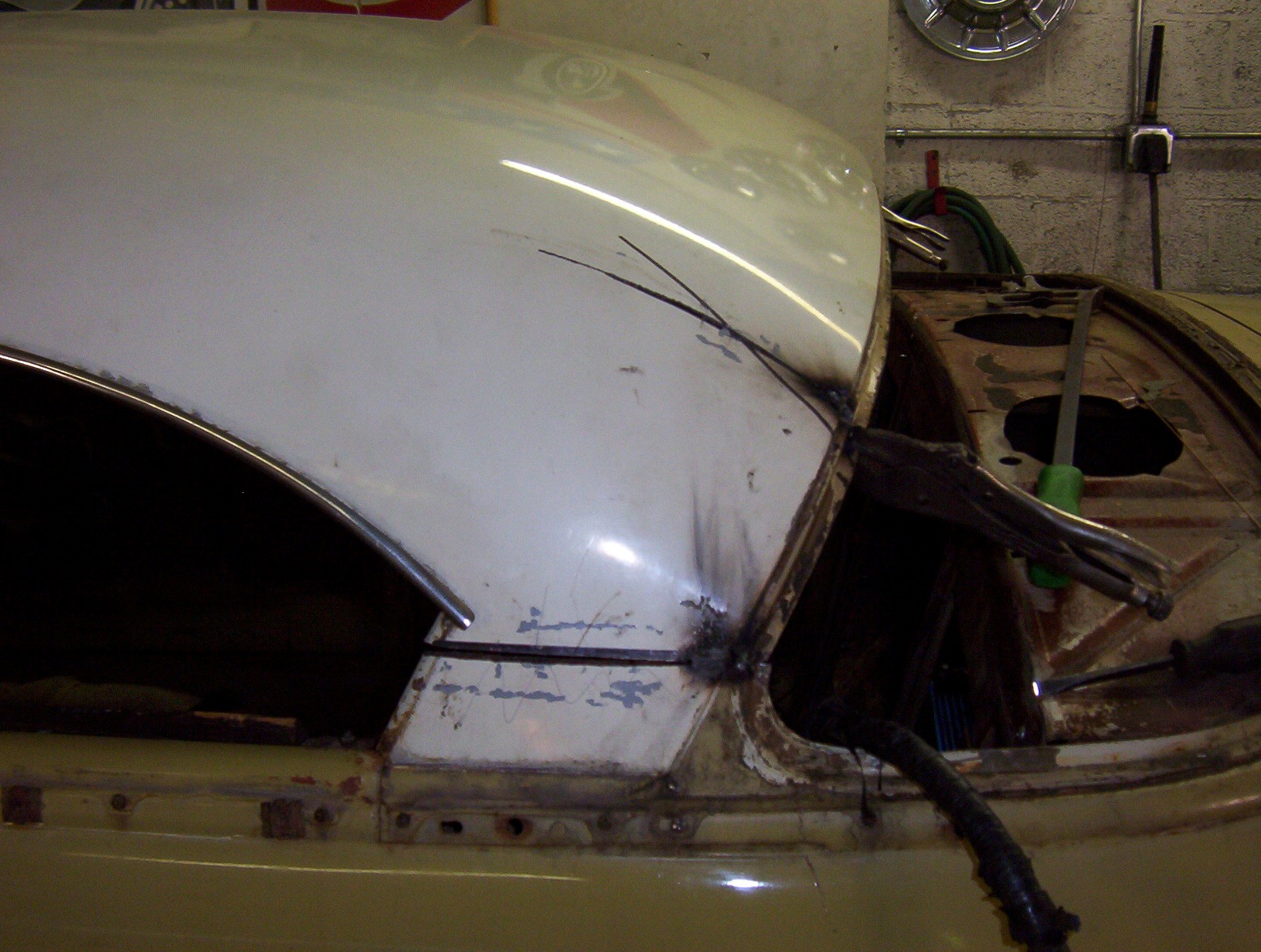

    my question was actually more about peoples opinions on the "proper" way to chop a car like this. I have heard of supporting it by tacking in supports but then i have also heard that as long as the doors stay on and closed that the gaps stay fine.

    i just tacked the doors shut at the top and it was fine..
    and you will have to make a couple 12" splits at the back.. good luck
