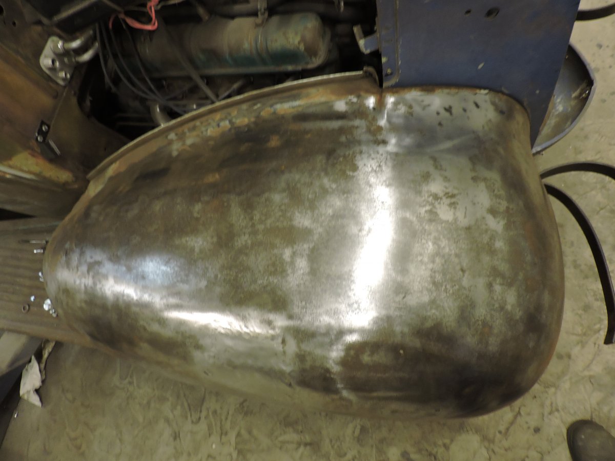

    004.JPG 006.JPG I bought one a while back haven't used it much yet. I did try it on one of my fenders and was pleased with the result

  2. Some folks like myself don’t like using course grits like that to clean metal.
    This is why I’m curious if this tool works close to how it’s advertised.
  3. gimpyshotrods
    Joined: May 20, 2009
    Posts: 24,516
    gimpyshotrods
    19-gauge, worse, 18-gauge, and even worse 20-gauge (like on an early Falcon), gets really thin when you go at it with 36.
    I won't use anything lower than 80 to clean metal. I have more than enough time to move around to prevent warping, than I have time to repair metal damaged I caused.

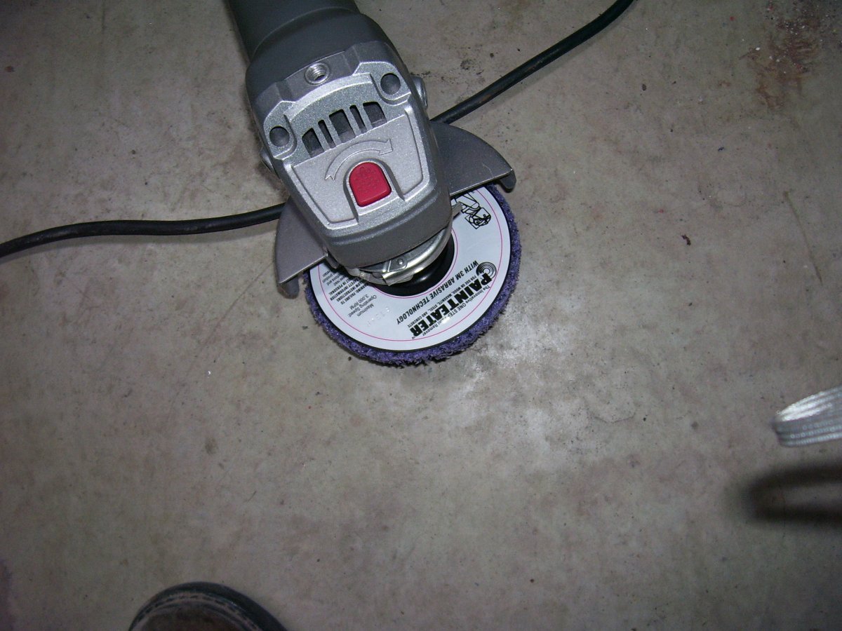

    Much cheaper and does a great job, Painteater made by Wagner (around $13-15 at most hardware stores or Menards). It's a fiber wheel that screws onto your 4.5" angle grinder. Just screw it on by hand and when it stops threading you are ready to go, no reason to force it to go further. The purple ones are the best but they have been replaced by the black ones.
    They remove paint quickly and work great on surface rust. Took 1 pad to do the box side on my unibody (took about 30 minutes to remove original paint, 2 coats of primer and a newer paint job) and to clean up a bunch of small stuff. Did both inner fenders with one pad. Took another pad to do both doors and about half the roof skin.
    Work great and leave a nice tooth for primer or putty work.

    That Wagner Paint Eater pad is rated for 3000 rpm. How fast is your grinder spinning?
  7. LM14
    Joined: Dec 18, 2009
    Posts: 1,936
    LM14
    from Iowa
    Probably 11,000. I have been thru bout 20 discs in the last 5 years and never had a single problem.
    SPark
  8. gimpyshotrods
    Posts: 24,516
    gimpyshotrods
    147mph. That is how fast the pieces will be going, if they come off.
