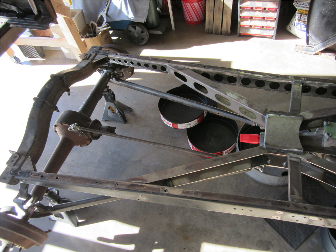

    It looks like the way those are installed will cause the rear suspension to bind. The top bar pivot point should be on the same line as the front radius rod mount. Try disconnecting the spring and move the rear end up and down and see what happens.
  15. alchemy
    Joined: Sep 27, 2002
    Posts: 22,683
    alchemy
    Yeah, Glen you just made a rigid truss. If the lower rear had flex at the rear connections it would be a four bar type suspension, but your solid rear wishbone connections make it not bouncable.

    And some of the pics. I used the end of a Model T front axle along with a Model A wishbone to make the torque arm. This tied into the front of the rear "wishbone" that was made up of modified 36 rear forgings, 40 front wishbone tubes (because they are heavier wall) and a Model A wishbone yoke.
    Here's a shot of the ch***is upside down...

    STRESS?
    Are those bolts on the Banjo Center strong enough to handle the stress?
  20. Different bolts then stock and that was the setup with the 4 cylinder. Just using it as a reference for a torque arm. The V8 setup is different.

    I wonder if there would be any warpage if you welded the torque arm bracket to the side or top of the banjo case?
