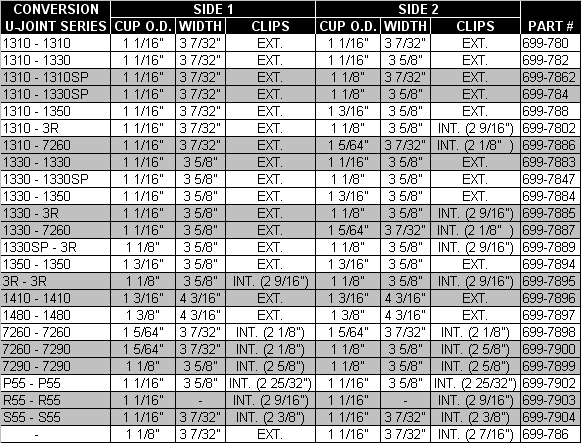

    Is there a chart that exists, that shows conversion joints and their sizes? I have an S-10 shaft, that i was discussing shortening myself in my truck thread, so I picked up 2 joints for it, sadly the slip yoke I have isn't as wide, and the cups are smaller in diameter. The counter person at O'Reilly's isn't well versed in conversion joints lol...

    the chart tha oneball showed in post 3 works well if you know what u joints you are trying to match.

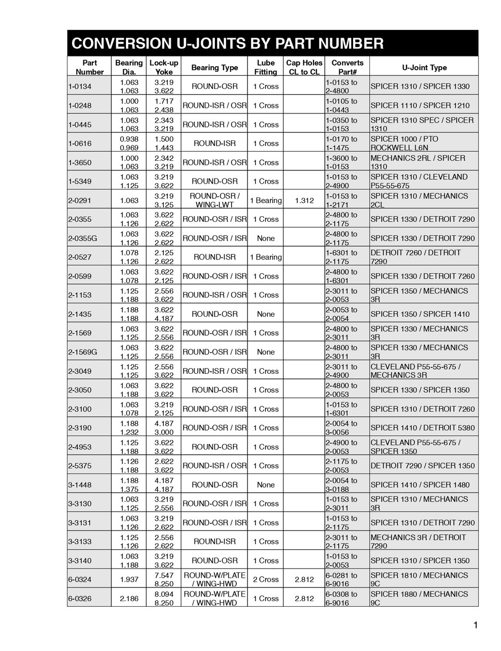

    i think this is the same info from spicer NEA-Ujoint_Dimensions_page-0007__27212.jpg

    That's good info! 3-3130 is what I need. Appreciate that :cool:

    i,m thinking that that is the back page out of the automotive section of the printed spicer catalog.
